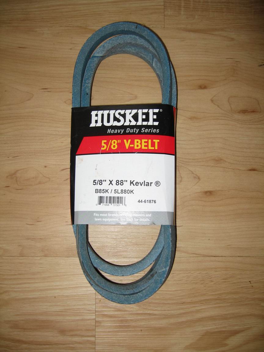

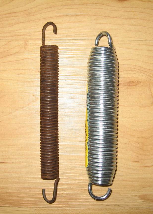

OK, I picked up both an aftermarket Kevlar belt and another CC OEM Kevlar belt. The aftermarket belt (from Tractor Supply) is shown in the photo below. This is the belt I'll be using to test the improved idler pully spring tension rather than risking the more expensive OEM belt. If the aftermarket belt works with the new idler pully spring, I might just keep using it instead of swapping-out for CC belt. In the other photo attached below, the new spring for the idler pulley is on the right . The original OEM spring is on the left.
I'll be installing everything later today and will post pictures once installed.

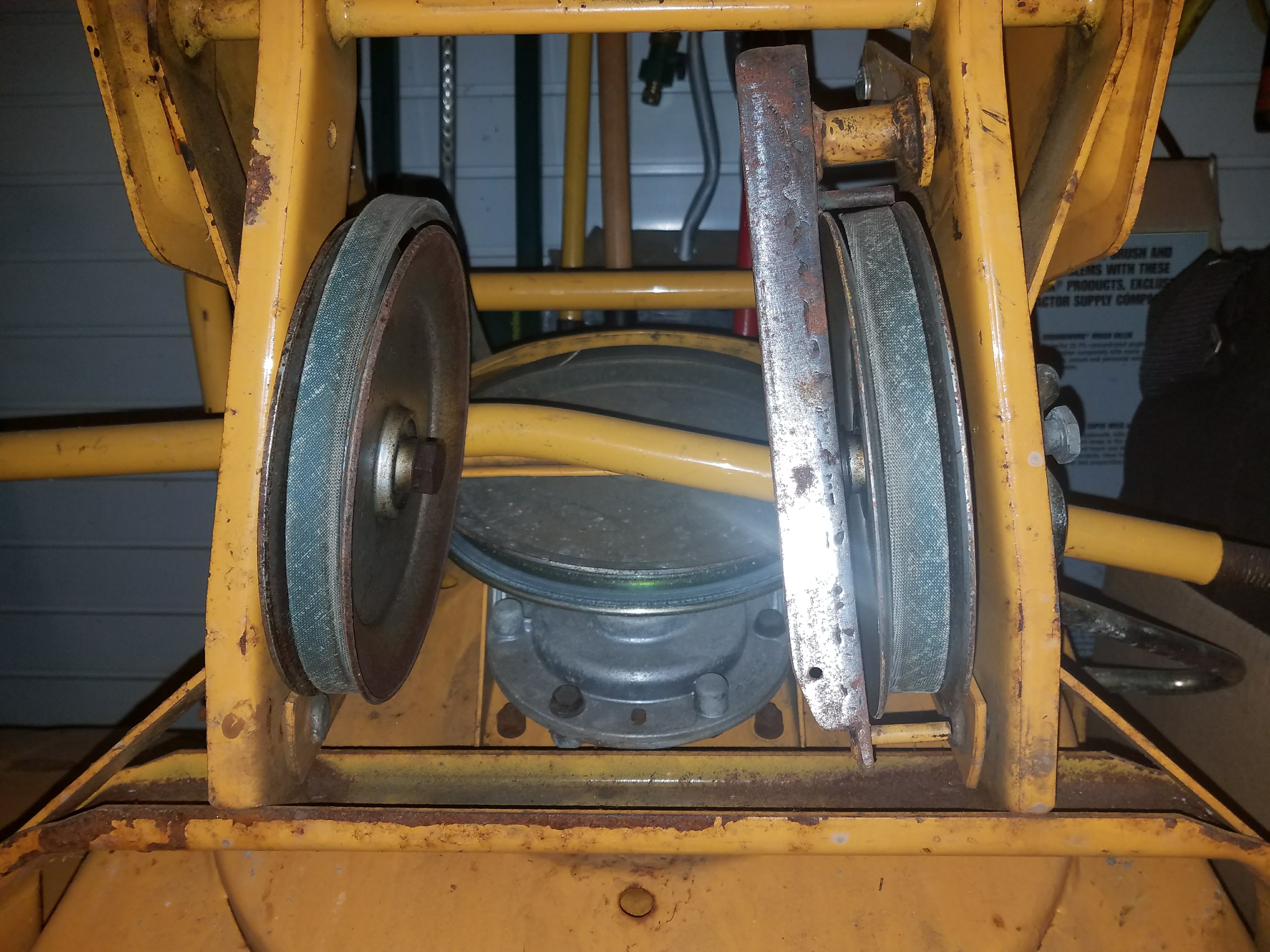

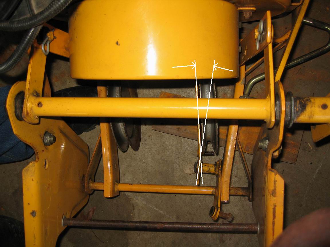

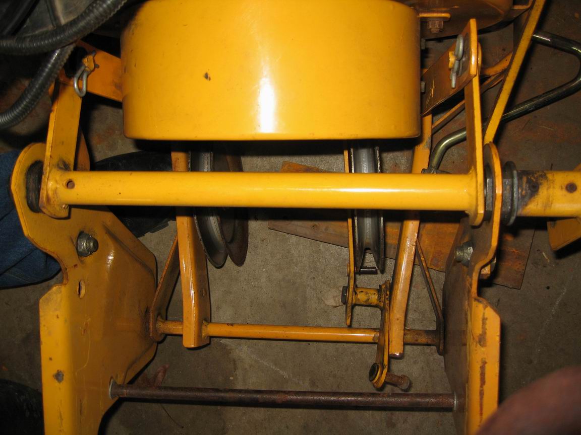

Well, I found part of the problem: sometime this season (probably when the first belt let go) the moveable idler pulley arm got bent -meaning that the pulley itself is no longer aligned with the main drive pulley on the blower. This is particularly important because there is only a short distance between It's bent about 1.25" board making it impossible for the belt to remain on the idler pulley with the PTO engaged. I couldn't see the misalignment with the blower on the tractor (which explains why I lost the second belt so quickly after replacing it -the blower was still on the tractor when I replaced the belt) and it only became apparent what the problem was after glancing at the blower from this perspective. This idler pulley swivels freely around its pivot bolt and can contact the ground without a belt on it. I remember the pulley getting pinched under the tractor when I lost the belt earlier this season and that's probably when the idler arm got bent (shame on me for not assuming an 800lb tractor MIGHT bend a 3/16" thick piece of metal -and conducting a more thorough inspection at that time). Regardless, this may make my theory about the idler pulley spring baseless, but I'll probably go ahead and install the heavier spring anyway. I guess it can't hurt at this point!

This was my 'fix' for this problem:

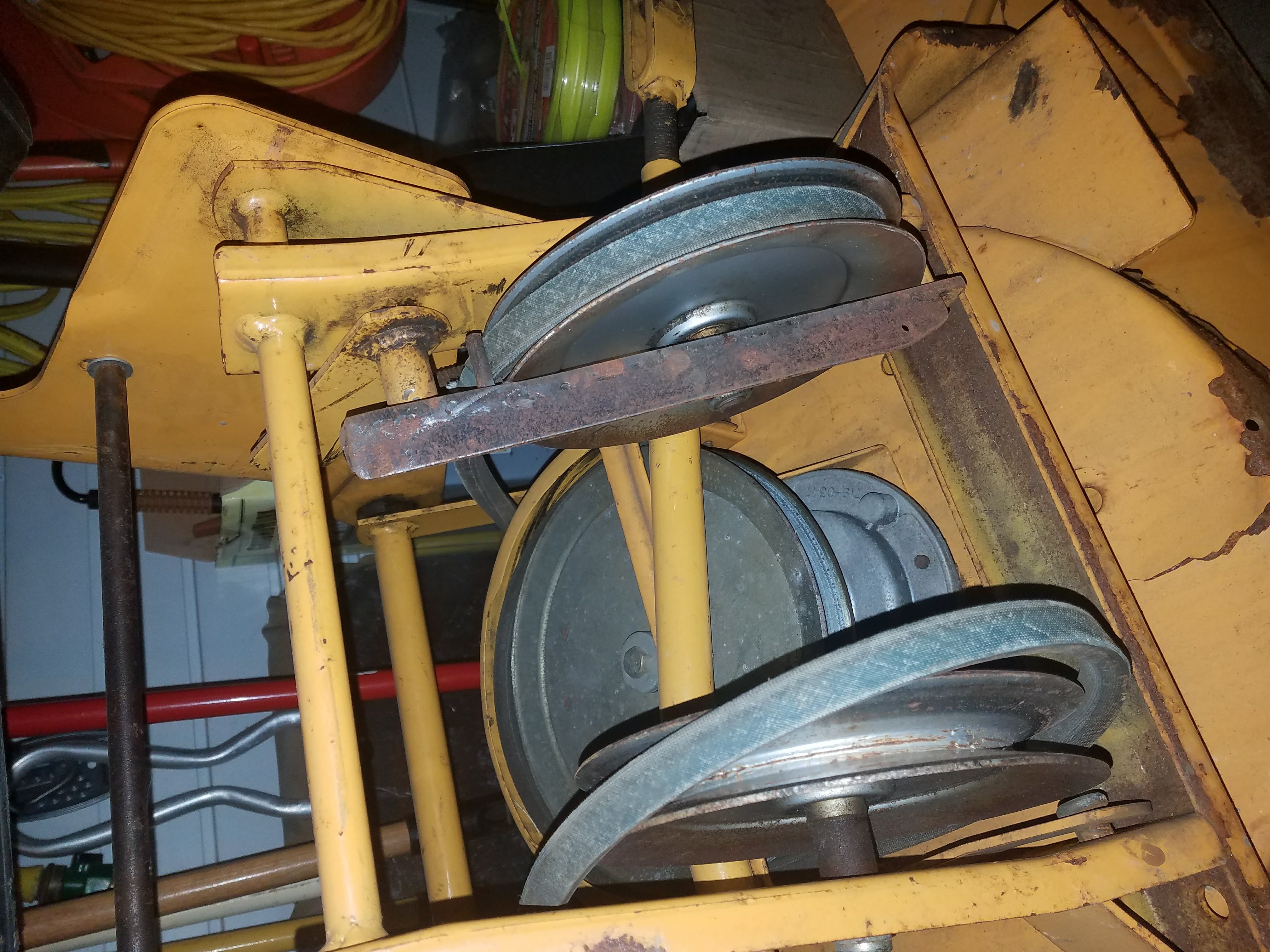

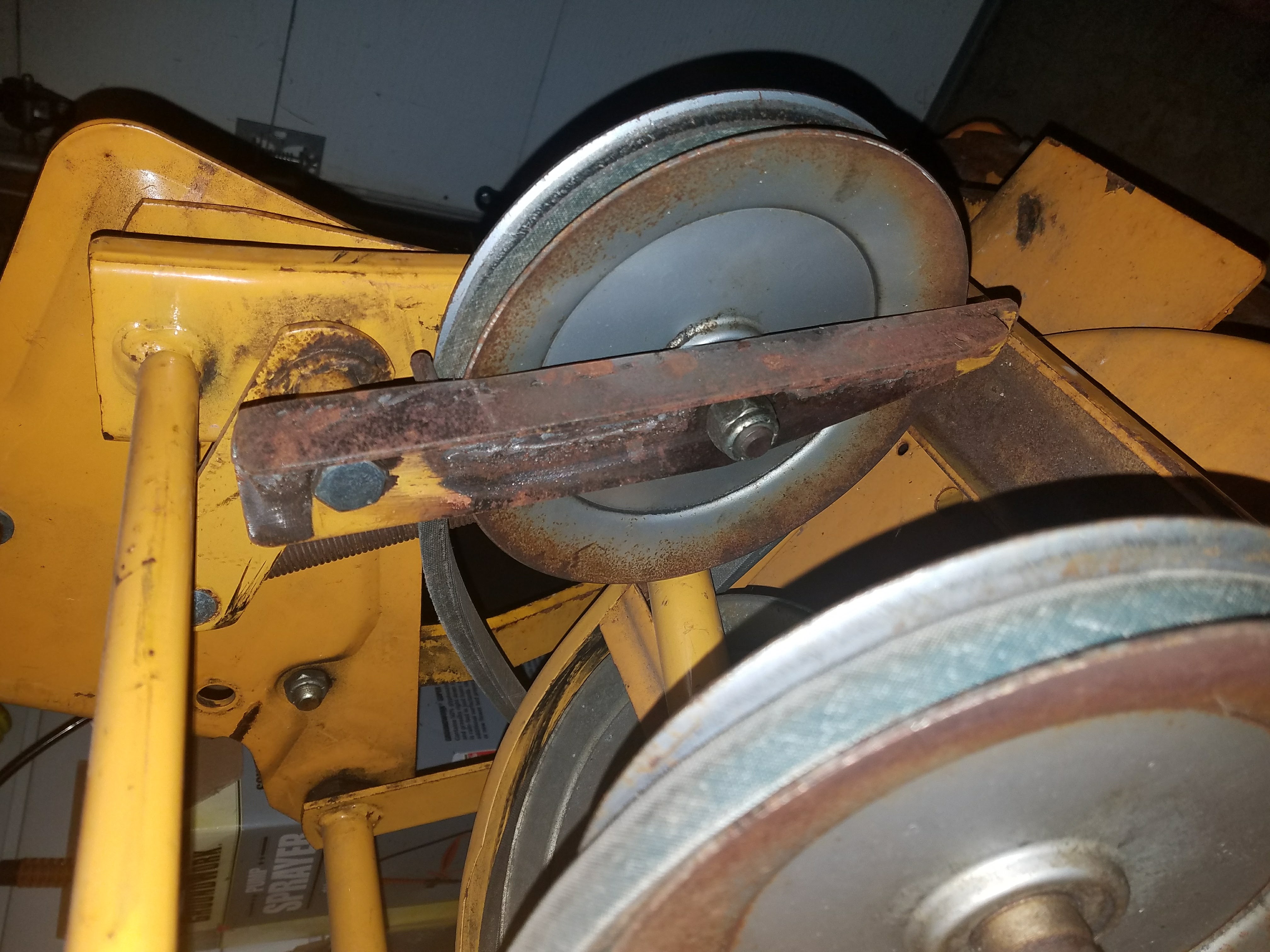

The root cause of my problem was indeed the bent idler pulley bracket. Knowing that this type of failure was likely to happen again over time, I welded a small length of angle iron to the idler pully arm to prevent it from bending again (even under the weight of the blower). That solved my problem.
