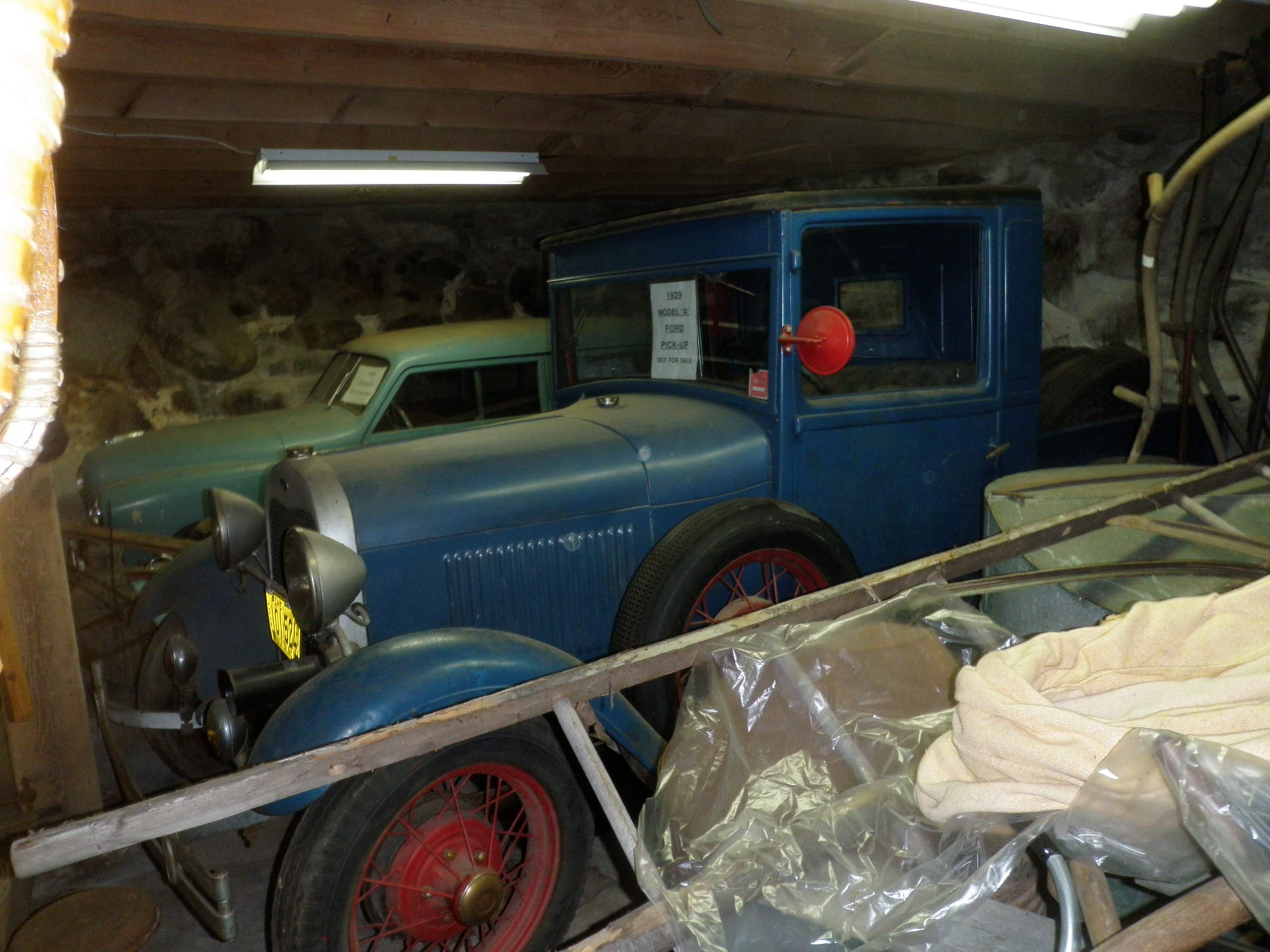

Not exactly tractor related but hopefully you guys can help. A family friend recently passed away and his wife is clearing out his life long collection. The one piece I remember from my childhood was his 1929 Model A pickup and how I had always wanted to own it. She wants me to have it and we need to decide what it is worth. They are very close friends and I want to pay her a fair price but niether one of us knows what it is worth. He bought it in the mid 60's. It was last registered in 1971 and has sat in the barn on blocks since 74. This truck is very complete. At some point before he bought it it had been repainted with a brush. I can't find any rust anywhere. One of the rear fenders was patched but it appears to have been from damage. The bed is amazing. If it hauled anything it must have been hay.The fenders and running boards have typical scrapes. The wood looks excellent, possibly replaced? The squirrels have chewed the seat all up. As far as mechanical, he drove it into the barn and parked it. The motor is free. The gas smells like varnish so I wouldn't dare try to start it until everything was cleaned and fluids changed. It needs the typical things that a truck that old would need, Tires, wiring?,seals...... She wants everything out of the barn soon so I will buy it as-is but we are close enough that if there was a problem we would work it out. Can anybody help me figure out what I should HONESTLY pay her?

As a long time restorer/restomder of vintage cars & trucks I can shed a little light in the ave. value, depending on condition 6 to 12K for un-restored but running & nice shape with at least 90% of all parts intact, newly restored approx 20 to 25K stock, not hot rodded or restomoded. I have a farmer friend that has 2 1930 fords in a shed that he wants to sell me at a good price, but I am working on my '59 Chevy right now and don't have the garage or barn space for another project right now, maybe next year.:laughing:
also they have upgraded the Kelly Blue Book prices to include vintage & classics now for average not show vehicles, so you may want to check one for yourself.

I would say between $4,000 to $5,000 range. 1929 Closed Cab Trucks tend to be at the lower end of the scale price wise.
The truck is not a stock 1929... at least the wheels are from a 30-31 as is the Front Bumper... the horn is aftermarket too... good originals are not cheap.
Costs a lot to restore one.. although pickups cost less because you don't have to deal with more expensive upholstery, etc.
Most any old barn find Model A can be made to run... they are very impressive that way.
Standard things to check would be to see if you can hand crank the engine to see if it is free or frozen... since it is not frozen... look for freeze damage to the block and head if straight water was left in the cooling system...
Drain and refill the fluids... Coolant, Motor Oil, Trans and Differential... there are many Zerk fittings to grease... just don't over grease the ones at each end of the rear axle because the extra grease will end up on the brake linings...
Don't forget gear oil for the steering gear box although some use grease because of the Zerk and the water pump especially needs grease front and rear.
I made a little Test Fuel tank from a peanut can... no sense trying to draw from the tank if it's bad... a word of caution.. the fuel we have in California will loosen everything in the tank... eventually, you will have a clean tank and might discover leaks too.
Original Carb Bowl comes apart with one bolt... later replacement tillotsons it is easier to loosen the two carb to intake bolts and then bench disassemble and clean...
Good practice is to squirt a little oil down each spark plug hole and let things soak a few days...
Burnish the points by sliding a business card between them... timing should be fine if the car was put away running.
6 volt battery POSITIVE ground... although you could get away starting with a 12v... lots of the guys run 12 volt systems with the 6 volt starter.
I've seen nice pickup go in the 10 to 14k range... most people underestimate what it costs to restore on. My pricing is based on California... your area could very well be more or less.
Good thing is almost every part you might need is available...
I'm a 37 year member of the Model A Ford Club and worked after school and summers at a Model A Parts House during my High School years...
Full Coverage Collector Insurance is cheap... typically less than a $100 a year with modest value through JC Taylor.
Lebaron Bonney has seats'upohostery kits that are very good...
Might also want to contact the local Model A Club in your area... lots of great resources always willing to help a fellow member...
Happy to help in any way I can...
PS... the engine could be what is commonly called a "B" engine which is a good thing. "B" engines had larger bearings, higher compression, more horsepower and some had counter weighted cranks... B engines do not have an external oil return tube outside block behind the carb... B engines do have a cast boss for a fuel pump...
