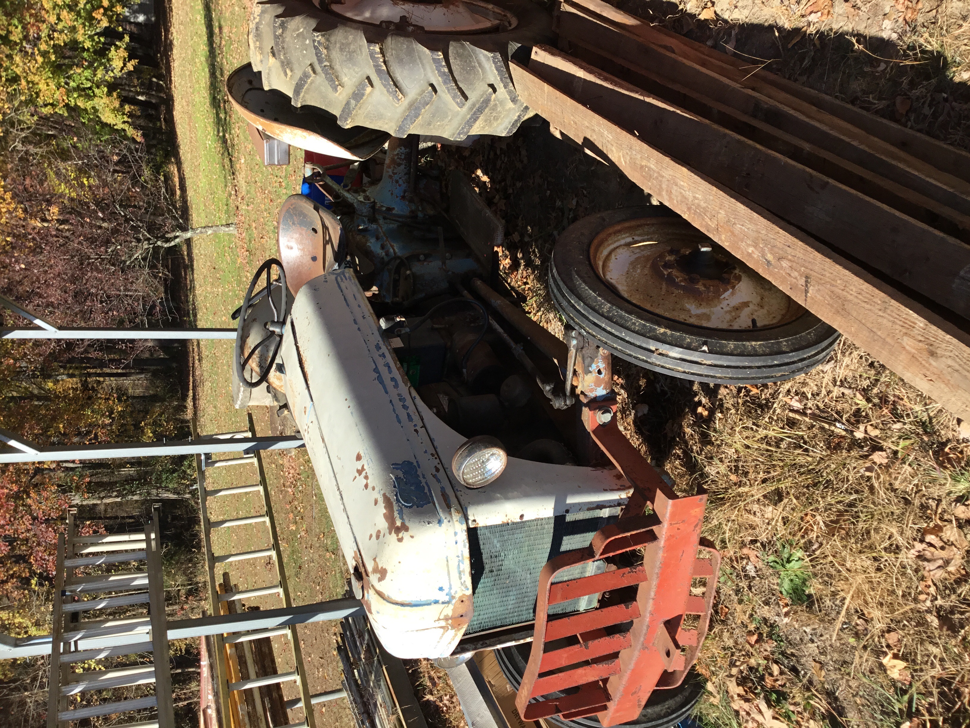

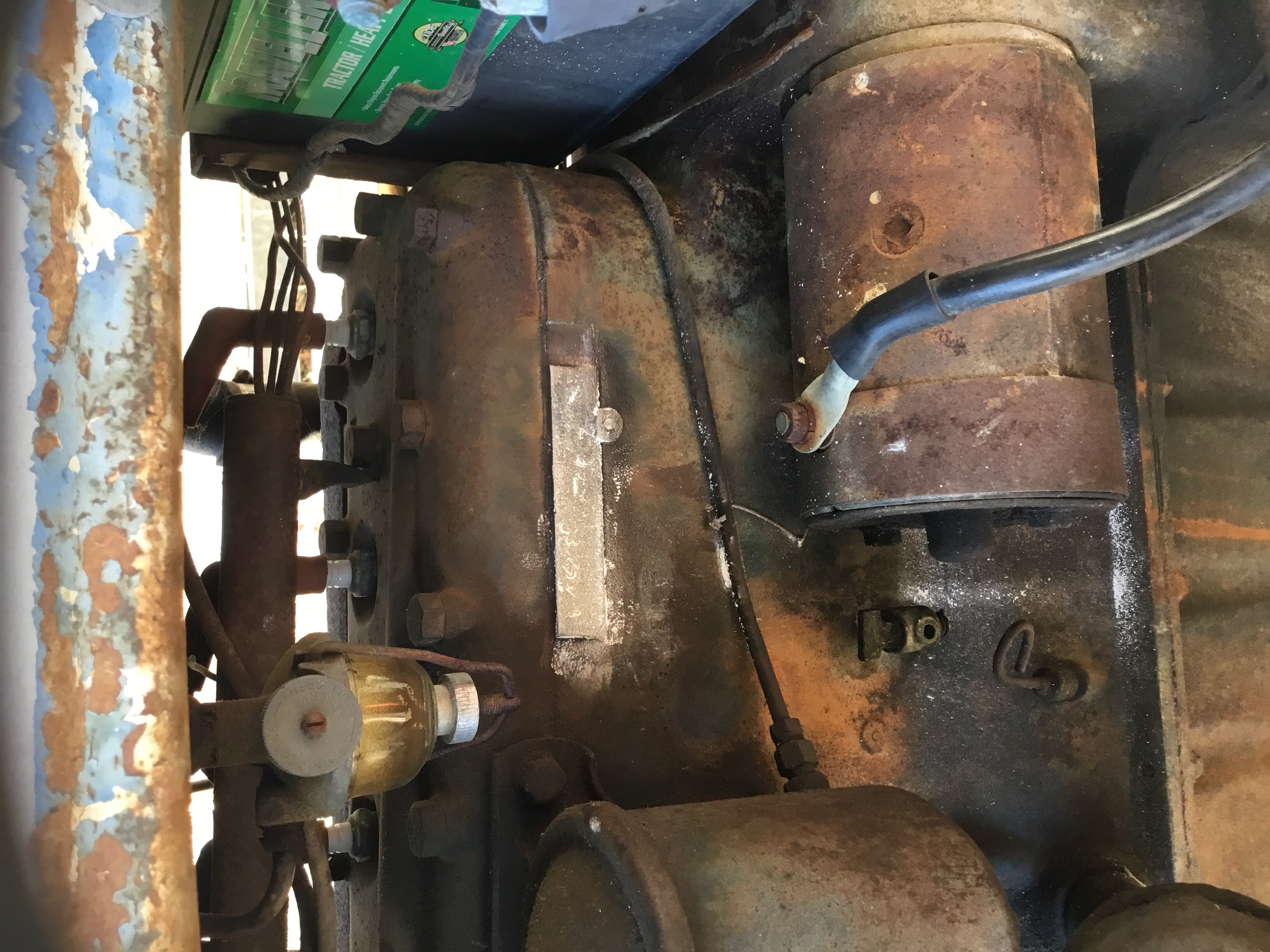

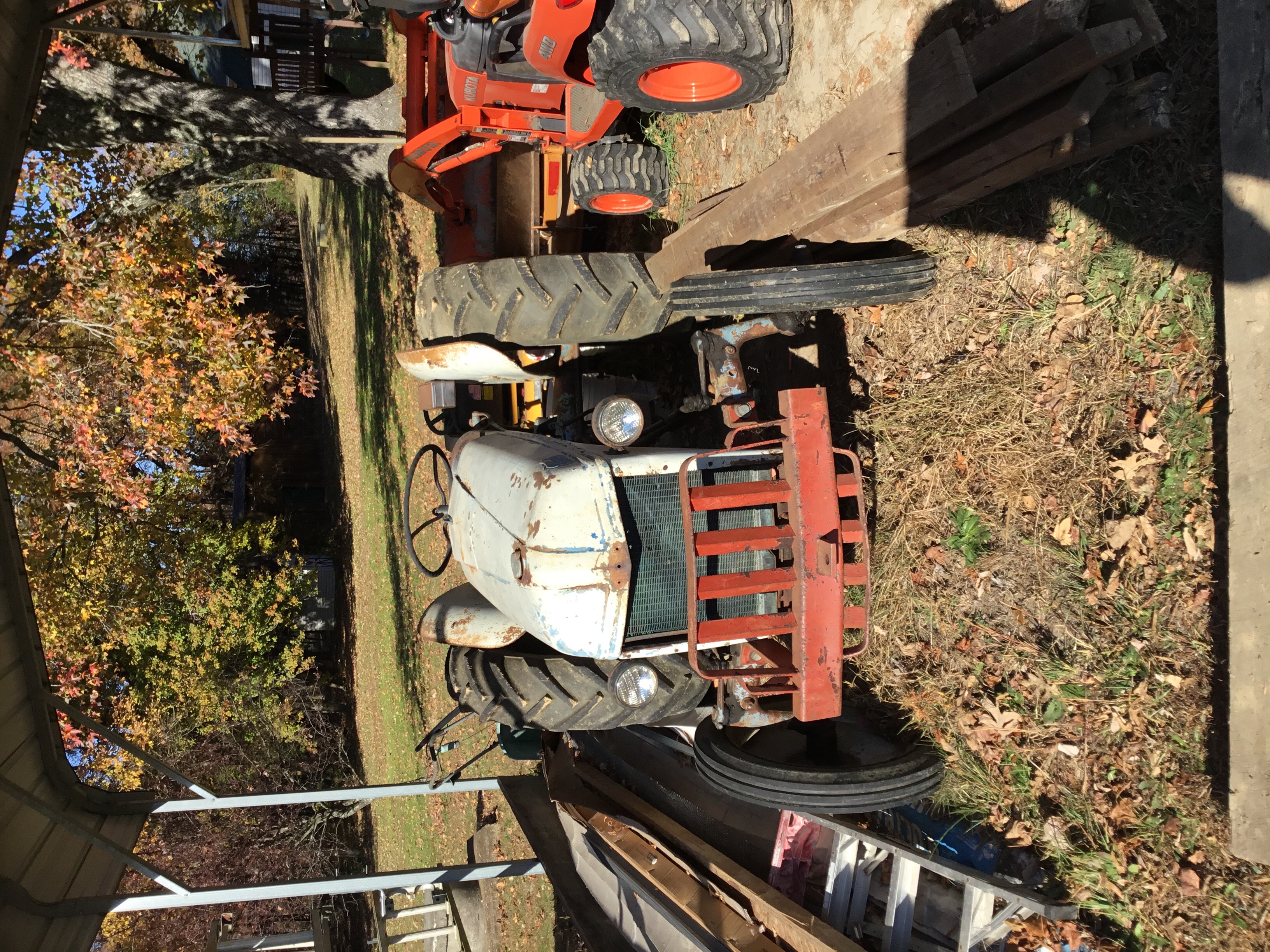

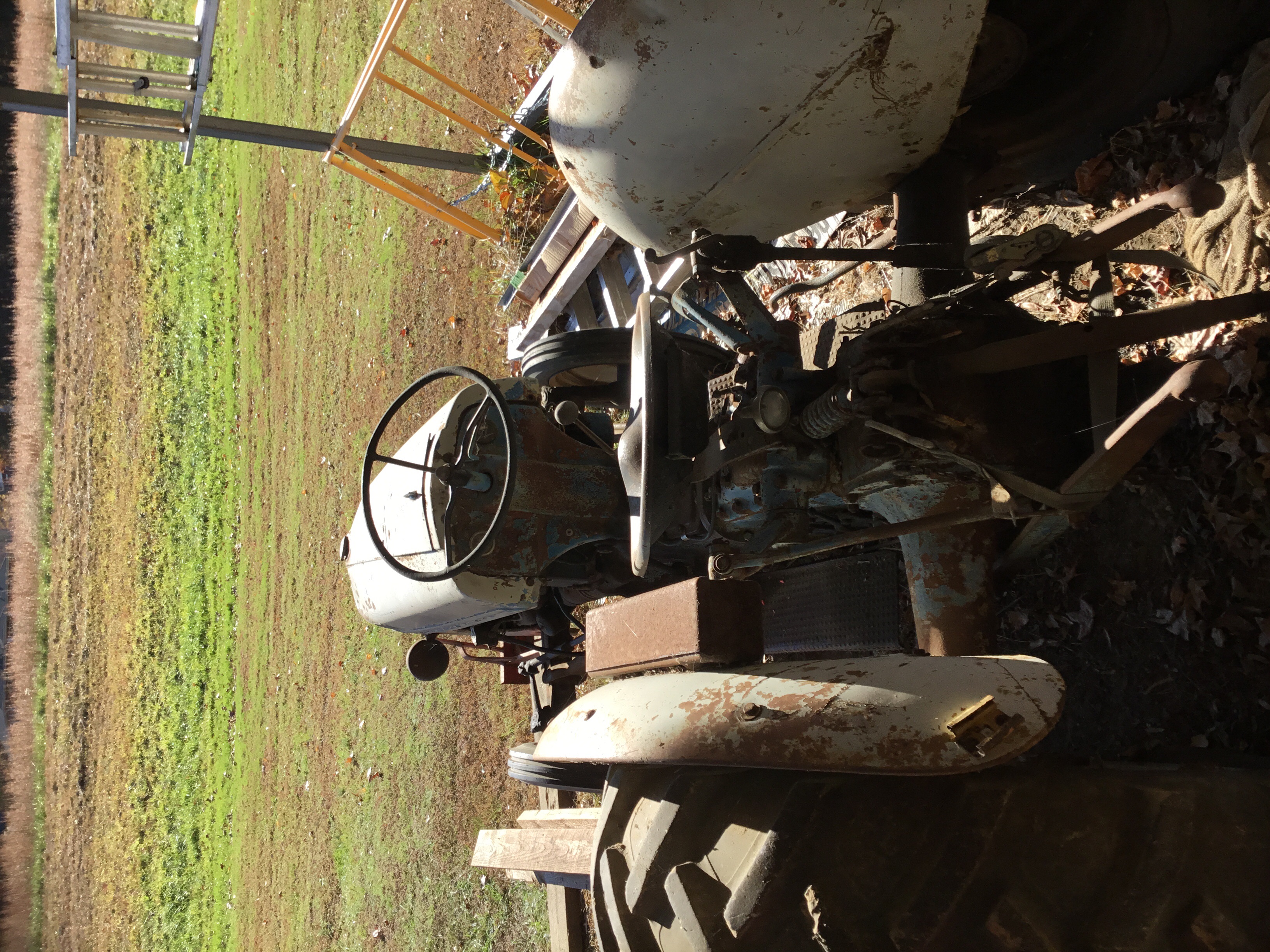

I recently inherited an old ford tractor from my grandfather and I'd like to begin restoring it. I am having trouble finding the year and model of the tractor and nobody in the family seems to remember either.
I found the serial number on the left side of the motor and have cleaned it up to bare metal but I still can't make out what it says. I've tried the pencil trick, the chalk trick and a flashlight in different angles with no success. Any help will be greatly appreciated. image.jpgimage.jpgimage.jpgimage.jpgimage.jpgimage.jpgimage.jpgimage.jpg

Also try taking pictures of the serial number with a phone from different angles.

It is an 8N. If you cant ID the engine its no real big deal. The casting numbers will help in narrowing the year model. With those older Fords they were used and often abused and pieced back together more often than not. They were truly ground breaking in every sense of the word it ushered in the automation age to agricultural world. I can still hear in my mind my Great Grandpa saying just how much more work he could get done with his 9N. Image what he would be saying today with 4 wheel drive grapples and on and on
/ Model and year help. #4
Yep, 8n.
Dont really need to know the year. 8n,s were made from 47-52
In 1950, they went from front mount distributor to side mount. Thats about the only different that is relevant, as you need to know that for tune-up purposes

A quick way to tell is the 8n had the 4 speed and floorboards. 9n and 2N had the 3 speed and foot pegs. 8n brake pedals together on one side. 9n and 2N were split with one pedal on each side of transmission case.
9n and 2N differences were slight. The 9n had I beam radius arms but the 2N had round radius arms. Mostly. All 9n and some 2Ns had I beams prior to 1944.
BUT as mentioned earlier, the tractors were very popular. The parts interchanged. And they were hodgepodged together with whatever was available as the farmers repaired them.

It has parts on it for '49 and '50. Look on the front side of the axle trumpets for a date code. Also near the starter on the engine will be a production date code tag above the raised 8N or 8NB
My guess from the photos would a 1950
