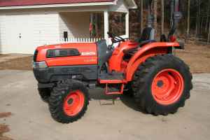

Scam alert or something does not seem right with picture???
If you save picture and zoom in with the photo viewer, the area under the loader arm and above the lift cylinder where the chrome Lxx30 numbers are supposed to be have been partrially "spray painted" over by a photo editing program or may be from some other distortion?? Looks like either a stolen photo or something is not right. The tractor looks like a Grand L3130 or L3430 maybe a LA513 but probably a LA723 loader and it has the heavy duty pin on bucket.
Reading from other thread, no there is no locking front differential, just rear. Mid PTO is an option on Grand L series.
I would deffinately check this out in person and run serial numbers. Model number is mylar sticker on frame rail.

The engine numbers may be specific to a certain model year in some cases. For example, my 2009 L3400DT-1 has an 1803 series engine, not a 1703. The engine displacement changed from 1.7 liter to 1.8 a few years ago, bore and stroke is different as I recall.
We can speculate all we like, until you can actually look at the tractor up close and personal, there's no way to be sure what it is. As an example, I could sell you a 3430 that belongs to anybody as long as I have pictures of it and you're willing to accept an arm's length transaction.
Like this one in Shreveport. I don't have the serial numbers, but I'll let 'er go for $8000..:)

I agree 100% that I would need to see the tractor in person before buying.
The one individual stated the model number is a mylar sticker.
I understand the craigslist scam about using ebay - never made any sense to me, my friend found all sorts of tractors on craigslist which got him excited but everytime I told him to go look at it in person and the seller never let him do so which is like a fire alarm going off.
This seller on the other hand states I can see it in person - i do not think it is a scam but I am suspicous that the tractor has 840 hours and the front AG tires look very worn. Also - I agree that the tractor may have been repainted, one of the photos had the pin on the inside of the loader was orange - I do not think that Kubota would have painted the pin.
The tractor looks too clean.
Does anyone know if the ROPS tag will tell me anything? That tag is still on the tractor.

Heh heh 20 mi WEST of Ventura would be quite wet and salty :) You sure you want to go that far for a tractor? Shipping alone will probably be another grand or two...
All of the tires look quite worn to me from that pic. Perhaps a lot of time on pavement if it was a city unit?
