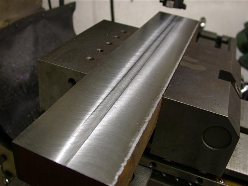

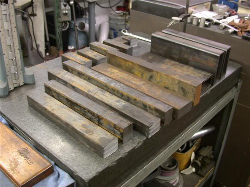

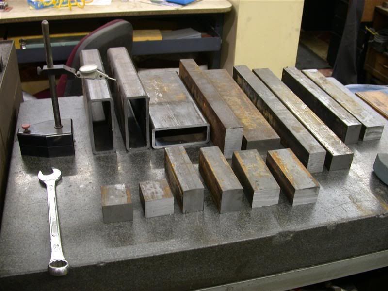

I started working on the receiver mounts today. I'm going to make some extra receptacles like on the boxblade for future implements such as a rock or landscape rake. First thing was to saw it all up and then fly cut the pieces so they fit into the underside of the wheel frame. Here are pictures of the added steel I need for them. That should keep me busy for a while.

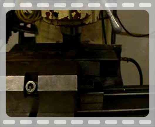

Larry, I added this video especially for you. It's using a fly cutter to mill a large surface down without having to take too many passes back and forth. My mill is moving at 40" a minute. That is a 2" wide bar in the vise, 14" long. I wish the lighting was better, but I was getting bombed by chips.:D
   / MODIFY BRUSH HOG SOME MORE #140
Must be nice to have power feed on the X axis (or any of them for that matter). My 2J machine isn't equiped with such luxury devices.
