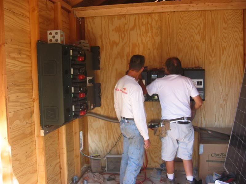

Rob I think youhace outback invertors don't you?
A qutoe from thier web page
-Phase Stacking - More power for three-phase loads
Three inverter/chargers can be configured to provide 120/208 VAC or 230/400VAC four wire 展ye/Star three-phase AC Power. An nverter/charger is used to power each of the three legs for 3-phase AC power. The loads on each of the inverters does not need to be kept balanced, each phase is independently voltage regulated.
You would have to add one invertor and change the maby change the hub connedted to the invertors and the mate display
120-208 star arraingment would work on most machines that can be wired for 220 and you still have 120 for normal loads.

Sandman you are correct about the "drive type invertors" they are motor spifice.
Rob has a out back solar system and you can stack 3 invertors on the dc side and get 120-208 v 3 phase out the ac side
Rob on page 22 of my manual it shows the 3phase hookup
tom

Solar panels are DC and have no "PHASE." If you store the energy in a battery or alternatively have a really huge array of solar panels you might run a three phase inverter or system of interconnected inverters to produce three phase power to run your machines but the solar panels themselves have no phase as they are DC.
Pat

Hmmm, well maybe that's what the contractor meant when he said no three phase with this set up.
There's four on the left panel and two on the right one. That right panel is for the shop and the left one is for the house. I think I have six altogether, right?
