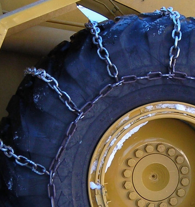

The last set of chains I bought were ones that didn't require any tools to change the cross links. There's a hook that comes through a link in the side chains, the end link on the cross chains has a slightly flattened section that when turned sideways can just slip through the opening of the hook. Works great, I've never had one come loose.
Can't remember the brand, I'll try to get that a picture or two and post back...
Edit - found a picture of what I was talking about. Note the small "notch" on the middle of the end link in the cross chain - that slips through the hook the comes through the side links. Works slick...
