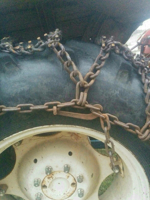

My chains
I have a set like these, I believe they are "Norse" brand and they do need be tighter. Great in the woods not so much on the flat, very rough and we would have to constantly pull them back to centre to keep them on the tire. Now we are using a trygg chains, they run loose and have had no issues falling off and they are smooth on the road.
What works for one chain installation may not apply to another brand.

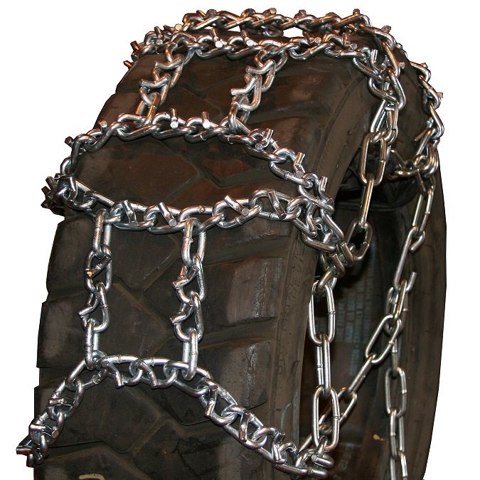

Well good news, at least for the front. I've measured my front tires 3, even off the ground using cardboard templates to get the correct width and diameter and measured the local stock that is supposed to fit.....NOT! What I am finding from Peerless, NAPA. Hog Boss, and others, that the size for my tires are actually a combo size and usually are too wide 16" for my tire and stay out of the steering knuckle.
Joe Casper, Snow Tire Chains from the Largest Tire Chain Wholesaler in North America | , took the time to actually measure up his stock and found these; Product Search | Snow Tire Chains from the Largest Tire Chain Wholesaler in North America These are 13" wide and the correct length with a bit to spare and designed for tires like mine. Now I can at least turn while pushing the snow.
He also gave me a great price on a long handle chain tool.
Will be ordering Monday
PS - if your nice you can get possibly get a good guy price from them too. Also still working on a fit for the rears without using spacers.

That's one reason I went with the H pattern for the front. I have used ladder chains on my oversize garden tractor for years and found when the front tire rotated to be just between the cross chains it went sideways a bit while plowing. Some sets were 2 link that did better, but they only lasted a couple of years on average. The ones I just received are probably 4 times as heavy as what I had been using. I hope to get mine on today and will post pictures.
