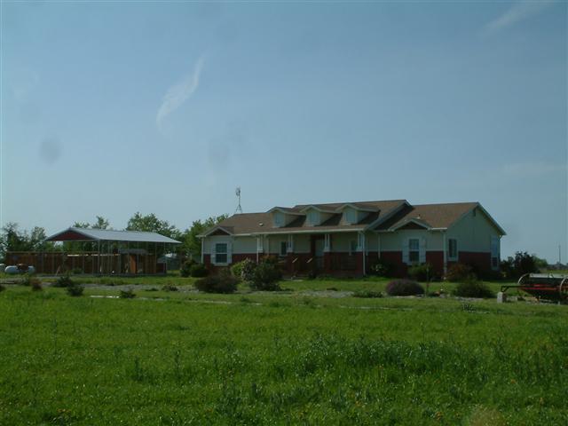

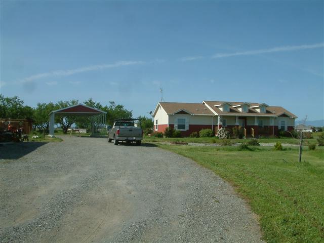

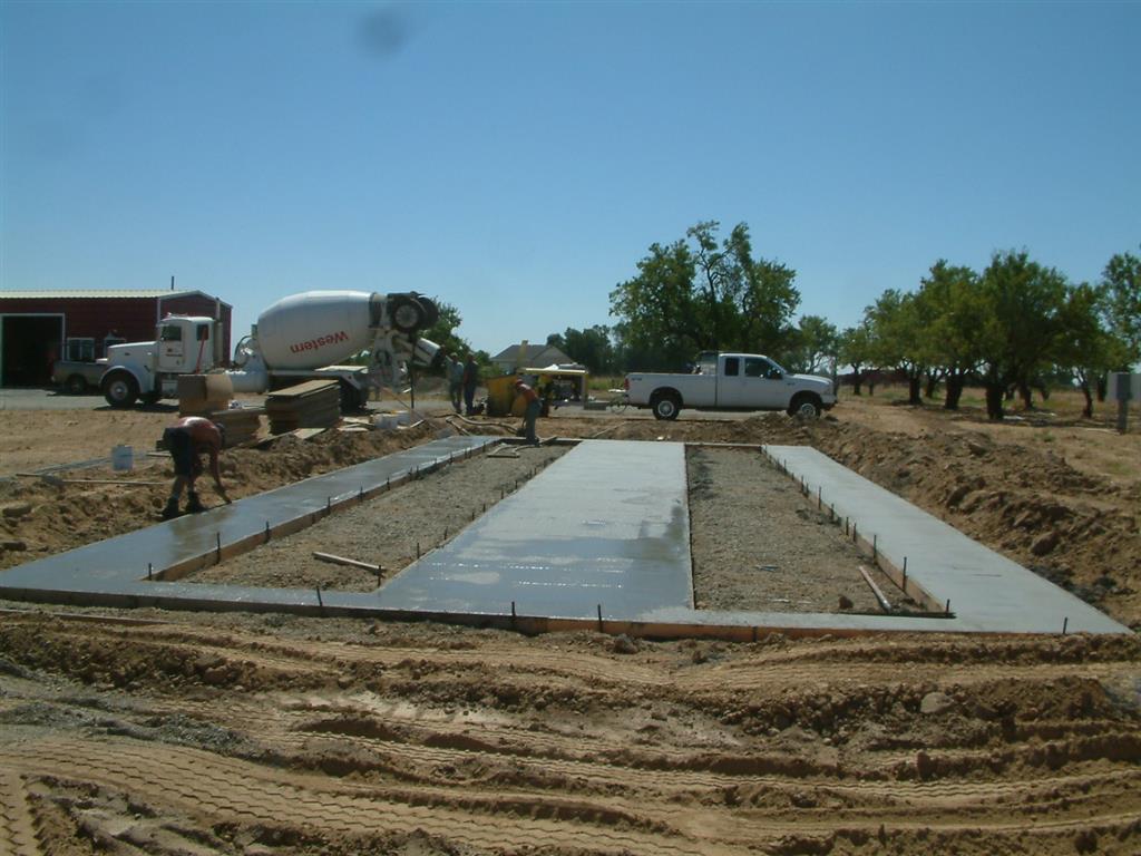

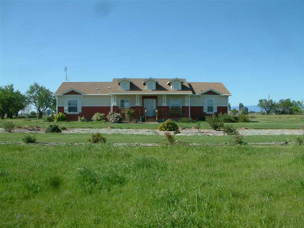

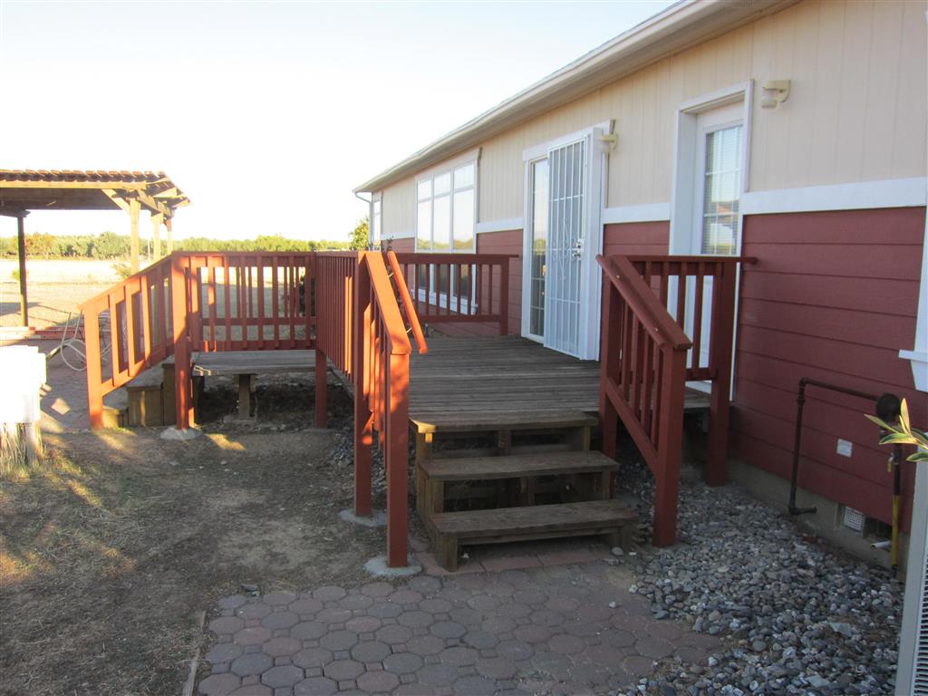

My double-wide manufactured home was built on my 10-acre ranch in Tehama County, CA in Sep 2005 thru Jan 2006. 1800 sf, 3BR, 2B, 8'ft walls, 5:12 roof pitch, Hardipanel and Hardyplank exterior, triple dormers on a roof bump-up, large front porch. House is on a permanent foundation with 24" crawl space.
Manufacturer was Golden West Homes, a division of Clayton Homes, located in Portland, OR. The on-site work took so long because the top part of the roof trusses were erected after the house was delivered (to get under the overpasses on I5 between Portland, OR and Red Bluff, CA. Same for the dormers and the front porch which were built on-site. Also in 2005 the building boom was in full swing and I could only get the installation crew on-site for 2 or 3 days per week.
No problems with the home in the 10 years I owned it. Sold it in Jan 2015.
