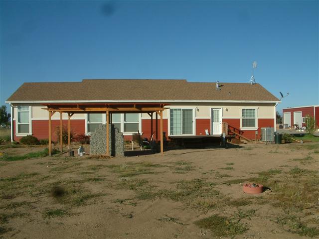

In 2005 I had a manufactured house installed on my 10 acre place in Northern CA (Tehama County). Double wide, 1800 square feet, 3 bedrooms, 2 full baths, 8-1/2 ft ceilings, 5:12 roof pitch. Building code required a poured concrete base with 24" tall stub walls to form the crawl space. Manufacturer was the Golden West Homes division of Clayton Homes, Portland OR.
Cost: $135K for the building and the foundation. Best home I ever had.
It took about 5 months to get the job done. The three fake dormers had to be stick built on side as well as the front porch columns and deck. The roof trusses were truncated to fit under the overpasses on I5. So the trusses and the top part of the roof had to be completed on site.
The work was done in late 2005 when the building boom was still going hot. The installer only had about 15 workers and about 5 jobs going simultaneously. I had to fight to get a 3 to 4 man crew to show up 3-4 days a week to work my job, which is why it took so long. But I finally got what I wanted and never looked back.
Good luck
