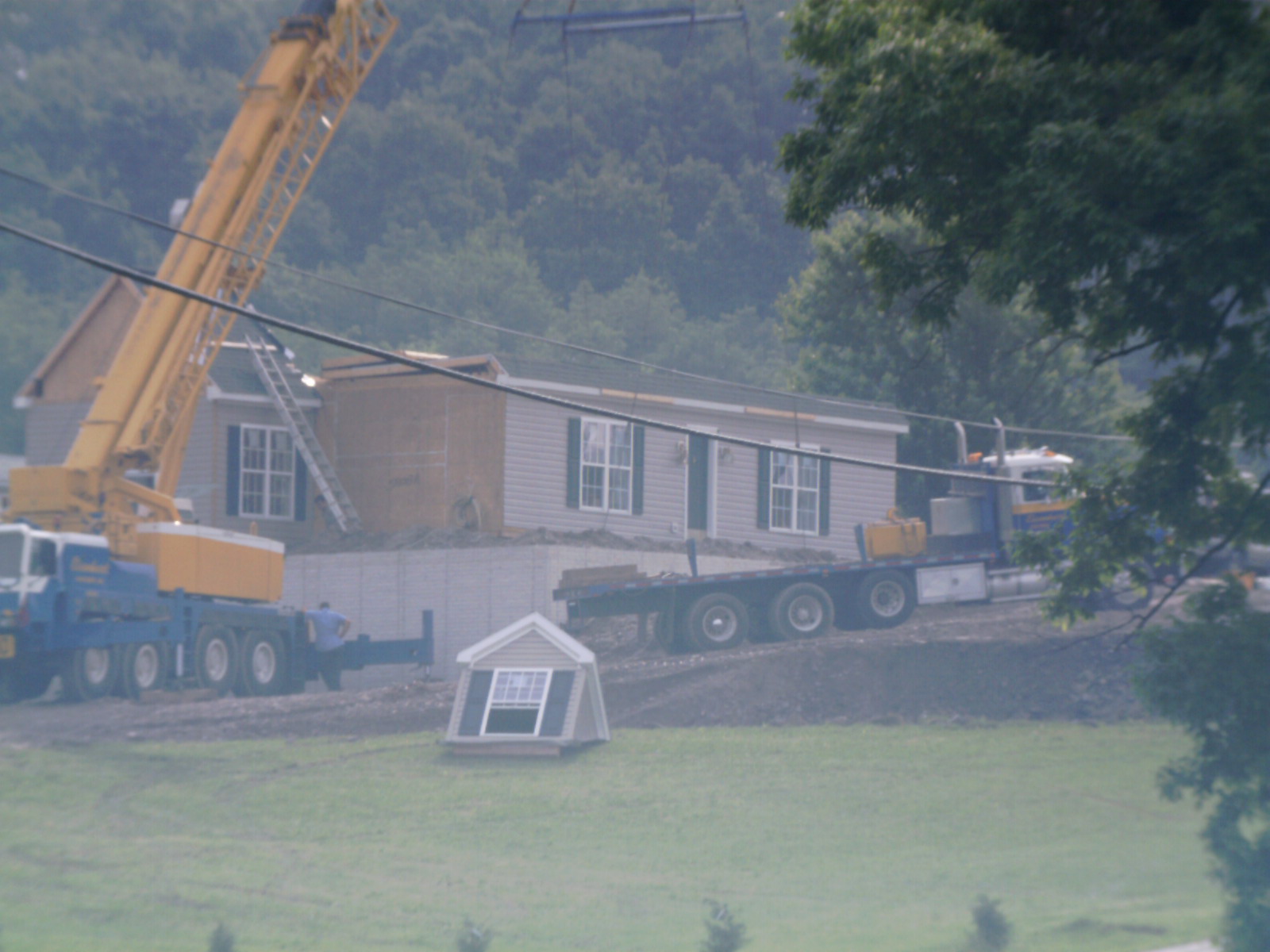

attached link is my neighbors modular being set.
