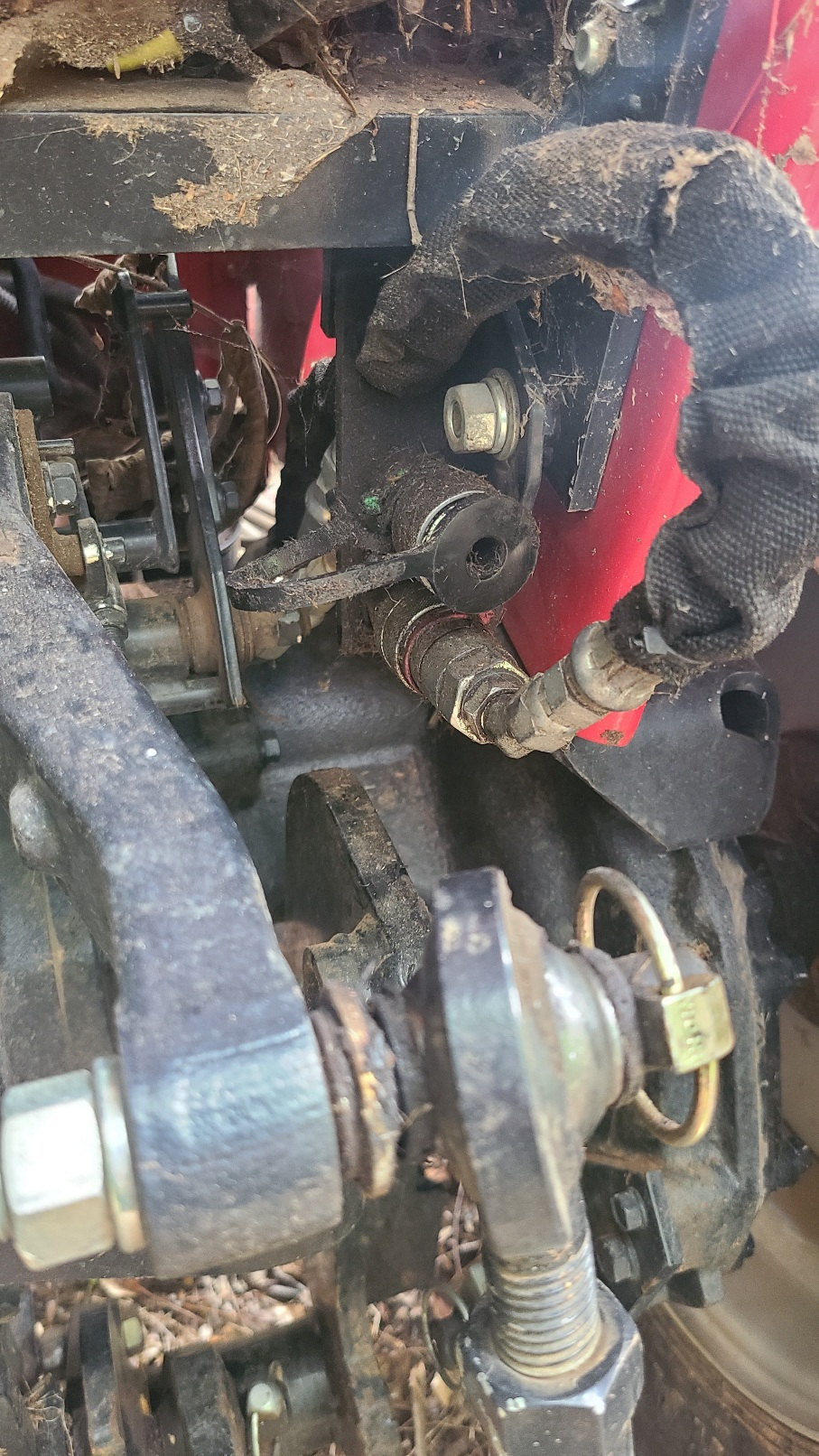

I doubt that he has a rear remote and the OEM only offers a single valve for the rear remotes at a crazy cost.
Something similar to what is pictured would work well for him.
To find something that is on the shelf or has a short lead time, good luck. :rolleyes:
He said he has is “plumbed for a backhoe”. That must mean a rear remote no?
Btw I didn’t mean to denigrate your company at all, definitely wish i could afford to wait for the good stuff (yours!). Are you able to comment at all on your stated lead times, and what a plan (if any) is to improve? Thanks for all your contributions here!
I doubt that he has a remote. Typically just a power beyond loop at the rear of the tractor for a backhoe for those models.

By the way, for your CK3510 side link, it needs to be built with a 3" stroke cylinder to be able to have an equal amount of tilt angle to both sides and match the factory fixed left link for overall pin-pin length. If you want a check valve, I can provide that also. I am 99.99% sure that you will not get this side link capability from any other source. ;)

Yep, it's no big hurry. Project is for next season most likely.
But I will have some use for it after hunting season down at the club.
Around Jan or Feb.
Local Mahindra dealers won't do it. Called Hydraulics Depot and they said they could install it but I'll hafta get the parts.
So now I'm tryin to figure out which rig I need on Brian's site. Thanks! :cool:
ETA- I can take a coupla pics of what's there. Looks like it'll be a good while anyways..
Fill out the contact page and we can go from there.

FWIW, here's a coupla pics of the existing setup.
