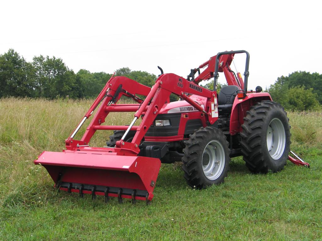

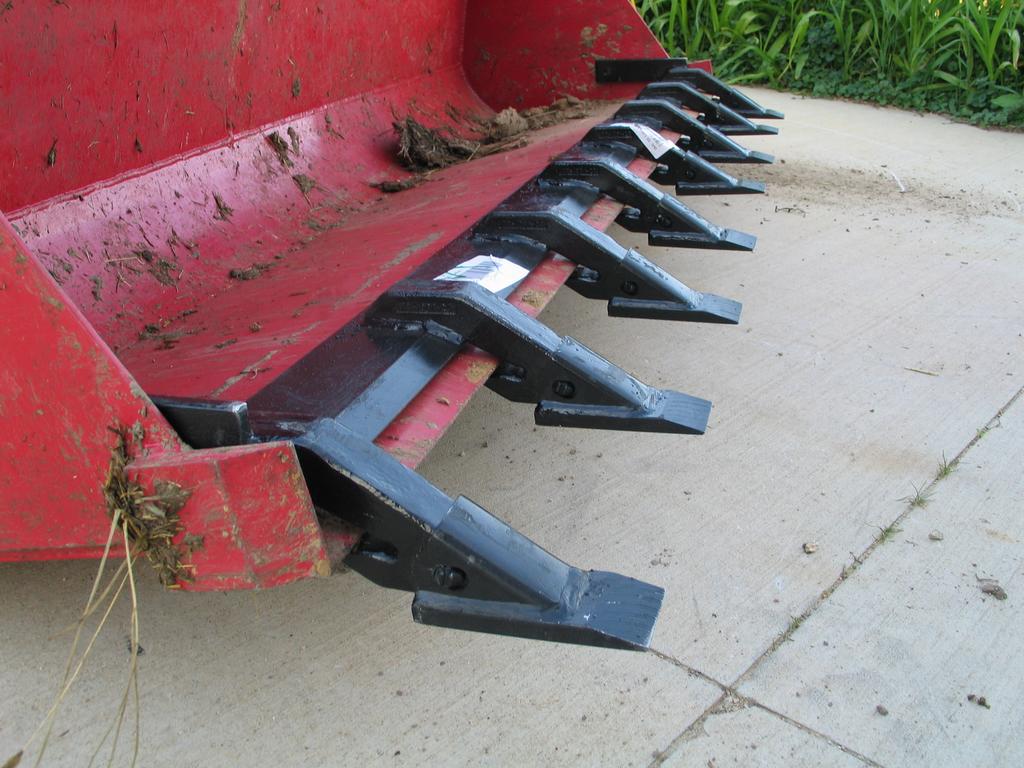

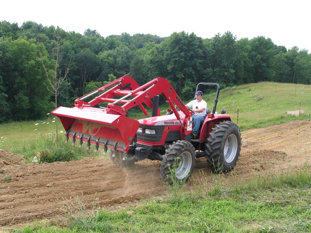

Well, I give up on posting on the gallery here. Can't seem to get it to work per the instructions. Anyway, here she is - my wife has named her "Red Bud". I will probably go with "Bud" for short.
I am very impressed with the EZ Attachments toothbar. I have gotten lots of compliments so far - and a bit of envy, too. Now need to give it a taste of something this weekend - if the wx cooperates.
I've found I can get replacement teeth, too.

that a very impressive pille of dirt you made with that new tracter.

The ATI EZ Standard toothbar seems to perform great. I can dig with no problems - even in some undisturbed-packed dirt to make a way for water to get out of the courtyard area. Since this toothbar is the same teeth and build as for heavier tractors, looks like no way I will be busting it without really trying.
The only thing I can say is that I would think the Markham design might penetrate a little easier for a smaller tractor like mine because the EZ Standard has more frontal surface area to contact the dirt due to the additional V-shaped cutting edge whereas the Markham simply uses the cutting edge of the loader bucket. However, I still would opt for the EZ because of the beefier design. In close quarters doing the courtyard, I punched the foot thick concrete wall a few times rolling over a pile of dirt. If that shock had been against the teeth bolted to the bucket frame only like the Markham, it could have bent it I guess.
