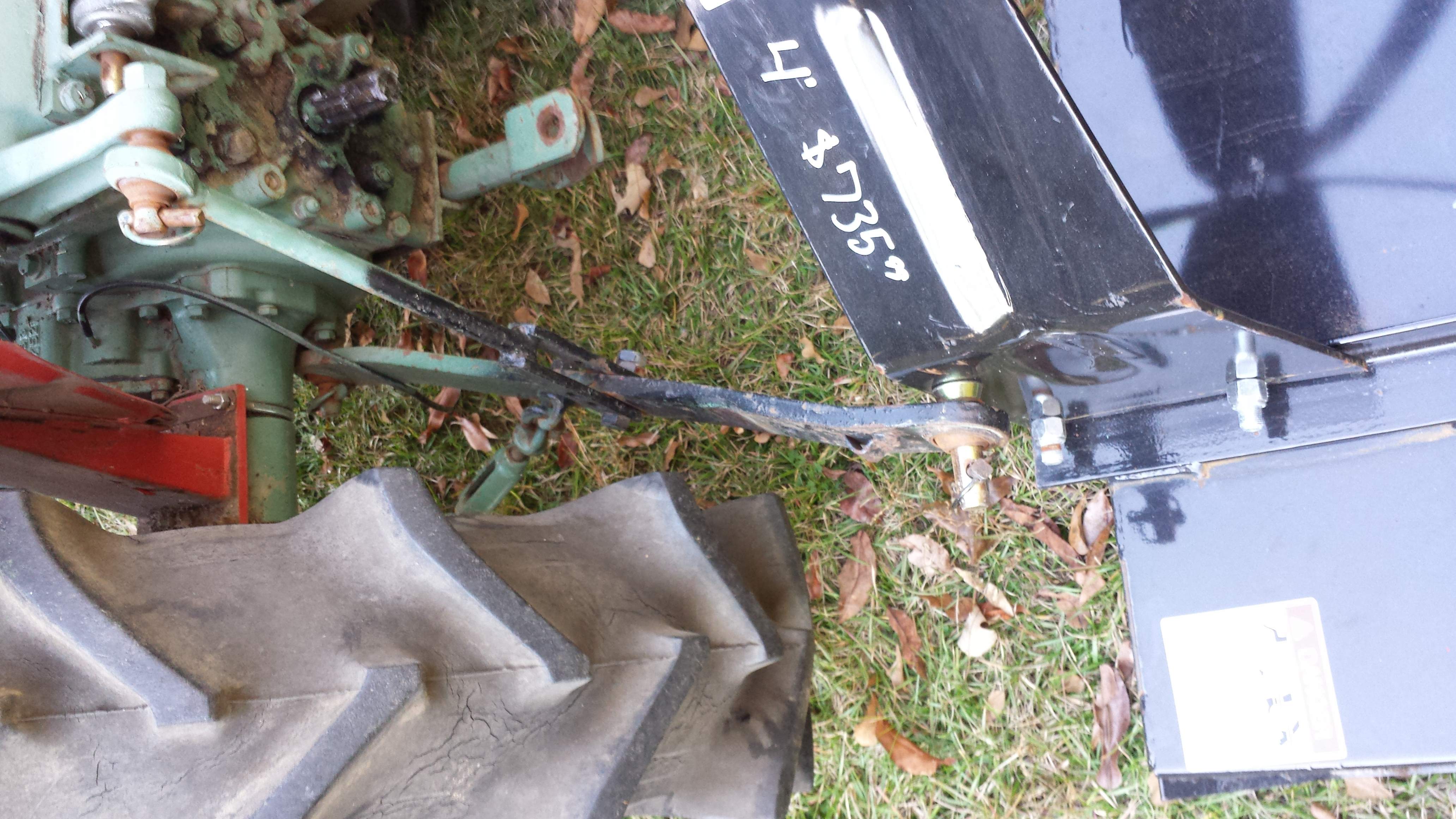

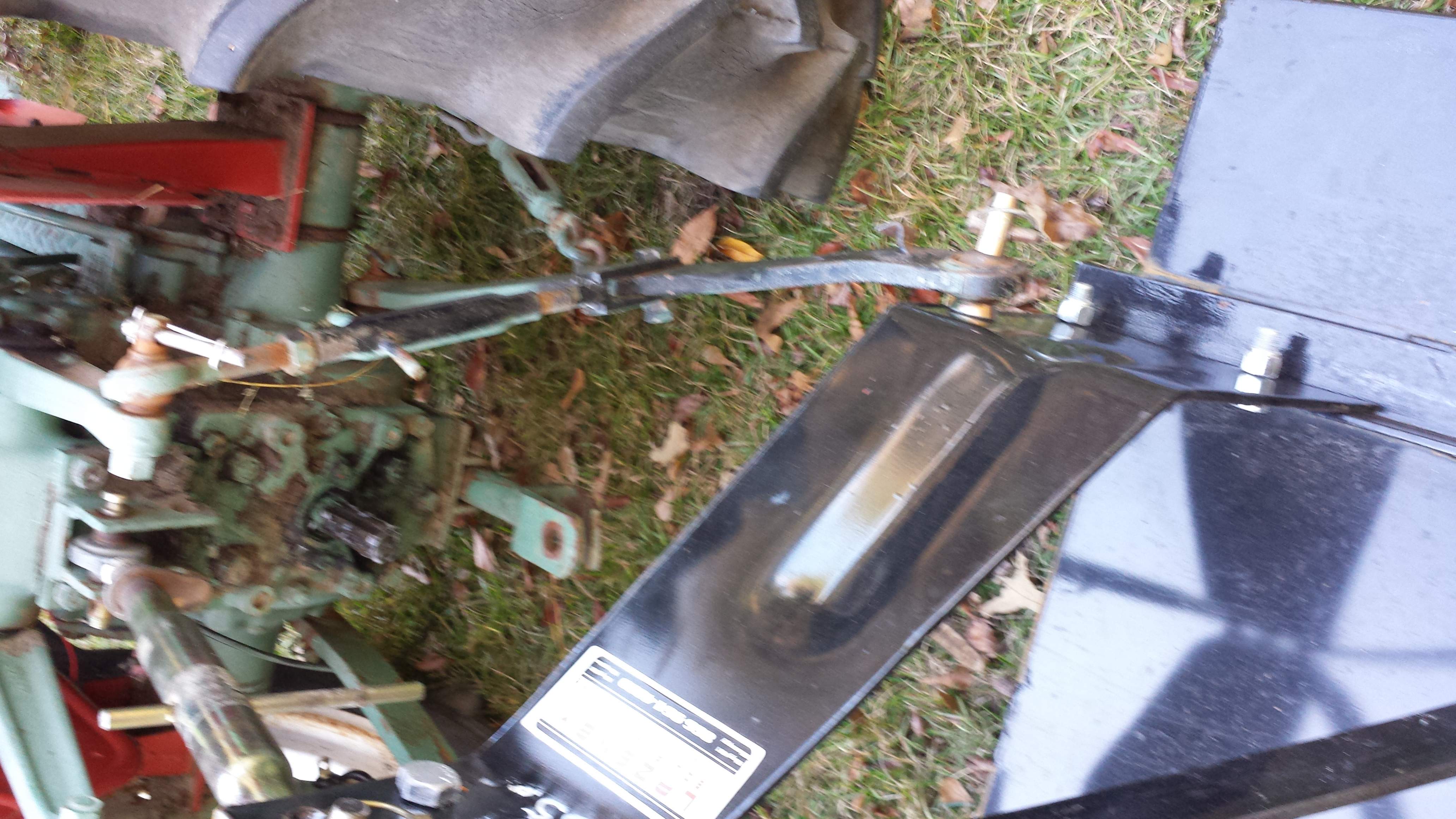

Okay, for those that saw my other thread, I didn't get the used one. I bought a new Howse 4'.
Now the problem...hooking it up. I case you haven't figured it out, I have no experience with these things.
The two lower arms, that attach to the BH, are so far apart when I put them on the pins on the BH, that they hit the rear tires unless I go perfectly straight. I know that the tire have two ways of mounting, so I switched them around so they are in the wider position. What a PIA that was. Frozen 35 year old bolts! But I got it done. It is better now, but the tires do still hit the arms sometimes.
The only thing I can think to do, is to re-mount the pins, so that they face the inside of the A-frame looking thing 20131206_152916[1].jpg20131206_152931[1].jpg on the BH.

You are correct... put the pins on the inside.

Yes. Your turnbuckle limiters with the pins in the outside configuration. Put some spacer washers outside the lift balls to hold them inward on the bushog pins. This will allow you to make limiter adjustment giving sufficient tire clearance.

QBH , I may be lookin ' at it crazy . But it looks like what ever you did to put your tires in wider position ended up causing the treads to be pointed in the wrong direction .
/ More bush hog help please! #13
naw.. he jest wants traction in reverse.
or when he dished he didn't swap side to side... :)
pics are hard for me to see on this tablet.. but does look like he's set for reverse traction...
Um, yeah. I thought about that last night. I fixed it this morning. As Soundguy alluded to, I fliped the wheels over, but didn't swap them.
I couldn't stand it, and fixed that before the battle of attaching the bush hog.
