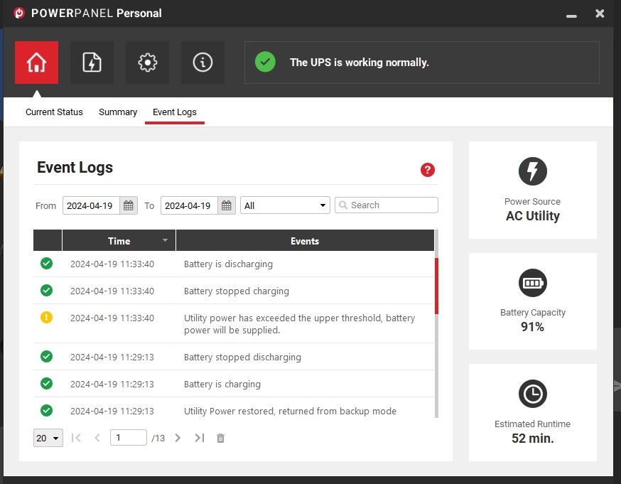

So, the power in my home is fluctuating. The UPS says 114v and sometimes 139v and everything in between. The lights are constantly dimming then getting bright again.
The UPS in the computer room just decided to shut itself off at random after running fine for a year. I swapped it out for another, and the same thing happened. I removed it, and the computer is now on a surge protector strip.
I moved the UPS to the coal stove and it worked for a couple of hours, then it too shut itself off. I ran one there all winter with no problem. Now upstairs, I have a UPS connected to my computer. It randomly switches to battery power. In the software some of the logged events say lost power or voltage exceeded threshold level.

Contact your electrical supplier and explain you are having electrical problems. It COULD be a transformer failing. If they don't find anything have a good competent electrician come check your main breaker and panel box for a loose connection.

Had similar issue 2 years ago with voltage fluctuation, lights dimming and brightening . Utility found loose neutral at pole. recrimped connection and issue disappeared

Loose wire in the system ranging from outlet to circuit breaker panel to meter to pole. Bad neutral can cause all kinds of strange.
Damaged underground feeder not located until steam seen coming up from the ground on the forest floor.
Faulty transformer and causing wide fluctuation…

Because this is a whole house issue, it reduces it to essentially the connection to the main breaker/ground. And something outside with the utility company.
I like the idea that it might be a poor ground connection.
As far as whether that could cause over-voltages, I played around a few years ago with 220V and a floating center ground. It was rather odd, but yes, a load on one side could throw the voltage on the other side wonky.
Now, diagnosing on your end. It will depend a bit if you are comfortable with the main breaker box.
One relatively safe diagnostic you could use would be an IR camera or IR thermometer. When you're running a heavy appliance (for a while), then a shorted connection would likely show up as a hot spot in the box. Primarily concentrating on the big wires at the top, or the bus bars.
A floating ground would show up if you turned off most stuff in the house, then turned on a single 110V high power device (1500W hair dryer?) Checking your breaker box with an electrical tester, then every other breaker would be high or low.

Utility said un-balanced load. 1 leg was 110 volt and the other leg was 132 volt . Both legs voltage up and down. Do know when neutral was re-crimped the problem disappeared
/ More electrical woes #17
I suspect you have a bad neutral and where I live the power company says they are not responsible for open neutral problems.
Caution: What can happen is 180VAC or move volts on one leg and 60VAC on another fluctuating can and will damage everything electrical in your house.

Not responsible for the problem or not responsible for damage done? If it's on their side of the meter, it's absolutely their responsibility to fix.
I agree, it sounds like a flaky neutral somewhere.
/ More electrical woes #19
Yep, most likely a poor neutral.
