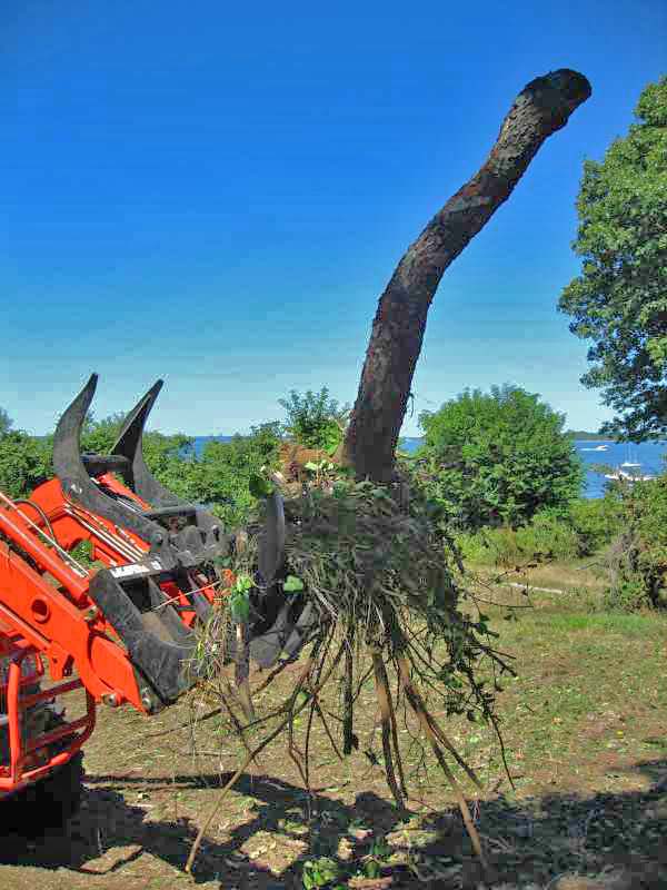

I would like to know if there are any grapples/root buckets sturdy enough to dig out standing timber.
jmf
I don't know what size "timber" you are referring to but many of us have successfully uprooted trees that our tractors can push partly over so we can get at the roots with the grapple. To my knowledge no one has ever reported damaging a grapple trying to uproot a tree. The limiting factor is the lift or curl capacity of the loader and the weight of the tractor. It doesn't always work with the first try but six to eight inch softwood trees with shallow roots are not really much of a problem for a 4000lb tractor and strong FEL.
