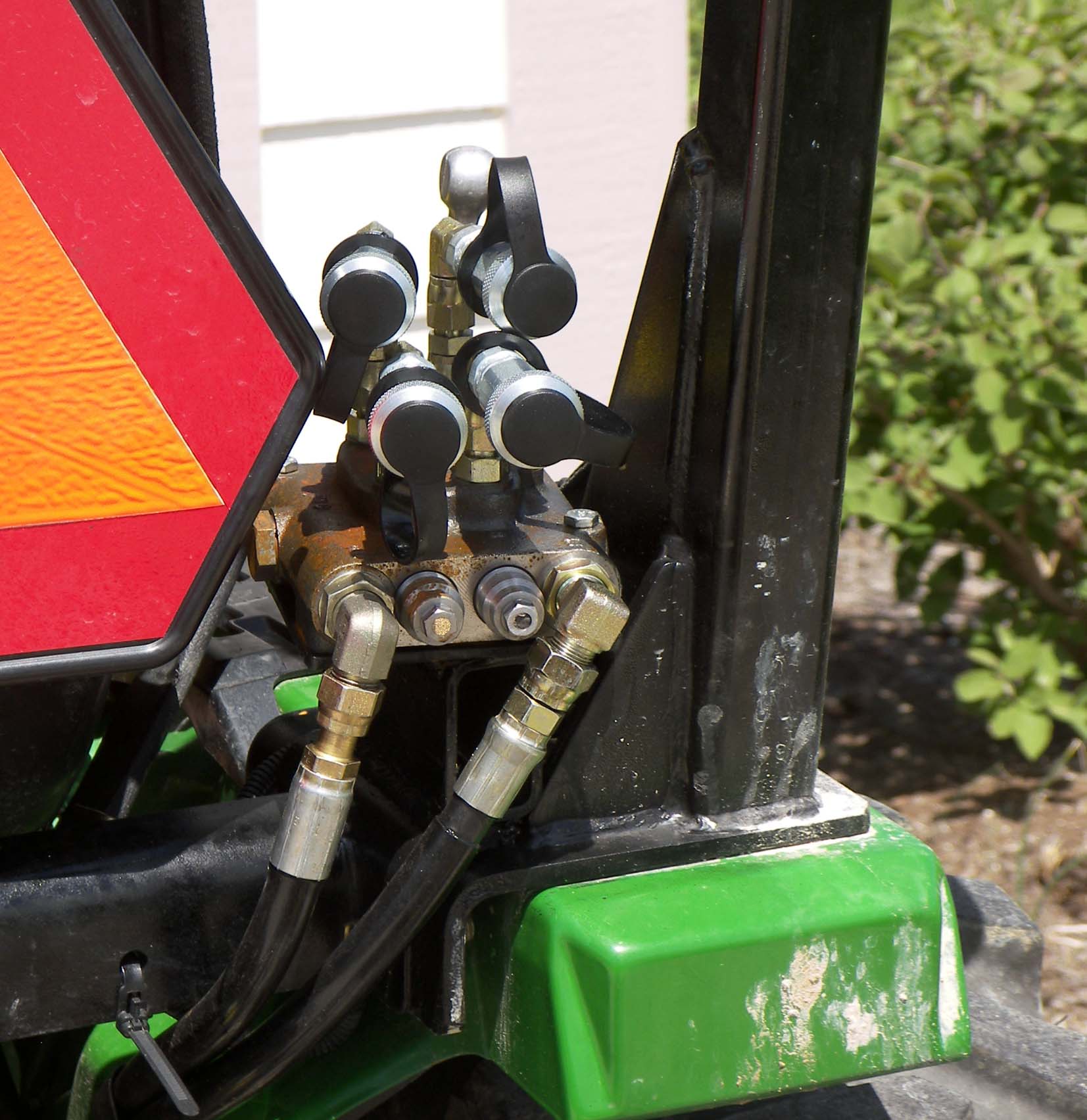

OK, the task is complete!
I now have four rear hydraulic QDs on my 4100. And two valves of course. I had sent photos of KennyD's install to my dealer so they'd have a good idea of what I wanted.
They picked up the tractor on Monday and brought it back on Friday. I went on Saturday so they could make up the hoses for the cylinder I bought from Mark at CCM.
This photo is from the rear and shows the QD female couplings.
   / More hydraulics on my 4100 Hydro
#31
This shows the front of the valve with one of the levers attached. The dealer broke one tring to bend it for more seat clearance. It's now in place.
#34
Looks an awful lot like KennyD's doesn't it? That's not a bad thing as he did a wonderful job on his. And he did it himself too.
I like it a lot as I can make adjustments on the box blade while in motion. I was out this evening working on our gravel road and it's a wonderful thing.:)
I do find that it's esay to hit the lever with my elbow and have the cylinder move when I didn't intend it to. :( Little bit of a lesson I need to learn.
I'll have to add a tilt cylinder in the future. Already thinking that now that I have 'extra' hydraulic outlets I could add a grapple, or operate a 3 point log splitter, or operate a dump bed wagon, or....
I do have a confession though.:mad: I was reversing the location or the pilot valve on the cylinder to gain more hose clearance against the tractors frame and cross threaded the banjo fitting. :eek: Now it leaks like a sieve, but the rear of the tractor will never rust. I guess I'll need to order another cylinder from Mark as I don't think it can be repaired.
At least I got to play with it for a while before I discovered the problem.
