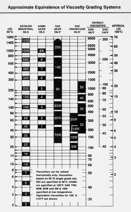

Clemson, it has to do with how the lubricants are rated by the SAE for their purpose (gear oil or motor oil). Here is a chart showing the viscosity differences. At "cold" temperatures, like room temperature, there may be a lot of difference in viscosity between gear oil and motor oil of, say, 80w-90 and 30w. However, the oils are rated at 100C, or 212 Fahrenheit. If you warm the containers up in boiling water, the two lubricants will be the same viscosity. :thumbsup:

No, the previous explanation was incorrect, or at least incomplete. What you see is that gear oils and motor oils (any hydraulic oils, etc) use different measurements - I suspect that they use different orifice sizes for the tests. 80wt gear oil is the same as 30wt motor oil. In multi-grade oils, the number next to the 'W' is cold viscosity, and the other number is the 100C viscosity.
That being said, the 85W-140 I put in my front axle, even though it should be the same as 30wt motor oil according to the charts, flows like molasses in January...literally.

I'm not sure what was incorrect in the information. I don't know enough to give genuinely complete information, and don't claim to. But the units of kinematic viscosity (essentially how easily a fluid pours) are Stokes. Stokes are Stokes. The data for lubricants are normally listed in hundredths of a Stoke, or centiStokes.
Engine oil SAE 10W-40 [SubsTech]
At 104 degrees Fahrenheit, SAE 10W-40 motor oil measures 108.5 centiStokes, and at 212 degrees Fahrenheit it is 15.4 centiStokes.
Synthetic gear oil SAE 75W-90 [SubsTech]
At 104 degrees Fahrenheit, SAE 75W-90 gear oil is 110 centiStokes, and at 212 degrees Fahrenheit it is 19.2 centiStokes.
The attached chart shows how the ratings correspond again. I don't have a source for it, I'm sorry. The acceptable range for 90 weight gear oil spans from more viscous than 50 weight motor oil's high end at 210 Fahrenheit to nearly as low as 40 weight motor oil's low end. At low temperatures (say, household temperatures) gear oil is definitely thicker than motor oil, but around here, in the summer, spilled motor oil looks about like spilled gear oil; gear oil just stinks worse! :laughing:
I don't want to get the thread off topic, but wanted to clarify and apologize if I didn't do a good job of explaining things.
I think you maybe misreading that chart. As I understand it,the single weight oils read across to the 40C scale while the gear oils read acros to the 100C chart.
