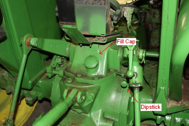

Obvoiusly this isn't your tractor, but here is where they are located at the back of the tractor and what they look like on my Deere. Hope it helps.
