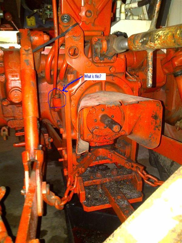

/ Moronic newbie question #17
What is the item on the left rear which I circled in this picture?
I looked at that a while back, and decided that it probably wouldn't be the fill tube, since it didn't look like the picture, and because it was kind of hard to access, and because it had a funky cover that was not easy to open (it wouldn't budge with a pair of pliers), and because it did not look like it had been accessed for a while. I just assumed that I would find it somewhere else in a more obvious location/appearance. Then I forgot about it.
In light of the fact that I can't find it anywhere else though, I guess I should re-visit it. Thanks for pointing it out to me. Like I said, I had forgotten that it was there. I saw your message and ran down to take a couple of quick snaps, but had to leave right away and won't get a chance to try it until this weekend. Here are the shots though.
Looking at it now, with new eyes so to speak, it might be that the plug with the square key required may have been put there by someone else later in it's life, and then just painted orangy-red when the tractor was touched up. Or perhaps it is original, although it doesn't really qualify as easy access for something that should be regular maintenance. I am thinking that a 3/8 or 1/2 inch socket extension may fit right in there and do the job of unscrewing that plug. I will give it a try this weekend, and stick a straw in it to see what colour comes out. Hopefully it will be red. :)
Thanks for the response, you may have solved the riddie!!! I am sure hoping anyway. :laughing:
I used to use my neighbors Case 580C backhoe. It had a plug like that which took a 3/4" socket extension to remove for filling the hydraulic fluid. After seeing these pix, I'm hopeful.:thumbsup: I would expect it to be either 1/2" or 3/4" for the socket extension. 3/8" seems a tad small. I'll be out of town over the weekend (3,000 mile round trip to Az helping move my mother), but will be anxiously looking forward to hearing what you find when I return.
