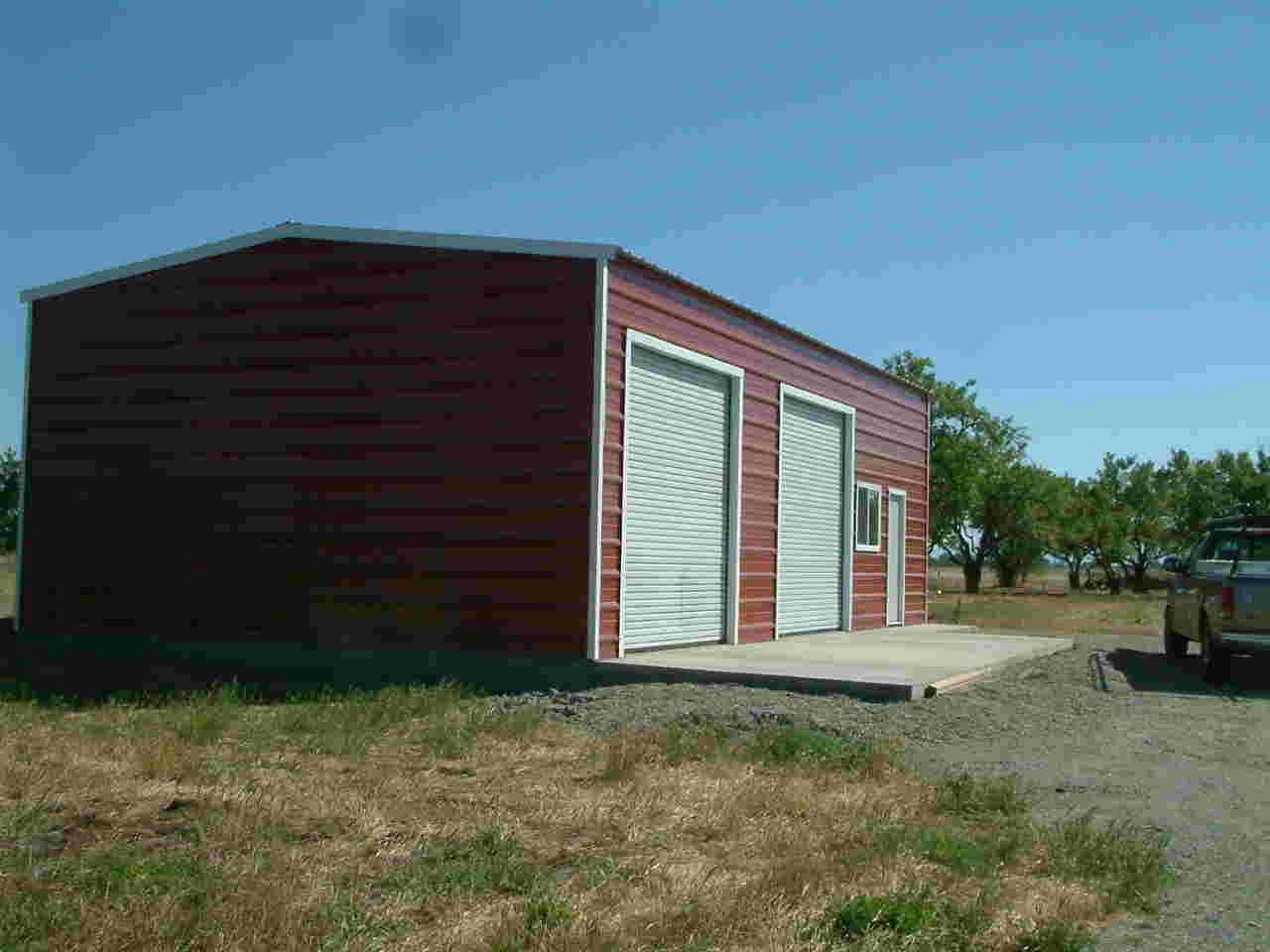

I had an all metal pole barn built on my place last June (24x42 ft, 12 ft walls, two 10'x10' overhead doors, one 36" W man door, 1 window, eave vent).Cost: $16,200.
The concrete slab is 6" thick with #4 rebar in the slab criss-crossed on 24" centers. Cost: $7500.
So figure about $24/sq ft including the slab.
I priced conventional framed structures and could have saved about $1K since these don't have to be engineered. Tehama County requires engineering on pole barns (wood or metal type).
Wood pole barns were a little more expensive.
I chose metal because I like the no-maintenance feature of metal pole barns.
