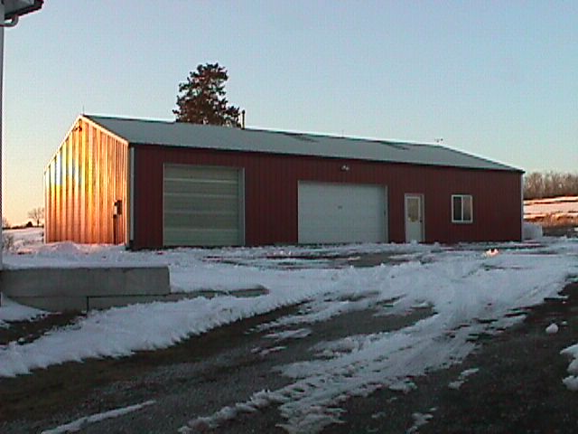

John,
Here's the pics of the building I was telling you about.

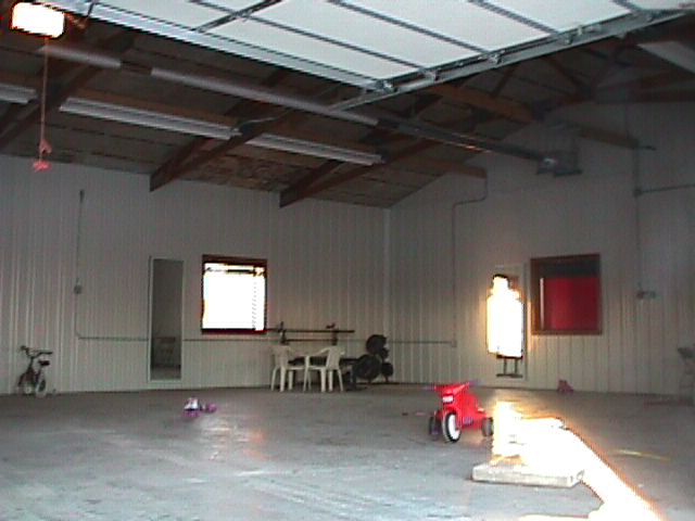

/ Morton Building worth the $? #52
inside

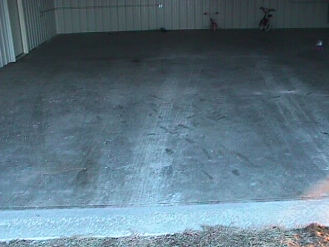

/ Morton Building worth the $? #53
floor

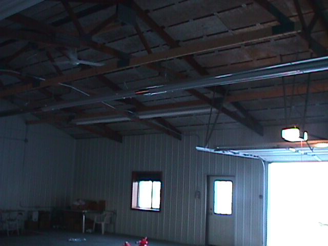

/ Morton Building worth the $? #54
ceiling

Wow, Nice Job! Did you insulate the walls before you finished them? Did you buy a "kit" ? I'm going to look into a few local companies for some prices. I may look into cutting some features; floor, insulation, interior finishing, just to get a building up.
/ Morton Building worth the $? #56
John,
The side walls I insulated first. Then I put in insulation in the top as well as the vapor barrier insulation as I was going to be heating this one all the time.
What I do when I buy these is at Menards they have a computer program that you can design whatever building you want. Then it prints out whatever materials you need from there. So it isn't really a kit. All the specialty work you have to figure on your own, like heating, plumbing, electrical, and concrete.
