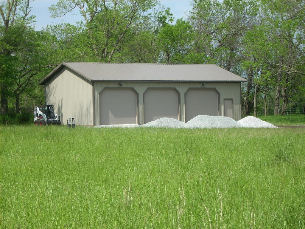

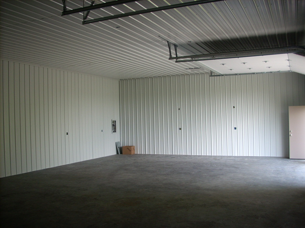

I looked at Morton buildings, and a number of their competitors, off and on for several years. Yes, they build a quality structure - relative to much of their competition. For me, however, Morton has become a "label" - for which you pay as you would for designer jeans.
I ultimately hired a local Amish builder to construct my barn. I feel, in the end, I have a larger, better insulated and better finished building - for much less than I would have dropped on a Morton. This barn is 30x50, 12 foot ceilings & 10 ft doors. It set me back about $34K.

Very nice building KiotiKowboy, I went with the clay also, and you made the right choice by going with an Amish Crew. I had the Amish Crew from Graber Buildings come in and make all the repairs on my Lester Building and I recognized their attention to detail is far beyond most others. I say this to others out there thinking about which company to have build your buildings, the Amish seem to have quality in mind more than anything else so again I would not recommend Lester Buildings at all, but I would recommend an Amish Crew.
