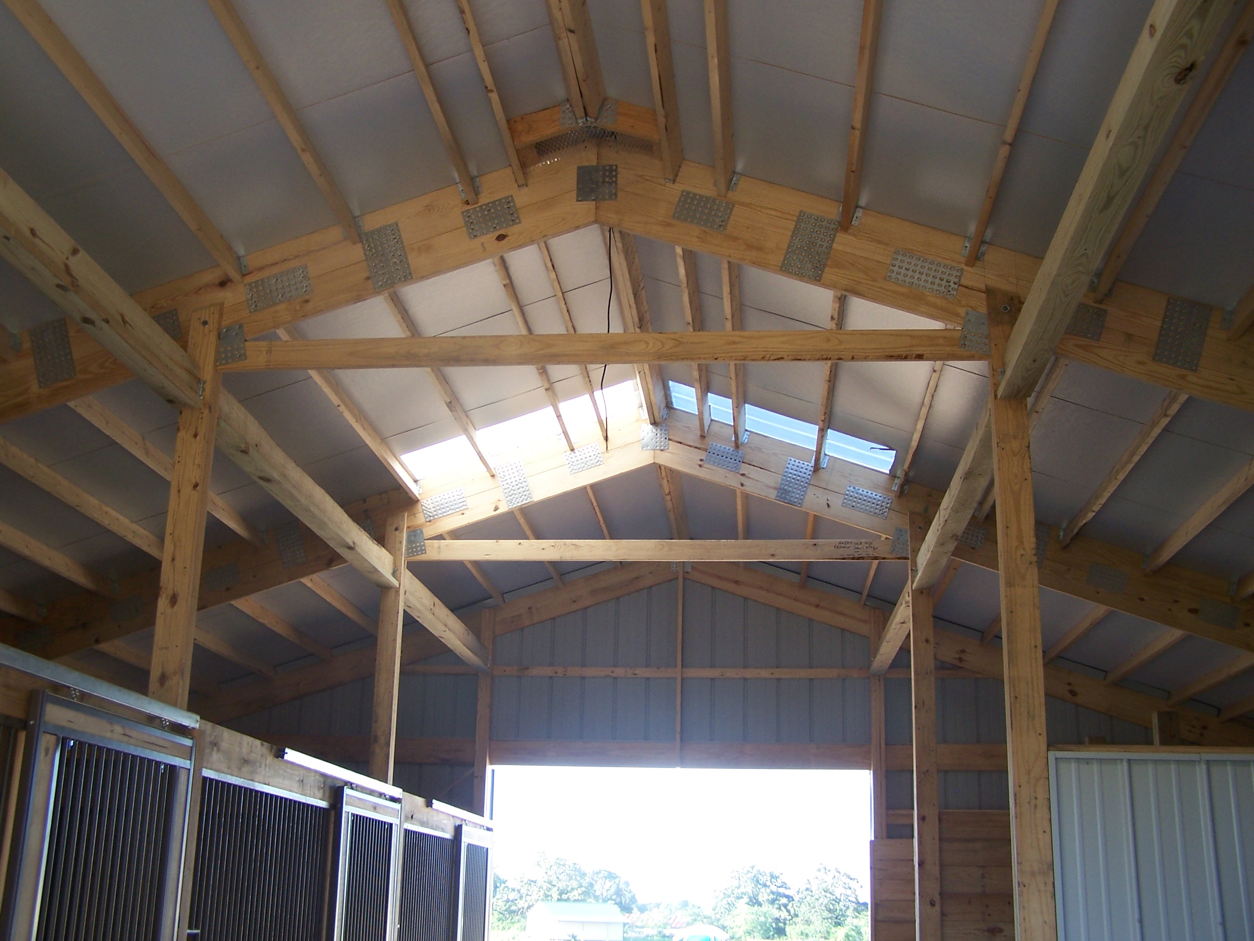

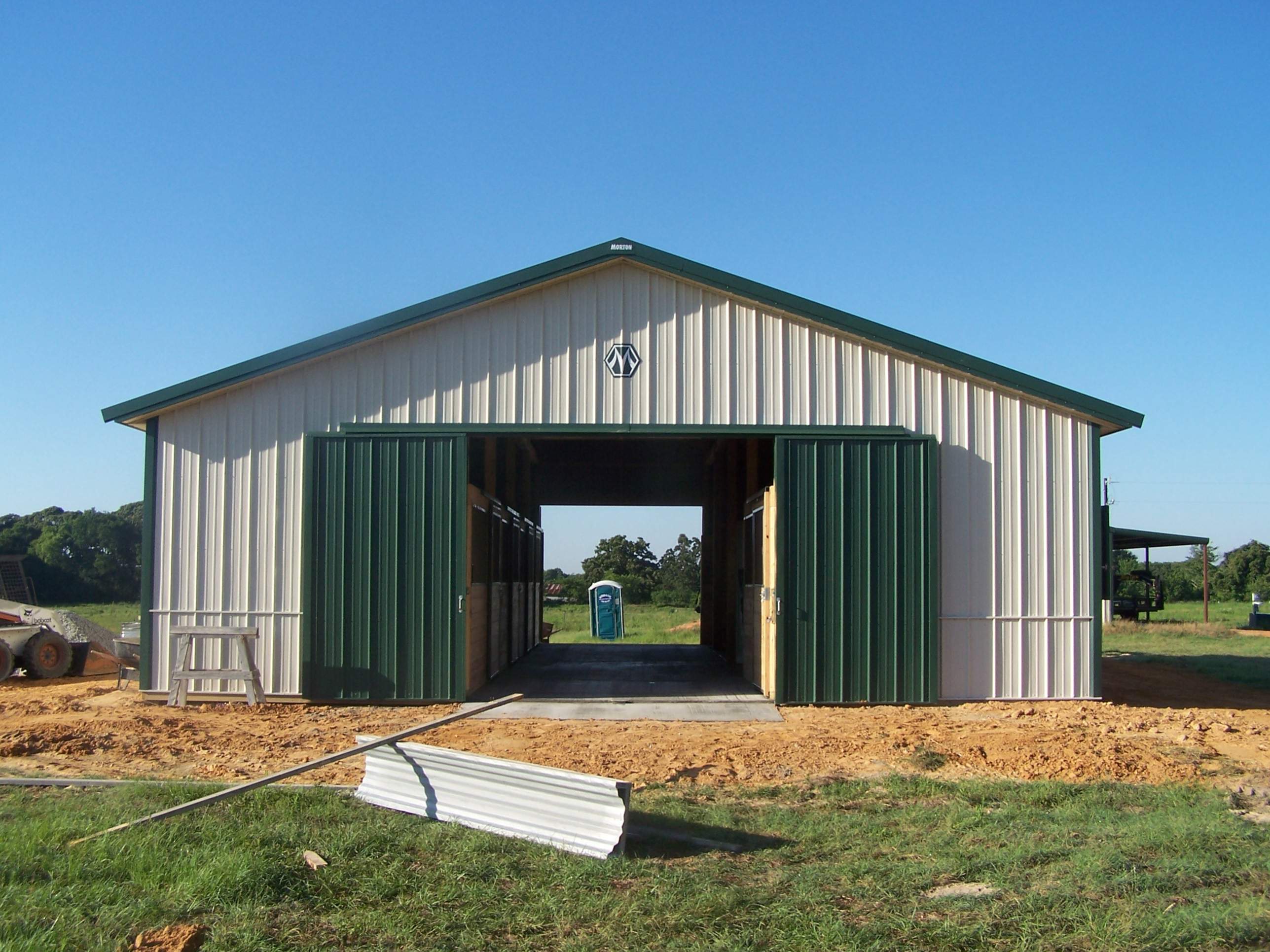

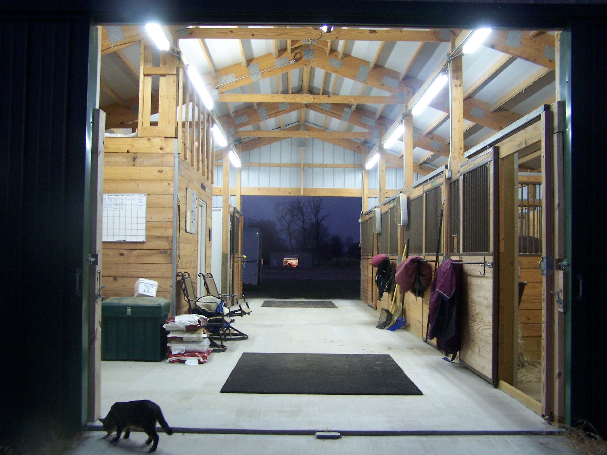

Morton built our stables. They are not cheap but to us it was worth the cost. Going on 6 years without any issues.

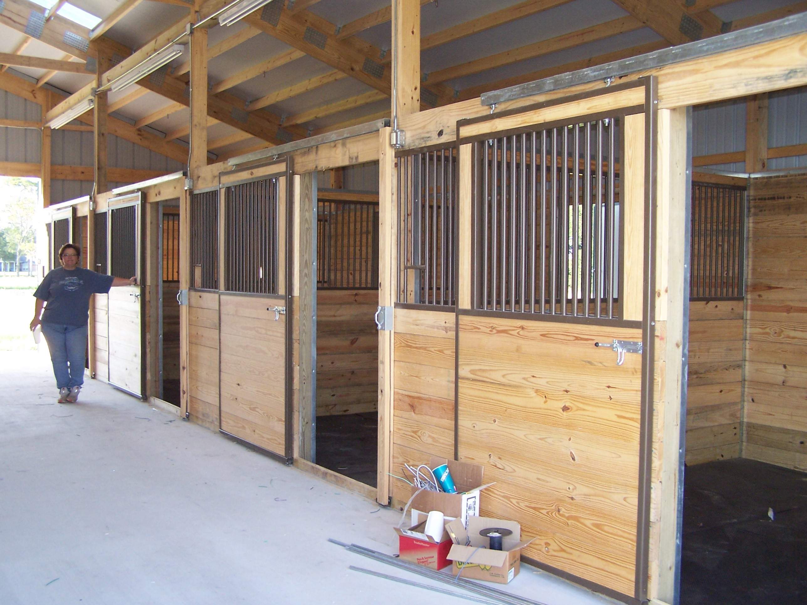

We have a Morton building, 25 years now, no problem. Farrowed pigs, freshened cows and goats, had horses, good ventilation, no rust, no leaks. Withstood blizzards and hurricanes.
