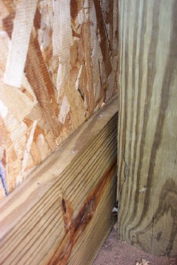

ok I guess I just dont know how to do that /forums/images/graemlins/confused.gif If I can email them to one of you guys can some post them ???
   / Morton ploe barn-How square should it be ???? #30
Here's pic one from Doc
