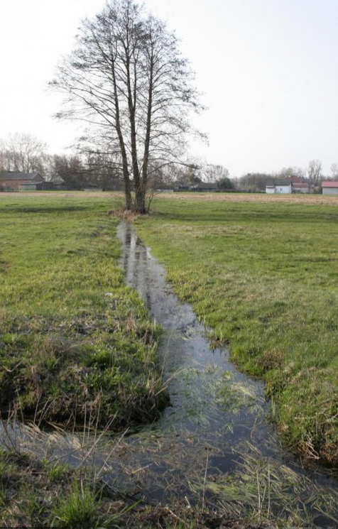

Definitely need some pics of the area.
When the state is probably not "diverting" water....rather the pipes under the road bed simply allow the water to pass under the road instead of over it. When they build up a road.....the road bed becomes a dam. The culverts simply allow water to flow as if the road wasnt there. Because as you said.....water runs down hill. And if the road wasnt there, you would have the same issue.
The first thing that comes to mind is what we here in ohio call sodways. They are gentle sloping swales about 30' wide and follow the low lying areas that water likes to flow. Then seeded with grass to prevent erosion.
Along with sodways is field-tile. Tile pulls as much water as they can underground and minimizes surface water/erosion. Sodways usually have larger main tiles with lots of smaller laterals tied in to dry up farm land.
These fields you mentioned.....are they farmed? What part of the state are you in?
At the very least I'd try to establish some sodways. A tractor and angle blade can do this. Angle the blade and start windrowing dirt away from the low areas the water runs. I do a bit of ag drainage and field tile here in the central part of the state.....just curious how far away you might be?

It's not acceptable for the State DOT to simply divert water onto yours or anyone's property, and expect you to pay for water management. Do they have a water easement on your property. If not, then I would contact legal help to petition the State to assist you financially in this water management project. I am only thinking of the excessive and disproportionate cost to you. Because this could get very expensive, to manage water runoff in these high volumes and avoid serious surface erosion issues.
Perhaps diverting the runoff to a nearby surface tank/pond to hold and retain the water during summer months, while it recharges during late winter melt and spring rains. These ponds can often be built with a bulldozer in a week long effort, and hold 300,000 gals or more. You will need to get a reasonable estimate of runoff in gallons, if you decide to go the pond option, because that will control the size of your retention pond. Such a pond can be lined with impermeable clay for year long retention, or permeable compacted sand for allowing ground water recharging.
Honestly, any flow channels you build should be lined with concrete to limit surface erosion and insure long term operations. And that's where the costs go up significantly.
I completely agree with you the issue is we’ve contacted the state they said they could basically do whatever they want, and any lawyer we talked to didn’t have much of a solution.
the closest solution we got from a lawyer was that his argument would be to have the state compensate us per acre for the land effected by this, but then we were running the risk of the land being classified as wetlands, which it’s not and which we wouldn’t want either.

You dug 1600 feet of trench by hand?
i did. That’s how determined i was to fix this issue. And i had to do multiple passes.
my plan was to Do it by hand first (bc we were worried about a machine getting stuck) then hopefully w the trenches made it would dry up enough to get a machine out there like a TLB and do a better job. That’s where I’m currently at.
Im going to take pictures to get them all to you
   / Most cost effective way to divert water #15
I suspect LD1 has it correct, the water would probably flow that way if the road wasn’t there. I’d would just build better ditches.

I see what your saying ... i'm going to draw up some diagrams and show you guys some pictures.
What you're saying about the water flowing that way is probably correct in a way, however accross the road is another farmers field ... and he has swales going directly to the road, which then run along the road, so he basically channeled the water to the road.
We live on a deadend, kind of in the middle of it, the houses before us all have drainage ditches that run along the road, but then it stops at our property and we are the ones who receive all that run off.
I don't believe any field tile, or anything like that exists in these swales the state created.
Is a sodway like a swale? I looked it up but couldn't find any pics.

First of all your local county and road commission have the full right to send drainage water basically wherever they please. For the vast majority of roads and areas, this is just a certain amount of control over the natural drainage patterns that already existed beforehand. They cant make water go uphill, obviously. And unless they just recently made major changes to this that affected you, I can't see a shred of legal standing that you would have to compel them to change things.
My property is also the low spot that receives all the ditch water from my northern neighbors. I'm not thrilled about their garbage water and run-off coming into my forest, but what can you do. There is also a culvert under the road at the same spot that sends the run off from the ditches across the street! They just replaced the culvert with a nice new 2-footer, and left the shiny galvanized end sticking 4 feet out of the dirt bank. It shoots water like a cannon when we get a monster rainstorm.... not real awesome.
If you dug trenches by hand that were able to re-direct the water effectively, then you are in good shape. There's no long term detrimental effects of ditches to channel water, IMO. Unless they are eroding badly, just let 'em do their thing. Or for a less intrusive and more aesthetically pleasing solution, use a tractor to carve swales in the same spots. Just like the video posted above. Done.

If there’s no long term effects then I’m totally cool with what I’m doing now. I haven’t seen much erosion and it’s been like 2-3 years
