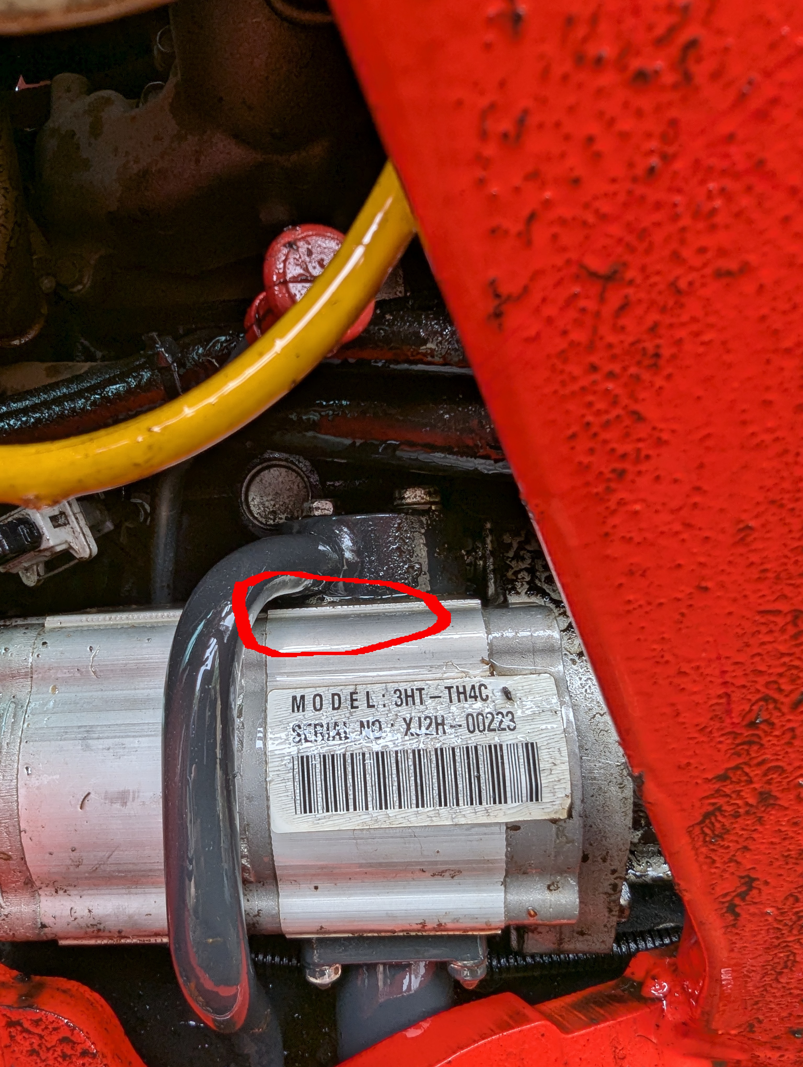

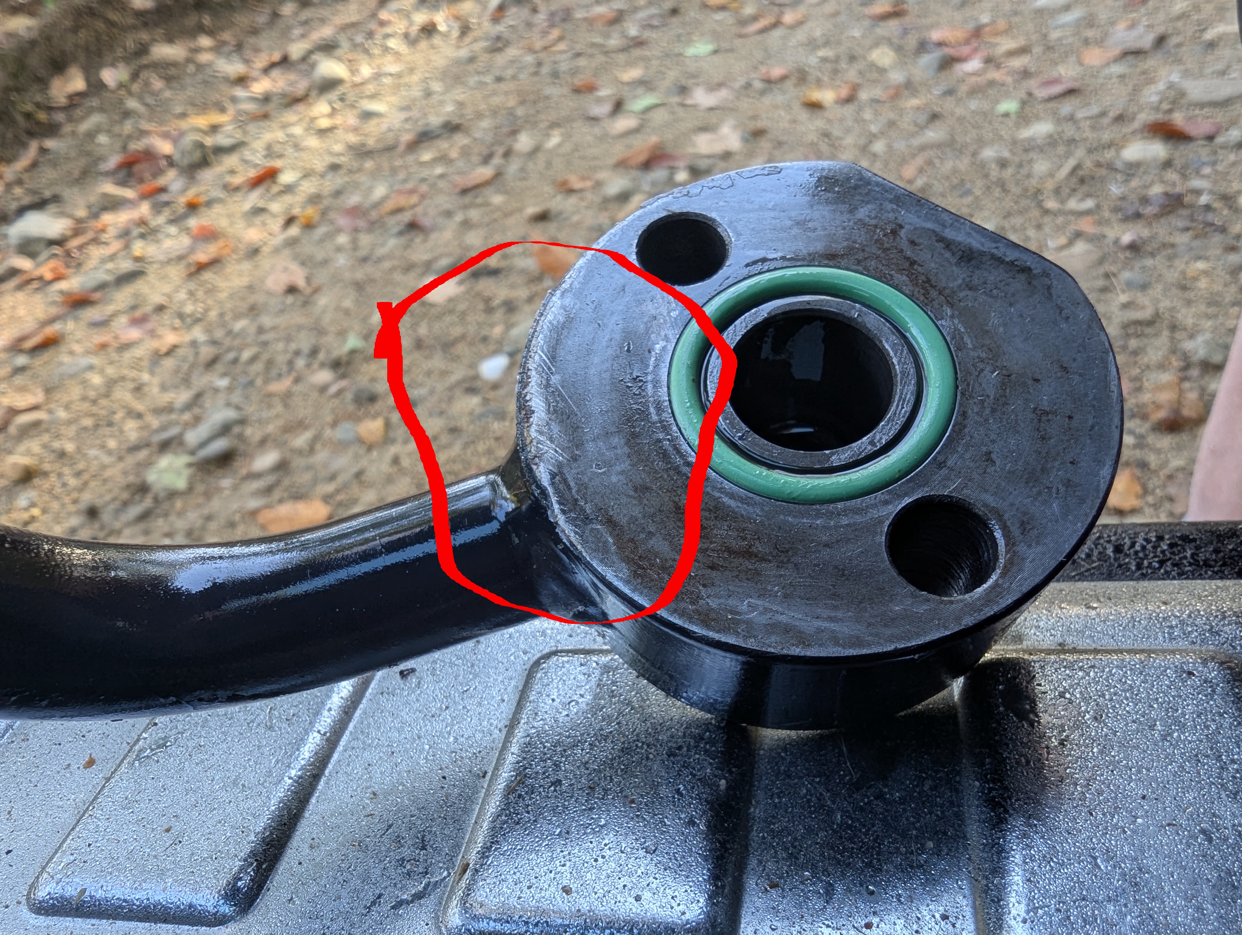

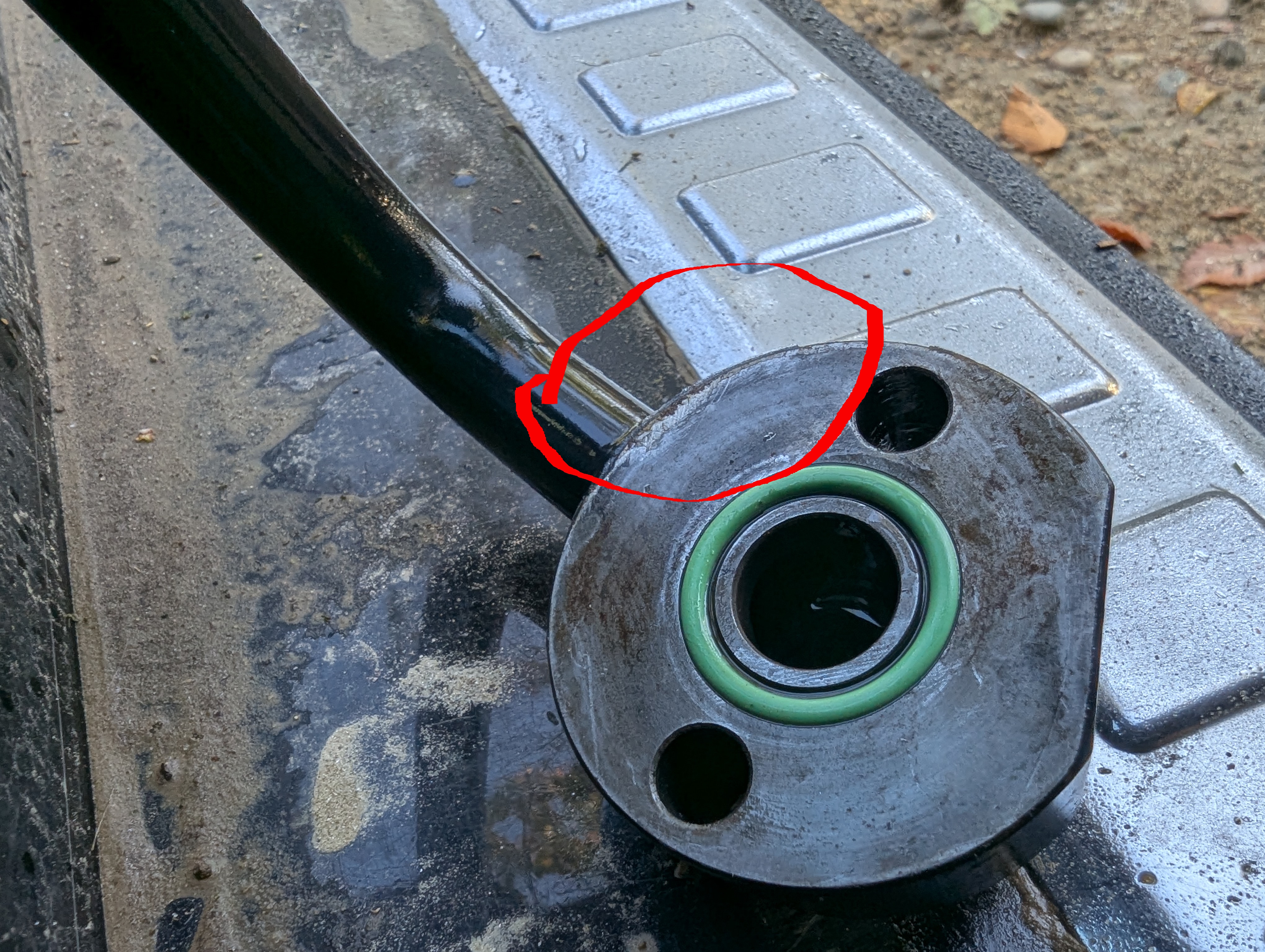

I called a local tow company. $95 to load and $5/loaded mile. Turned out to be more than the dealer. Anyways, took a gamble and bought a $124 rigid hydraulic line since it looked like the original had some type of abrasion. No idea how you get an abrasion but it was there. I never removed the line before. I think it may have been there and the heat (from no coolant), from the hydraulic fluid, may have exposed the weakness. New line fixed the issue so I won't need to have it towed.....this time. Attached an image in case you are interested.
Glad you got it fixed. Are you sure it wasn't just the o ring leaking? The ring pictured does look okay but on that type of seal it could just have been the ring. Just a wild thought/guess.
The o-ring was replaced. It leaked the same way. I replaced the line and the o-ring and it is fine now. Maybe it was the o-ring but I just don't know. Maybe I should have swapped it out a second time.
