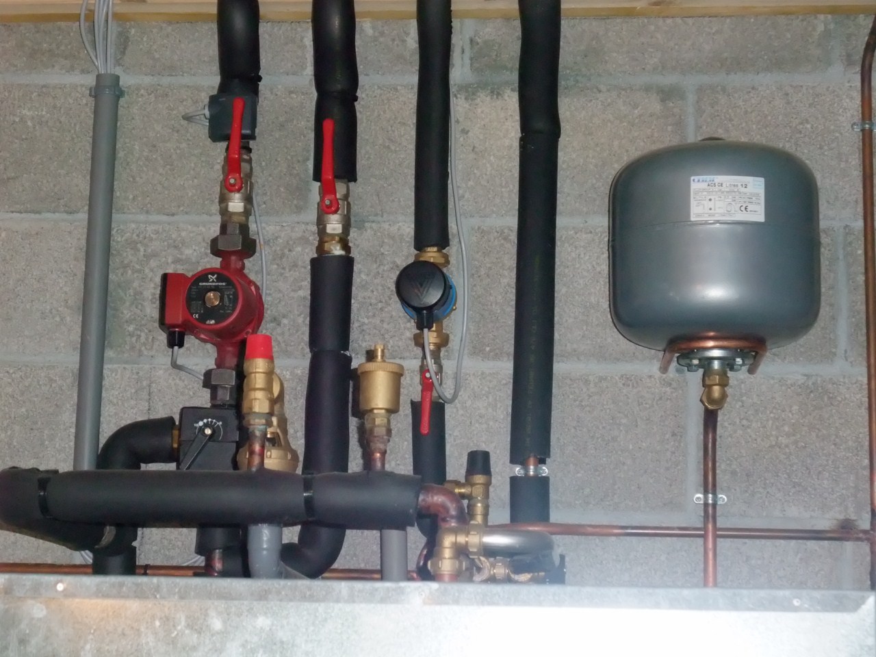

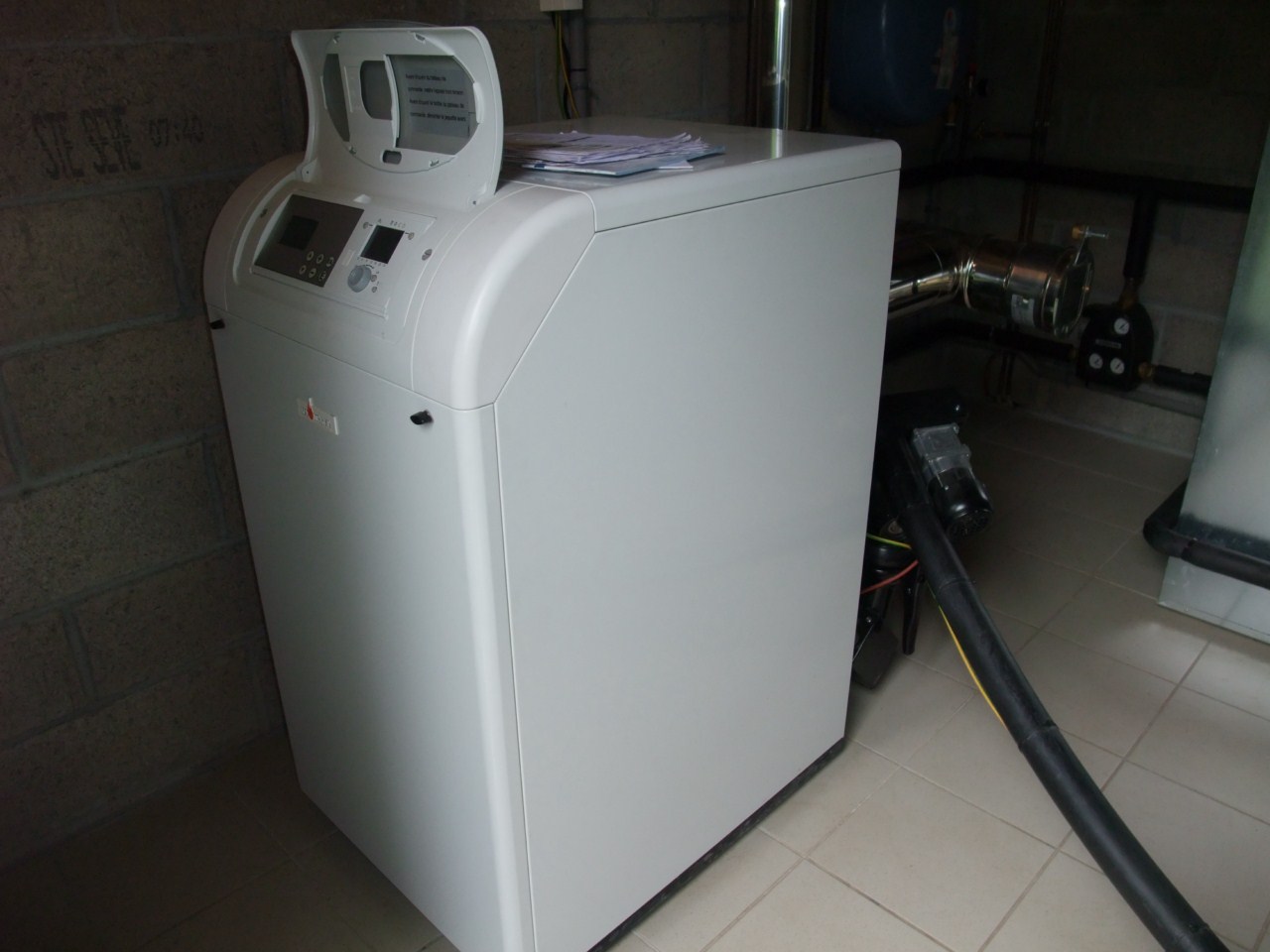

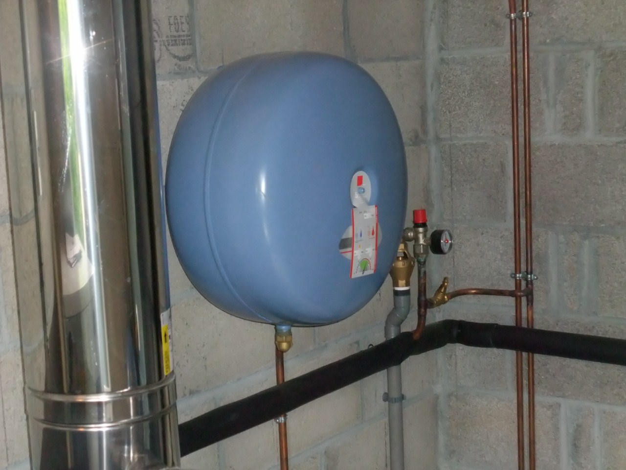

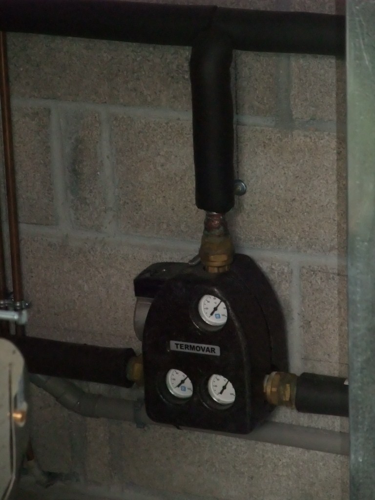

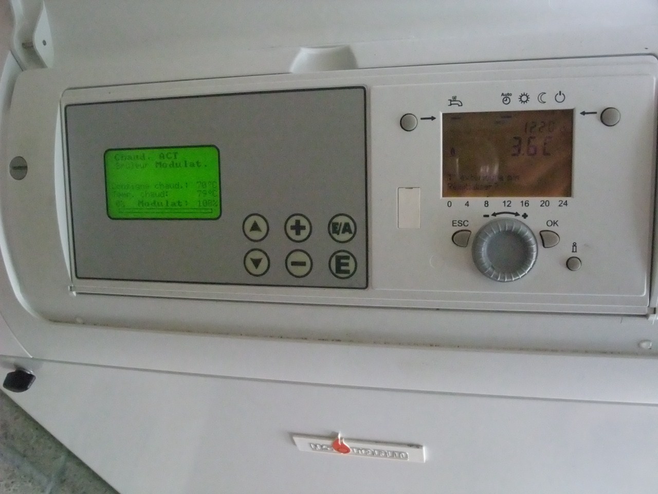

MY PELLET HEATING AND HOT WATER : To go into detail, pellets here are bought by the metric ton (1.000 kilograms). Delivered in bulk and blown into your silo they are 250 euros a ton (cheaper and no trouble at all, except there is sometimes too much dust with the pellets and you risk stalling your feeding system). Delivered to your door in 15 kilos plastic bags they are 310 euros a ton (more expensive and you have to take them yourself through the house to the silo). I burn approximately 2 tons a year. To the price of pellets you must add a little electricity to run the system and have the burner and chimney professionnally cleaned once a year.
Pellet burners have an extremely high efficiency provided they are run at full capacity all the time. So the principle is to heat a 500 liter water tank from which the system can then draw calories for heating or hot water as needed. Two computers are used, one to run the burner itself, the other to regulate temperature according to the day of the week, the hour of day, your mood and so on (I personally appreciate the program cycling hot water when we generally need it so that it immediately comes hot out of the tap without having to wait for the tubing to empty itself).
The black tube on the floor in picture one is the screw bringing the pellets to the furnace when required.

You guys are way ahead of us in bulk pellet systems, but there is some activity in that market.
Maine Energy Systems offers alternative biomass energy through automatic wood pellet boiler heating and bulk pellet delivery.
Your 250 Euro per (2,200 lb metric?) ton is in the same neighborhood as pellets by the 2000 lb ton in 40 lb bags here. I see prices here ranging from $180 to $240 per ton--you haul.
