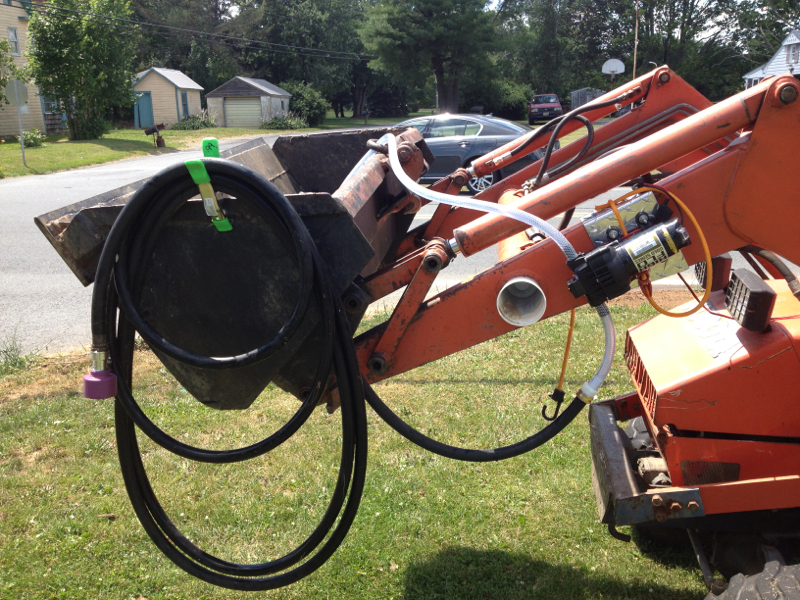

I upgraded the whole system. Got rubber lugs for the holes. Mounted a 2.6 gpm pump and refined the whole thing. Works great!

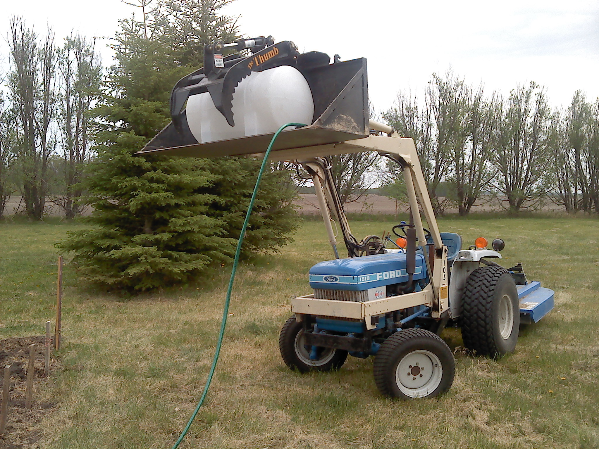

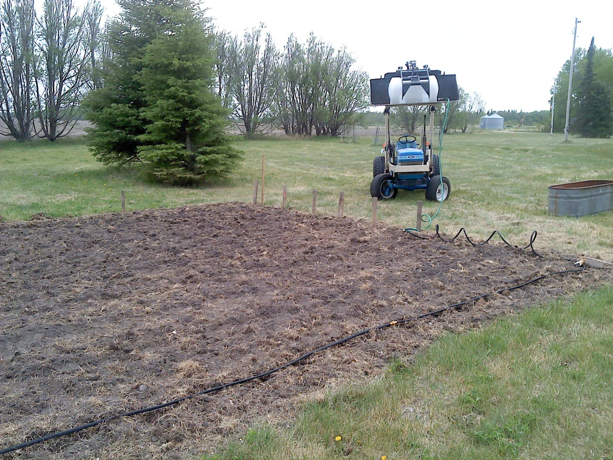

I have a 55gal plastic drum set up with a hose bib. I either put it in the loader or RTV when remote watering. The loader works better because it siphons quicker with more height.
I've done something similar with a 32gal tank and soaker hose. I'm buying a 12v pump as soon as it comes in the local Fleet Supply. They are out at the moment, but are very good at ordering anything I need. Meanwhile, gravity works. Slow but effective.

My pump was $90.00 at tractor supply company. It took me about 15 minutes to bend up the bracket to hold the pump. I did realize I have to scale down the hose diam to get more pressure and distance. It's a work in progress
   / Most expensive watering can I've ever seen #17
I would recommend you keep the hose size larger to minimize friction loss, add a proper nozzle on the end for the spray pattern of your choice.
