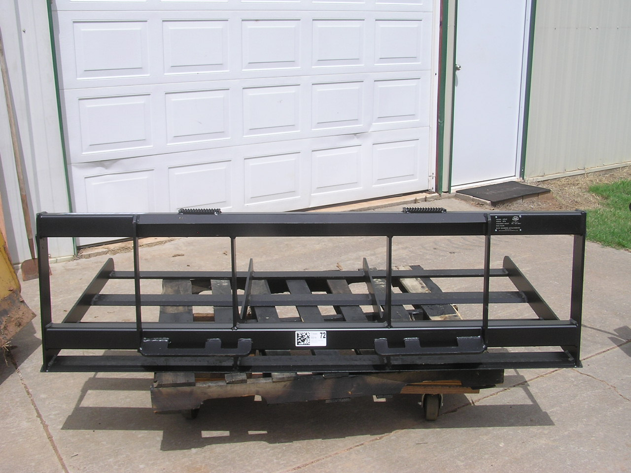

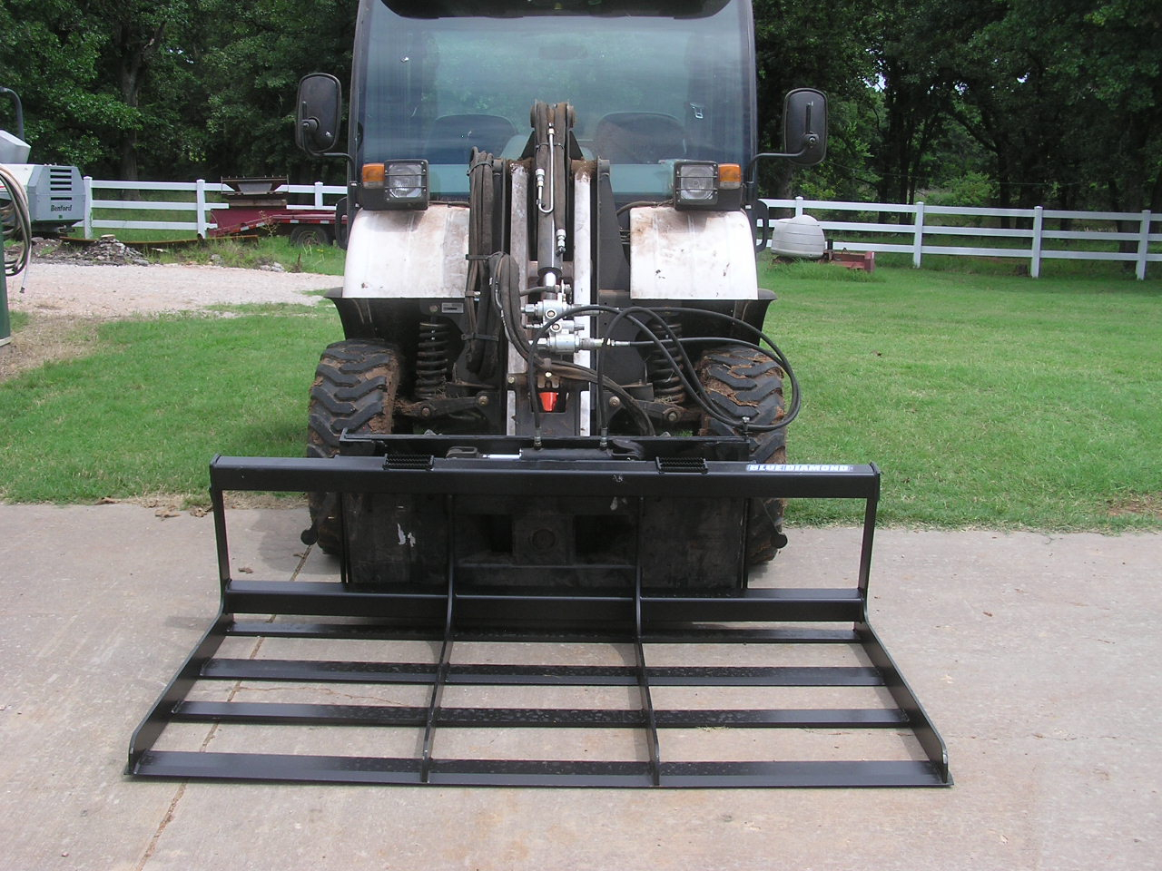

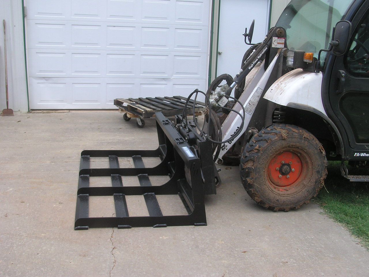

I've been thinking about a land plane for attaching to the loader.
Look at landplanes made for skid steers, that is what I have made by Blue Diamond:
   / Most useful implements? #165
Yeah, the ones I have seen look more or less like this one. You have to dump/curl to get the whole thing to contact the ground, and there's no adjusting angle of attack. I'd like to make one that pivots to follow the ground, and lets me use dump/curl to adjust the angle of attack simultaneously on all the cross pieces.

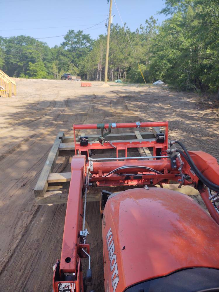

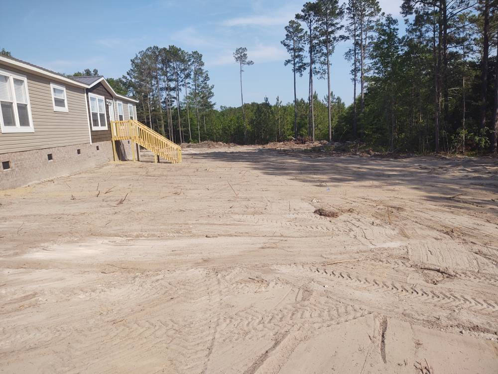

The loader mounted plane, drag, whatever you wanna call it worked beautifully.
Roughing in. Wish I would have taken more photos before I started.
What I found was that if I set the loader in float, and back drag, I could control what it does with my tilt. Tilt back so the edge near the tractor cuts into the hump (s) and it would really do a lot of cutting. Tilt forward and it would cut more mildly, and/or allow some of the dirt building up in front of it to move under and be distributed and deposited to build up. If things were already close just tilt pretty far forward and back drag for a quick smoothing. It's very useful for pushing and smoothing where that is necessary too. That requires being careful and close attention to tilt adjustments for desired effect.
I worked top to bottom then left to right. Since it can only float in one plane on the loader, this would leave lines on the side of the plane left to right doesn't match up perfectly. So, after working it in on the loader, I unhooked, chained to the rear, and made a quick pass over everything dragging it. I don't have any pictures from after pulling but I go back this weekend to work some more. It worked really well and I was quite pleased for the $0 investment and ease of use.

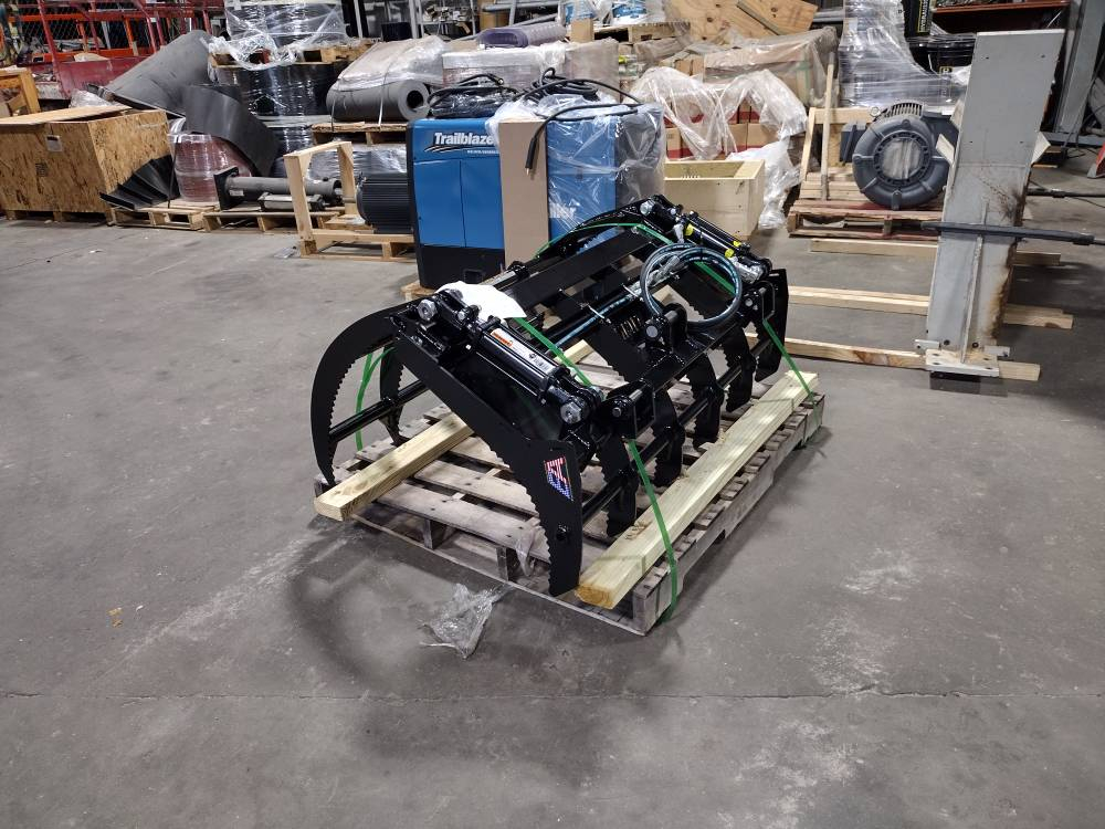

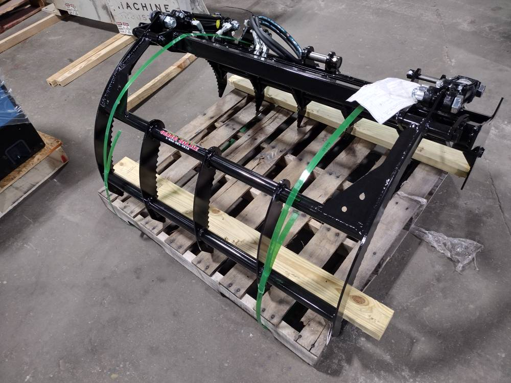

grapple is my best friend, grabs almost anything ... not always gracefully though :)
