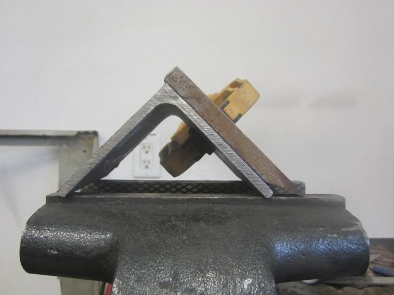

I cut the zamboni blade. Make no mistake, it was in the "Dull" pile, but it's still sharp enough that you wouldn't know you'd cut yourself until you saw blood
Here's what it looks like with some end pieces

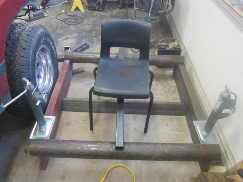

Got Colin's chair from work! :)

You might want to make a bench seat if those jacks are top-wind.
Side-wind jacks might be reached from a center seat, but the top-wind are going to be hard to operate from one place.

I gave it a "test drive". LOL I put the jacks on the floor, because basicly the seat will sit 1' higher, and so will they from the floor. It wasn't bad at all. They're probably 6" out each in the last pic then where they'll be in the finished product.
So two questions;
1 Sould I make the tongue be able to pivot at the front of the plane, then rigid with a pin? In order to raise the plane with the jacks it needs to be rigid, but i'm worried it won't be able to follow the countours of the ground being rigid. I guess a mostly level surface wouldn't matter, but once I hit the trail it may not work as well.
2 I planned to have bolt slots on the angle iron to allow adjustment for the blade... but I see alot use plate at the end of the angle with different bolt holes on the runners. What should I go with and why?

NS Gearhead said:
So two questions;
I guess you mean pivot up/down or front/back, not left/right.
I would say you could keep it ridgid if your skid surface is short. It may help it work more like a motor grader. If the skids are long, then let it pivot.
If the slots are strait up and down, hitting a rock is unlikly to make the bolts slip. So slots on the skids would prevent that.
But to adjust for blade wear, slots on the angled mounting surface would be better. That way the hardened blade could be moved down/forward by itself.
