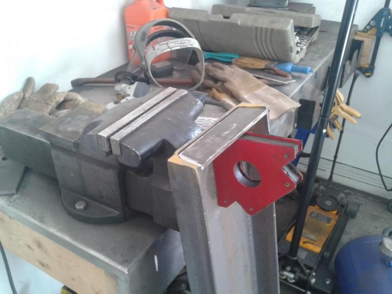

So, meant to get the four pieces welded together... and cleaned everywhere I was going to weld... then decided to cap the back ends of the channel iron. LOL Got this far, then it was time to get the girl from daycare
I also weighed what I've got so far in an attempt to know how much this will weigh once done.
Channel iron; 43Lbs x 2= 86lbs
Pipe; 40lbs x 2=80lbs
Angle iron/ blade/ bolts; 47lbs
Caster & Jack; 19lbs x 2=38lbs
251lbs so far!
Still have sand, tongue, bracing, chair, expanded steel... should reach 300lbs.

I don't say this negatively, only an observation. If it cuts well, you may not be able to pull it. Not knowing what your ATV is raises my concerns. :)
   / Mostly scrap built (but still awesome) land plane
#70
Oh, I know it may not cut it. She's a Sportsman 570. 700lbs, AWD... I also have tracks coming for it that will add another 300lbs and reduce it's gearing by 40%. Plan B is my offroad only Tracker; 2500lbs ish, but open front and rear, and geared terribly. Next year we'll be getting a small SUV... Rav 4 or CRV... something like that... that could also be a possibility. Absolute worst case; I borrow a buddy's 1/2T Chevy.... although it won't make the trail that I someday hope to use this on.
