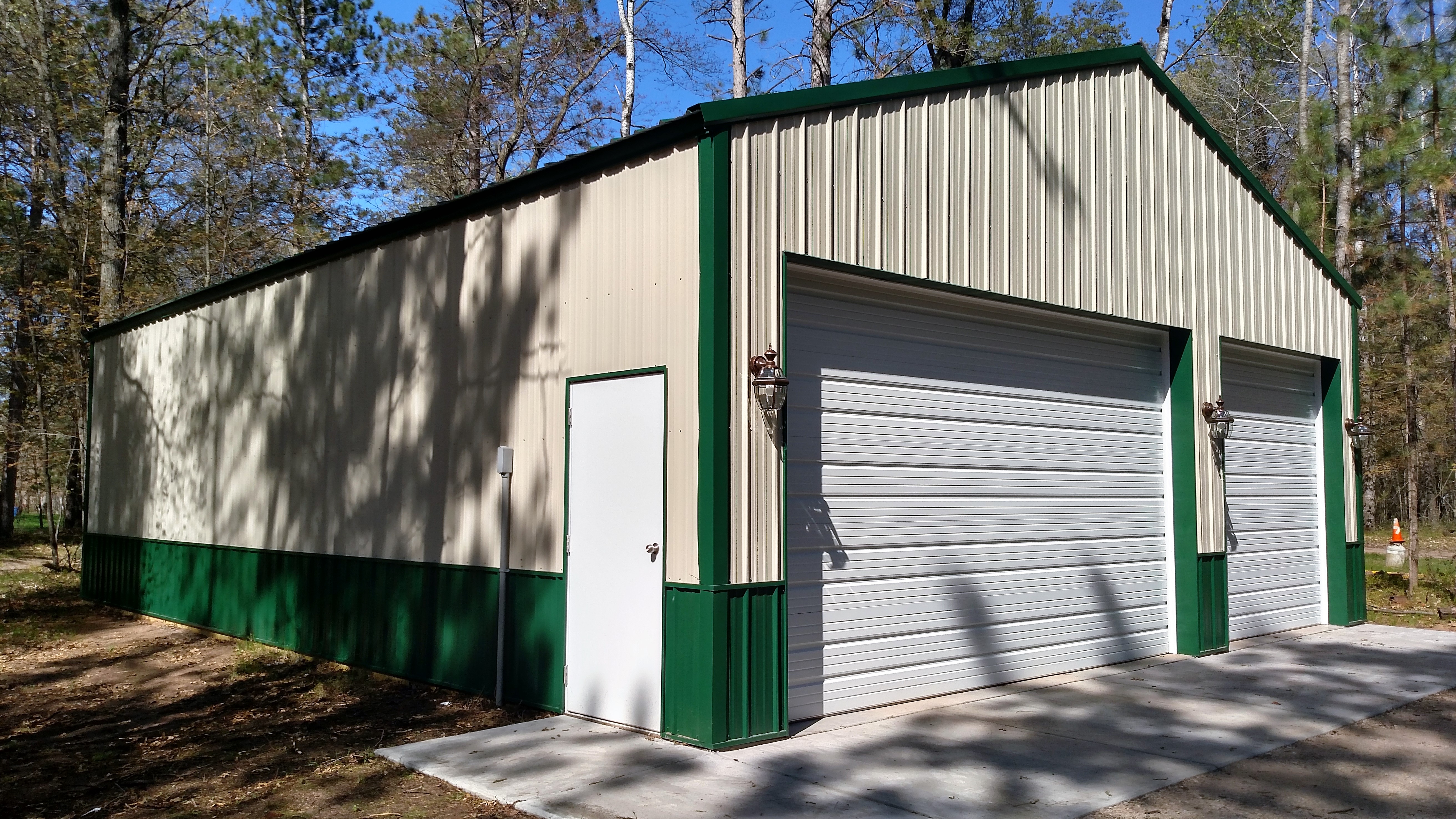

I just built a 30x40 pole building. Cost about $1k more than going with Menards, but I felt better quality materials and better quality contractor. I had about an additional $1k in electrical materials (100 amp service, wire, outlets lights, etc.)
30x40 Garage 10' 6" Walls - No Overhang
Wainscoat
9x9 & 16x9 Garage Doors
3' service door
Pole Bld Materials and labor ......12,465.00
Heavy gauge Garage Doors .........1,890.00
Concrete @ $3.75/ft sq ft.............4,500.00
Site Prep (stumps, fill).................1,525.00
Openers.......................................700.00
Total..................................... $21,080.00

Do you have a picture of the finished building?

I gave you my figures so at least you have one benchmark. I picked my builder because he used laminated posts (no warping or twisting) and heavier truss rafters (snow load). Building was up in 3 days! If I were you, I would:
  1. Go to local lumber yards for referrals or quotes
  2. Drive around and ask pole building owners who built theirs
  3. Ask cement contractors who they recommend
  4. Put it out on Facebook
