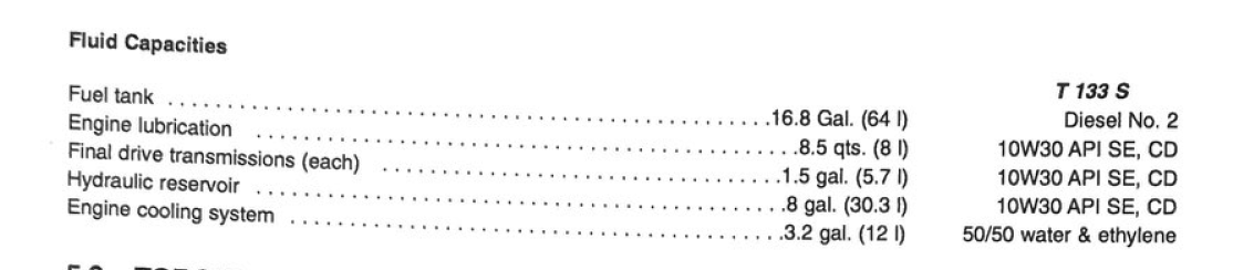

Earlier you asked if you were overthinking it. My answer would be yes, you are overthinking it. :)
If the manual calls for 10w30, any modern 10w30 you buy at Autozone, Walmart, etc... will work just fine.
My current machine is entirely hydraulic. 4 wheel motors, three pumps, hydraulic mower deck motor, hydraulic brush cutter motor, etc.... and it's had 10 gallons of 10W40 as the hydraulic fluid from the factory since 2001. I change the hydraulic filter every 50 hours and add a quart of make-up oil at that time. Seems just as strong as the day I bought it. :thumbsup:
