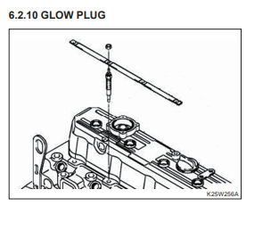

At start up cold engine It pumps out a lot of smoke and there is an engine clunking maybe louder ticking noise. After 15-20 seconds all sound normal Smoking is done.
Just started in last 3 days.

What color is the smoke?
I'm leaning towards bad glow plugs not working properly, which would cause the smoke for a couple seconds. The noise could be related since it's not burning quite right.

A Branson 4720 is a 4 cylinder. The glow plugs are on the left side (looking forward) of the engine. Here is a image from the service manual that shows one:

The glow plugs have wires connected to them. The fuel injectors have pipes connected to them.
Does the glow plug indicator on the dash light up when you turn the key? Then go out to tell you it's time to start the engine? There's a fuse and a controller for the glow plugs. If the fuse is burnt out or the controller is not working, none of the plugs will work.

So Did the test . Meter was .2 ohms . With metal strip removed terminal to ground was .8 ohms .8ohms .8ohms and 6meg ohms.
So I have a bad glow plug. Do I replace all them ? or just the one. Seen on line where they say to do both. Change them all or just the bad ones.
I would just replace the one, I'm cheap.
with 2000 hours depending how many starts it's questionable.
But I'd just do one might buy 2 to have a spare with winter coming on.

I was right not going to be cheap $38 ea bought 2 one for a spare. Installed and running correctly again.
The bolts that hold the buss bar on were a pain to get on . Especially the back one nearest the seat.
