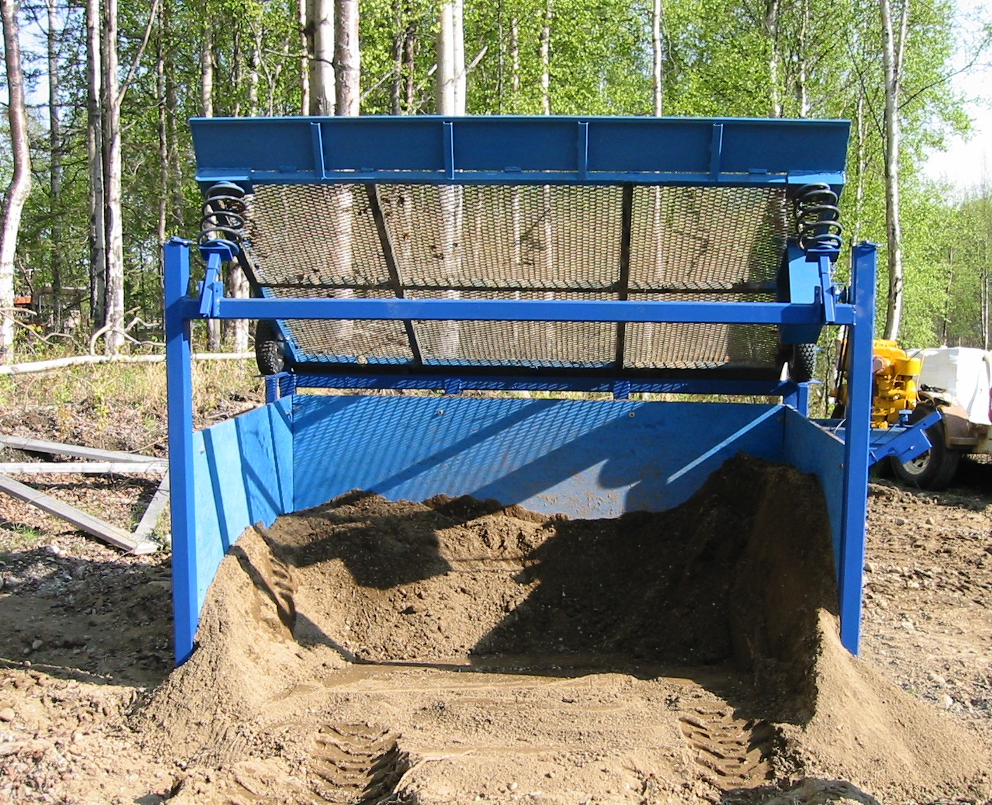

I used Ak's basic design, which I think is the basic design for most of these rigs. My BX's bucket is just under 48" wide, so, I made the screening bed 4 feet wide x 6 feet long. Was originally going to use a full 8 feet, but it was just too long. Hopefully the 6 foot length will allow most of the screening to take place before "waterfalling" off the end. I was looking for the most vibration at the shallowest angle for the most efficient (full) screening of the material.
Features:
-The Back (loading end) and Front (waterfall end) height are both adjustable.
-Used ATV coil springs.
-Interchangeable expanded metal screens, with abilty to overlay hardware cloth for finer screening of compost, potting soil and such.
-Sliding/adjustable motor mount for maintaining proper belt tension.
-Honda 5hp G200 motor with quiet muffler.
-Flywheel is 3/8" thick x 2" wide-orange (Yes, it will get a guard)
-Side Unloading of screened material
-Waterfall end will get a plywood divider.
-Will use small wheels and hitch for towing behind tractor. (soon, soon)
It has been test-run in the workshop a few times, needs wheels installed before it can be taken out for it's first real screening. (next day or two hopefully). It really scoots across the concrete floor in the shop!! :eek:

By eyeball observation, I get the impression that most of the metal framework is in the 2" range (ie 2 x 2 angles), if so with a full bucket load shaking and vibrating, will that be strong enough? or will it bend under load?
For sure a larger unit needs heavier metal!
If I were to place 2" (like 1/8 thick) angle stock between 2 concrete blocks and jump on it for sure it would bend over a 4ft span.
I have seen a few home brew screens around and the folks tend to use fairly heavy material, true they load with bigger case backhoes and full bucket loads.
   / Motorized Dirt Soil Screening Machine #64
The screen I have is 8' wide by 5.5' it was something I already had I didn't build it for this purpose. For my tractor (72" bucket) the size is about perfect, the problem with a long screen is you have to compromise, the longer it is the more you have to compromise, either the angle has to be flatter, the area (inside and behind) have to be smaller i.e. shorter runs between clean ups, or you have to have a ramp to get high enough to dump onto the screen.
My screen frame is built with 1.5"x 1/8" sq tubing, with minimal interior bracing that is a little light "Skunkwerx" used more interior bracing, a much better design. I routinely dump full buckets on the screen and that isn't the problem, its vibration induced cracking has been the problem. Also expanded metal isn't very tough with large unsupported areas rocks will dent the screen making it harder for the vibration to clear the screen especially when screening material with sod clumps they tend to "hang up" in the rock dented areas.
When I build one from scratch, I plan on building a fairly heavy duty frame (1.5 x 1/4 Sq tubing) with replaceable screens .750 is a good size screening topsoil and have made some sand, however I would like to make some < 2 pit run and some real fine sand, so I will need interchangeable screens. I like the overall size of the one I have so I will probably stick with the same size. I also plan on running a cross shaft so that I can run a counterweight on both sides of the screen, I think that will be a little more efficient on the wider screens.
Anyway just my thoughts, i added a pic so you can see the differents between "Skunkwerx's" screen and mine. again if you plan on using expanded metal I would use a design closer to his than mine.

A lot of good questions.
I used 1.5" x 3/16" square tubing, plenty stout for the frame.
Bracing and gussets is a good idea for the long haul.
I agree with AK, the expanded metal needs some other support, especially where you droppnig the loads. Also, consider your angle, the flatter the screening bed, the more support.
I used a grid of 1" angle underneath the expanded metal to keep it from bowing under the weight. Mine is 9 ga. also.
The 6 feet of length is plenty to screen 100% of the material.
The 3/4" expanded is a good size for making topsoil. It will allow, at most, a 1/2" piece through, no larger. Being a gardener I wouldn't want any smaller for planting. Very fine soil would compact too densely and become problematic.
I also got a piece of 1.5" expanded metal and used it first. It's good for cleaning fill dirt where you aren't worried about a few small clods falling through. So, if you were looking to screen rocks for drainage, or just clean out some dirty fill dirt, A piece larger than 3/4" would be the ticket and would be faster.
I'm finding the 3/4" is the one that is staying in the machine, for now.
I've been screening composted material, mostly, so far.
Good luck with your project.

Bob,
Counter-weight on both sides is good idea, since your screening area is wider/larger and carrying a heavier load.
With your topsoil/loam material, it sounds like you will be OK dumping directly onto the 3/4" exp. metal. When placing your bracing underneath, just keep in mind a little extra in that are won't hurt. If you are gonig with the 8 foot wide by 6 foot long screen bed, it sounds like you will have a 2'x8' peice leftover?
Suggestion: double up the top 2 foot section where most of the dumping will occur. by welding the pieces together, then place your full 4' x 8' sheet at the bottom, run off area.
Alternate idea: Make a grate out of rebar, perhaps 2" opening, and dump into the rebar, it will act to break up the load, and soften the landing onto the 3/4" exp metal.
You can't have too many fasteners. the nyloks are holding, a couple came loose, but didn't spin all the way off like other hardware.
Consider using some flatstock on top of the bed, with the hardware drilled through it, rather than just nuts, bolts and washers. That is one thing I plan to add at some point.
Will you be running a drive shaft across to the other side for the far-end counter weight? I conisdered it. If so, conisider a full length counter weight? Use stout shafting material, and weld a piece of solid square stock to it?
Look forward to your project!
