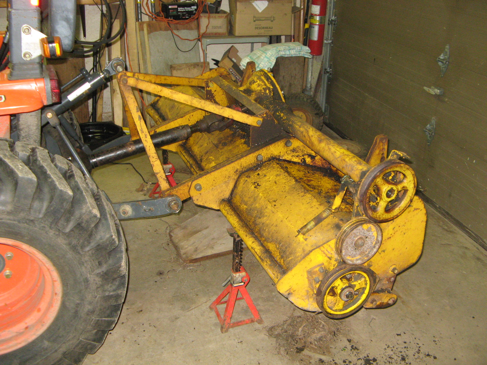

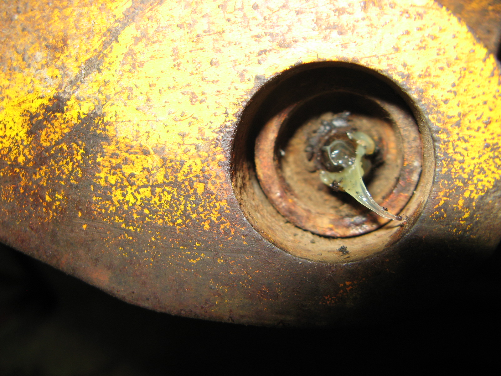

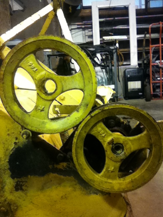

I recently got my hands on a mott 72 flail mower for a great deal (free) but the cutter shaft is seized. I though I just needed cutter shaft bearings but it seems to have other issues. I looked online and am going to contact montage for any info about a parts catalog. this appears to be an older model with the small round roller but there doesn't seem to be any set screws on the the inside of the cutter shaft bearings and there are no set screws on the outside.

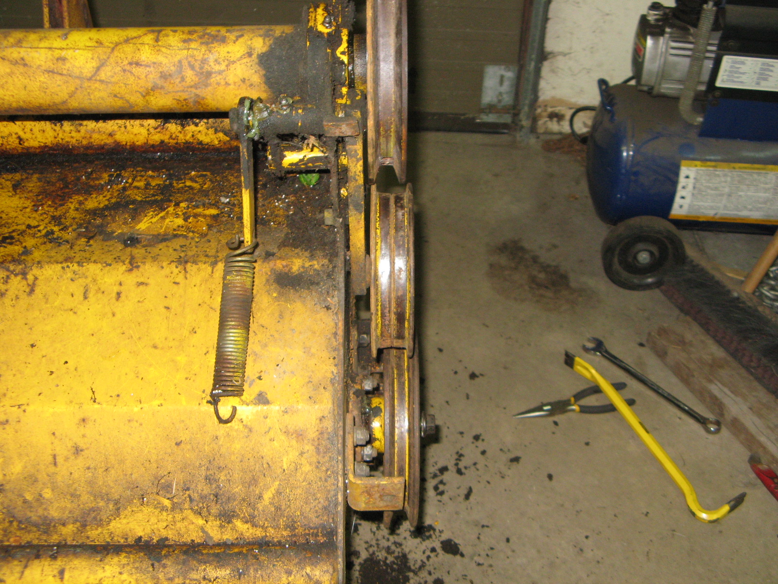

I got the cutter shaft to turn by loosening the bolt holding the drive pulley on the cutter shaft. I was hoping to let it turn at idle for a bit to loosen up the bearings but when I looked a little closer at the pulleys they appear to be out of alignment and at some point in its life (before I got it) the cutter shaft pulley was too far in and rubbing on the bolt holding the roller bracket. Now the cutter shaft pulley is too far out, and when I torque the bolt holding it on it seizes back up on me.
IMG_3488.JPGIMG_3489 - Copy.JPGIMG_3490.JPGIMG_3491 - Copy.JPGIMG_3492.JPGIMG_3494.JPG
If anyone has any info on how to get the cutter shaft off I would appreciate it and I would really like to have some kind of parts catalog to determine if the pulleys are original and what the spacing should be.

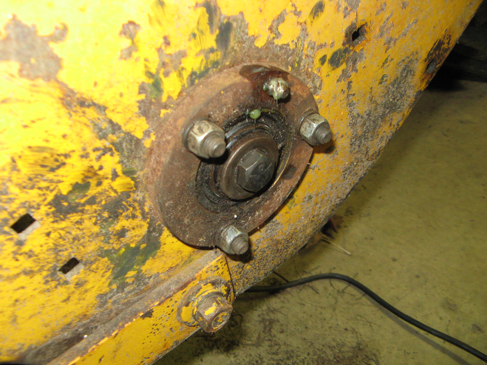

I managed to get the cuttershaft pulley off last night and figured out what was going on. the pulley side bearing on the cuttershaft is seized and the shaft was turning inside the bearing when the pulley bolt was untorqued but when I torqued the bolt it would seize up. hopefully a new cuttershaft bearing will be the right width and will bring my pulleys back into alignment.

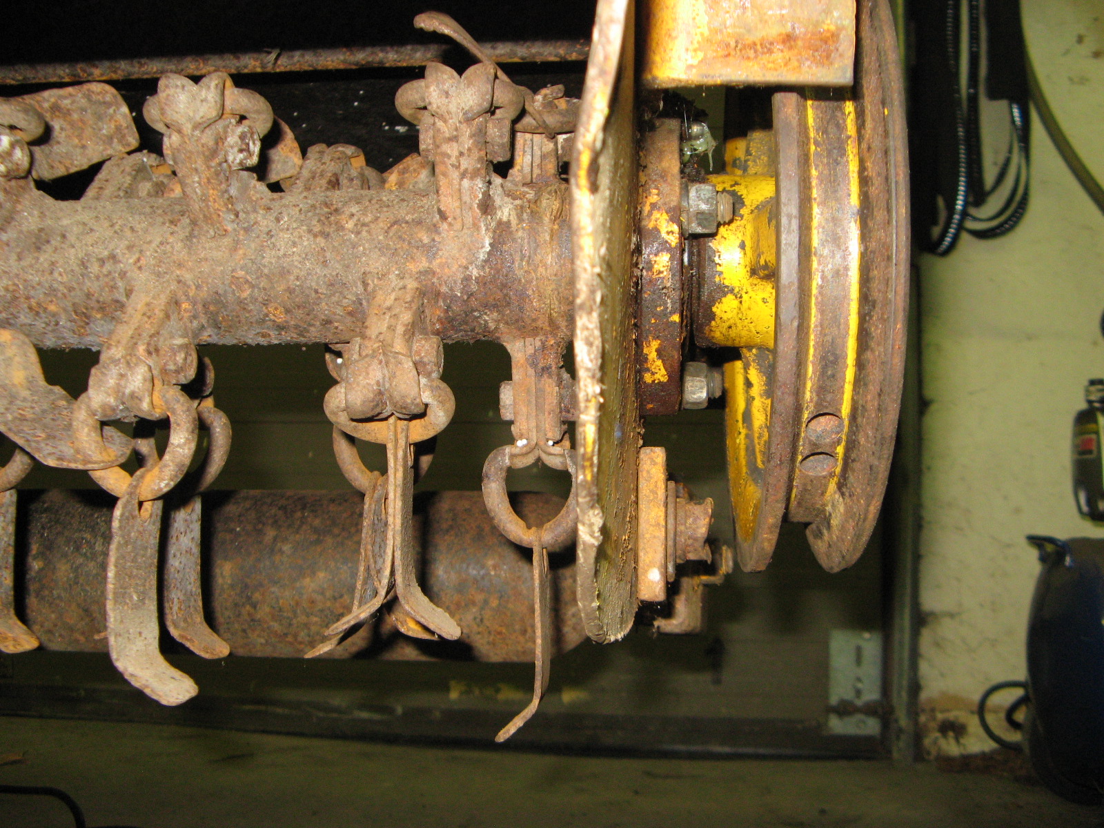

Got the cutter shaft off and figured out what was wrong. the last guy who changed the cutter shaft bearing put it in inside out so the grease zerk was not greasing the groove with the holes in it. so the bearing was running without grease. and it ended up almost a 1/4 inch too far out. a new bearing properly installed and right side out should solve all of my issues. One thing I noticed is that the bearing housing is not the same on the pulley side as the non pulley side.
the pulley side has a shoulder in the recess to seat the bearing against and the non pulley side has no shoulder and mine is currently a loose fit with the bearing so it can adjust to the length of the cutter shaft. I think having the bearing properly seated will correct my pulley alignment problem.

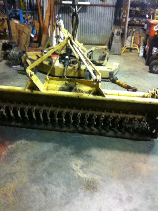

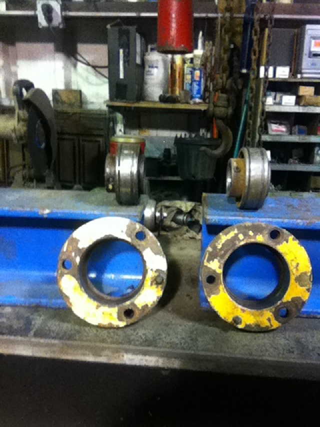

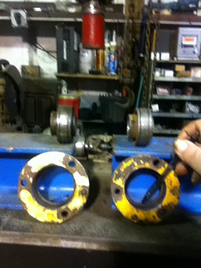

Well this is certainly ironic. I bought an old flail mower yesterday and guess what, it's a Mott 72 just like yours I think. Upon taking the bearings off the (drum, shaft, cutter bar) whatever you call it I noticed the bearings extended side faced toward the drum and the bearings extended side faced away from the drum on the non pulley side. The bearing on the non pulley side had grooves (3) cut crossways of the two grooves that wrap around the bearing that would allow grease from one groove a passage to the groove with the holes in it. After looking at a parts list for an Alamo 74, newer version of the Mott 72, the bearings are turned the same way the extended side faces in toward the drum on the pulley side and away from the drum on the non pulley side. This is real confusing to me but thats the way its designed. I'm like you and thought one of them was put inside out until I checked a little further. The site was Alamo's. I down loaded the PDF file but its just for a little reference and a lot of parts are different and a bit more modern looking.
You may or maynot notice I'm not a photographer:) the picture of the bearings and the housings below them were the way they were oriented when removed. The one on the right was on the pulley side as looking at the mower from the tractor. You have to look closely at the bearing on the left (non pulley side) and you can see the groove cut in between the two grooves that encircle the bearing.
The bearings are the same size and will install either way however they have different part numbers so I guess the crosscut grooves is the difference. The housings on mine are indentical and have the stop for the bearings as shown where I'm pointing with the pen.
Note: The part numbers I mentioned above were from the Alamo site and may not be the parts that fit your mower. I was just noting they have different numbers for each side and the PDF makes a point to address which way the bearings should be installed. I usually buy my bearings locally rather than through the manufacturer and if the width is sometimes different I use spacers or bushings for shimming. Washers don't make good spacers for bearings and you can buy the right size spacers from places like Mcmaster Carr. 99% of the time I can get the exact size bearing but some old junk I work on might need proping up a little.:)

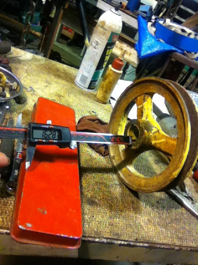

From your picture above it appears the two pulley's are a different type. It's kind of hard to tell but the spokes of the drive gear pulley are rounded and the spokes of the drum pulley are more squared off. Of course this wouldn"t matter but you might want to check the distance through the hole in the pulley. My two pulleys are identical with the same numbers stamped on them and it measures 1 5/8" through give or take a few thousandth's.
You may already have yours up and running just thought I'd share this info with you.
