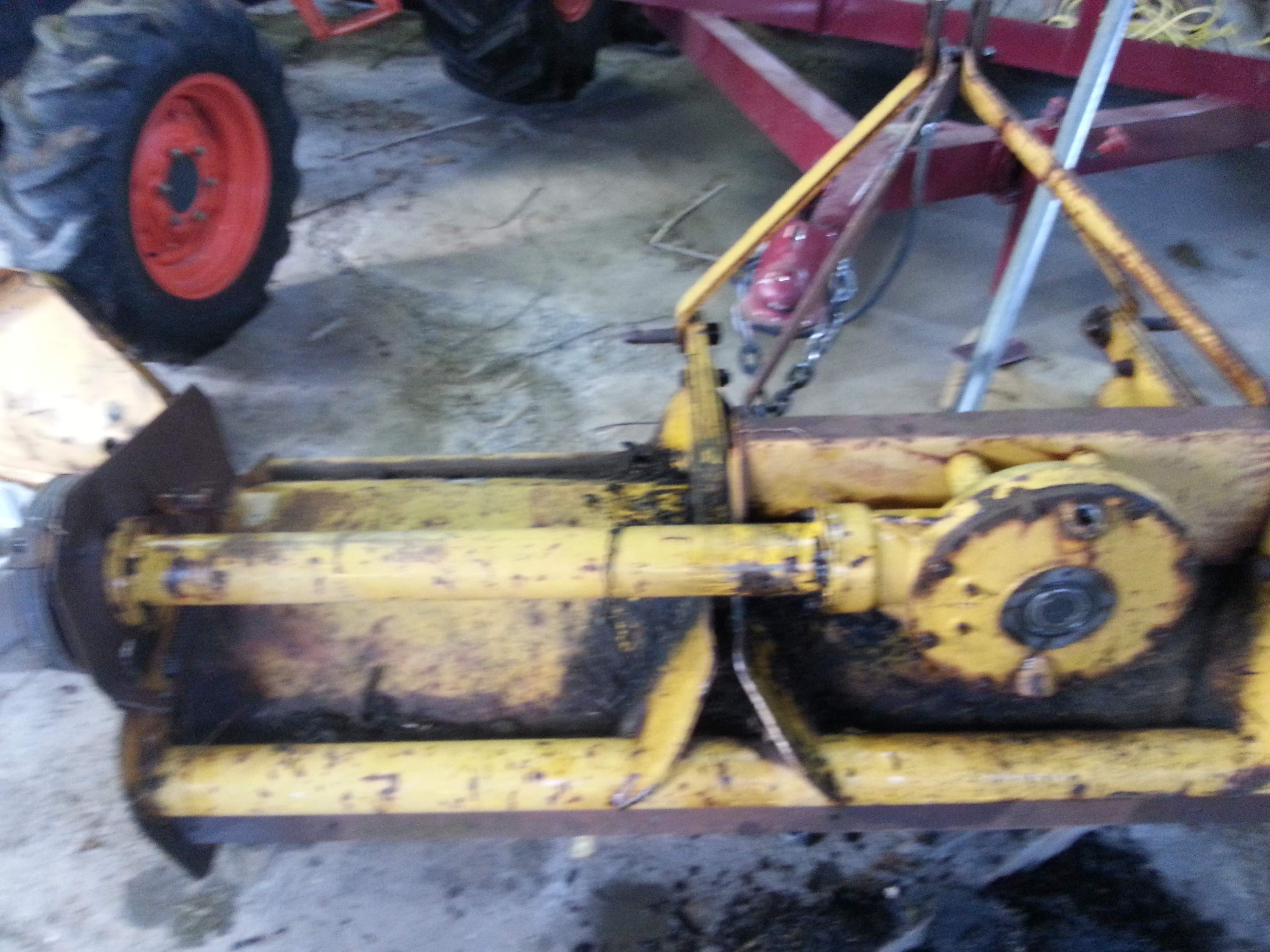

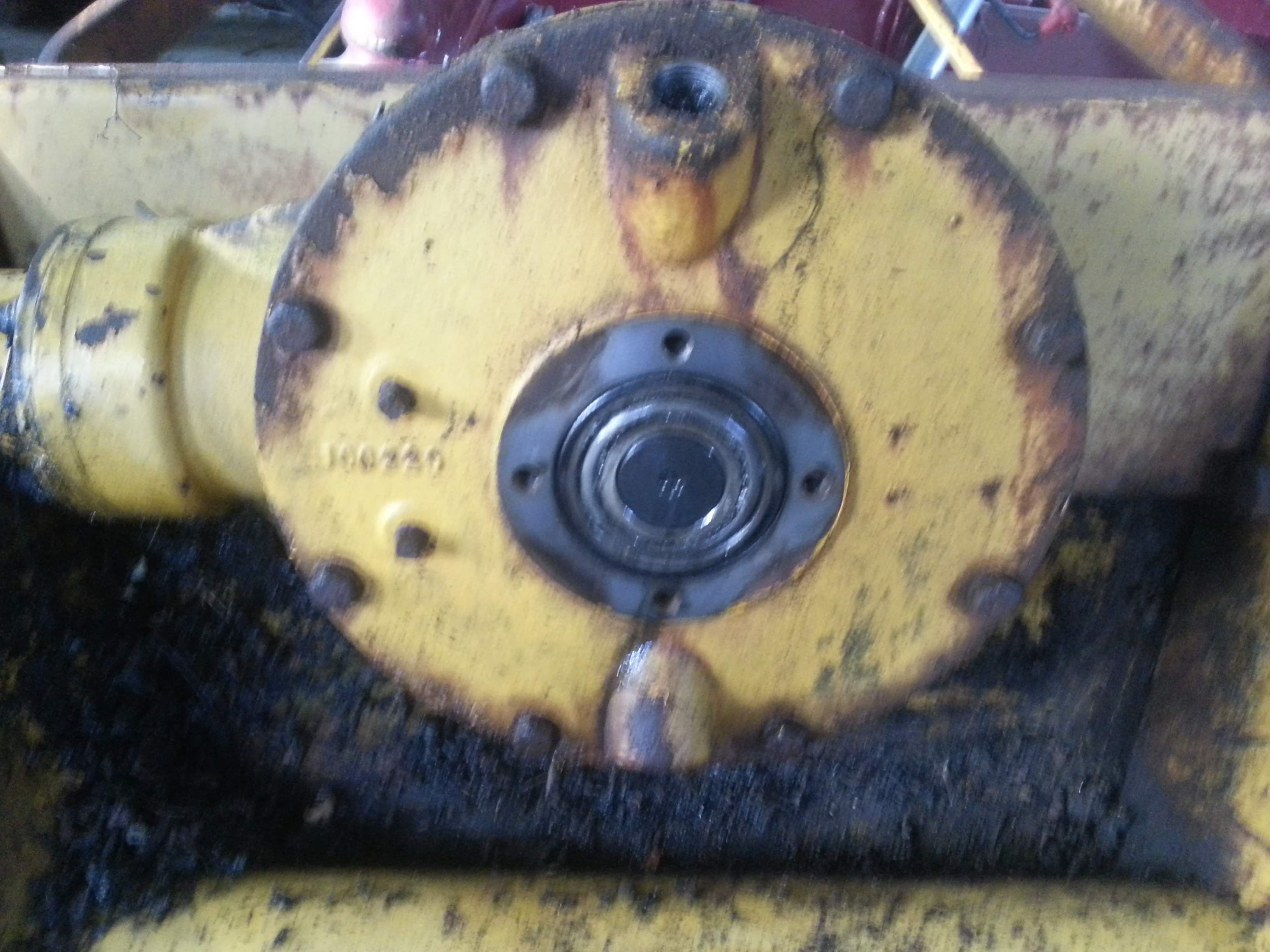

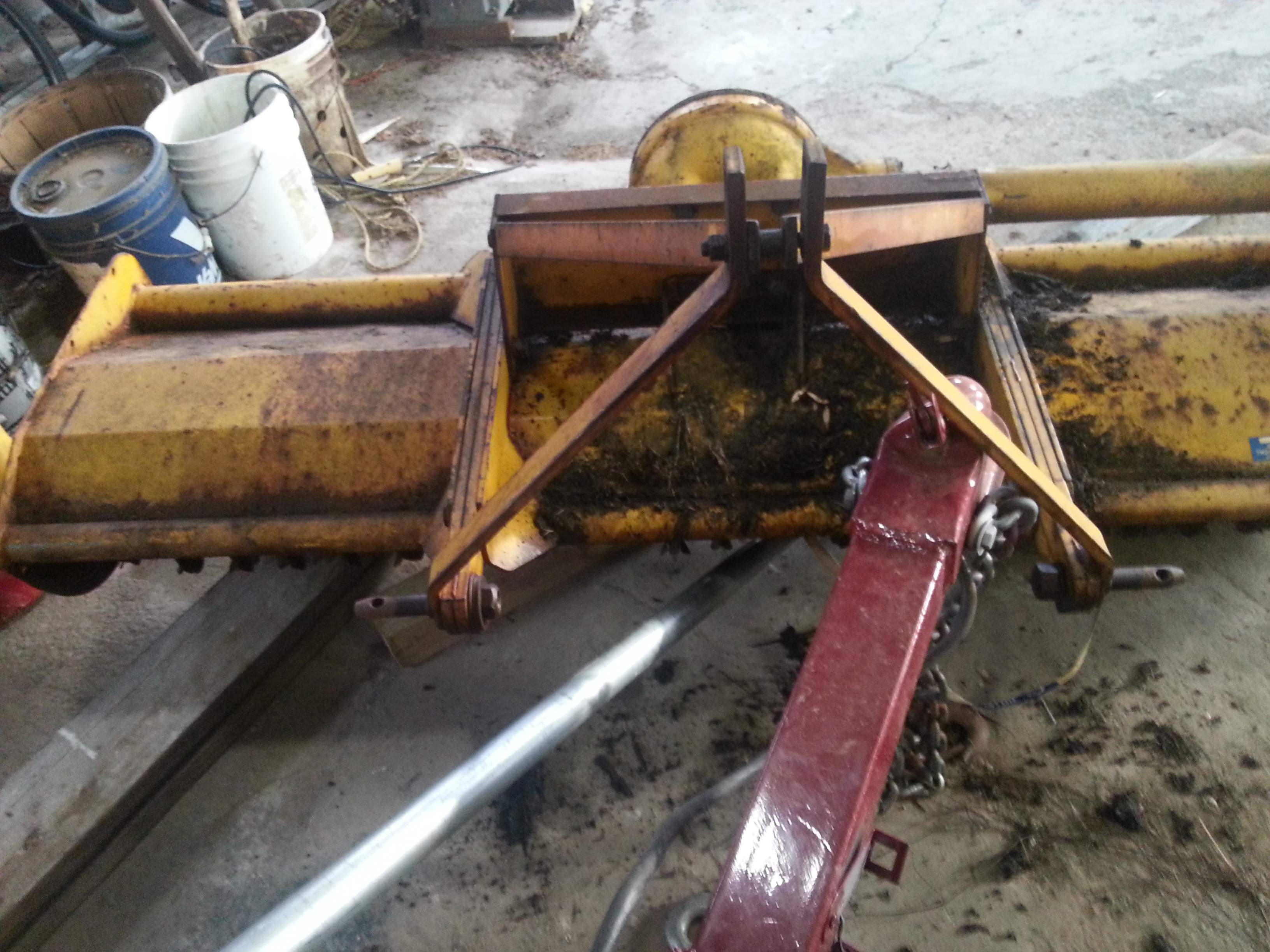

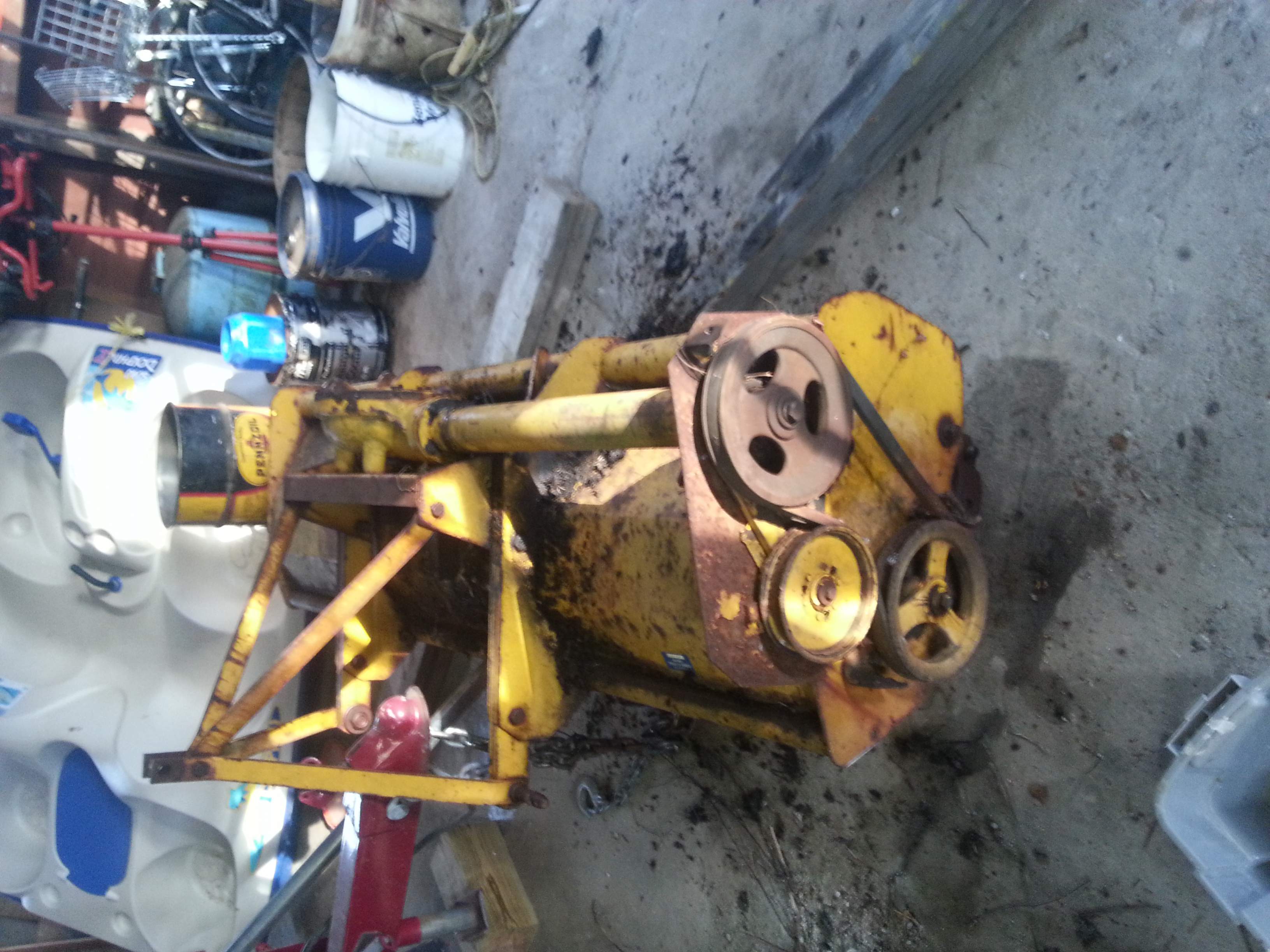

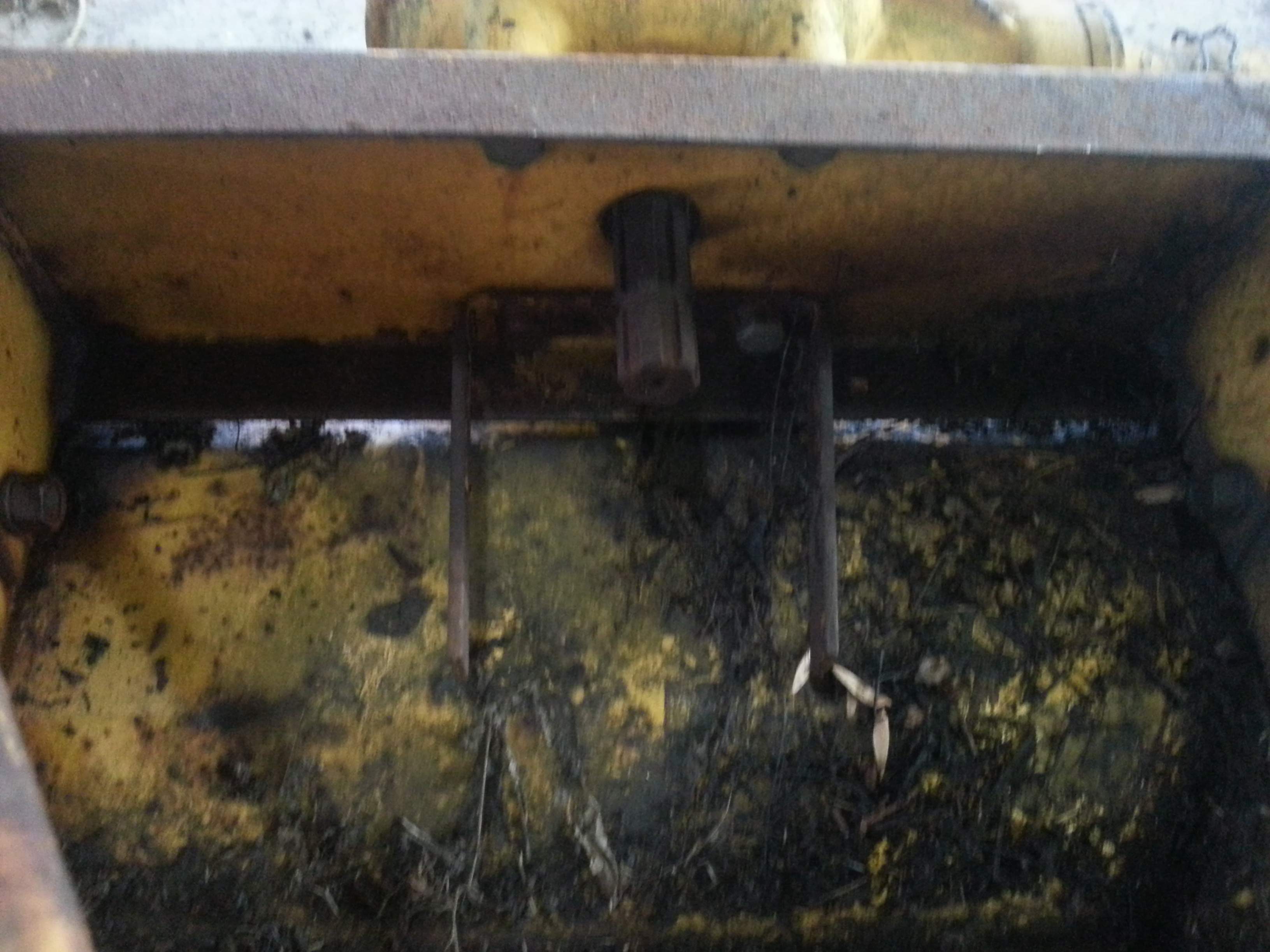

Hello
I have an older flail Its a bit over 6'
It was sitting in a cemetery for some good time.
I have attached some photos and Im really not sure if It will be worth it to get this thing going.
the main gear does not spin it doesn't budge at all - the flail spins fine and so does the roller
when I took of the drain plugs for the gear it seemed to have some frost and frozen substance in there (didnt seem good) I also took of the small plate on the back of the gear and Im really not sure where to start.
Should I take of the main gear cover? to see whats goin on in there

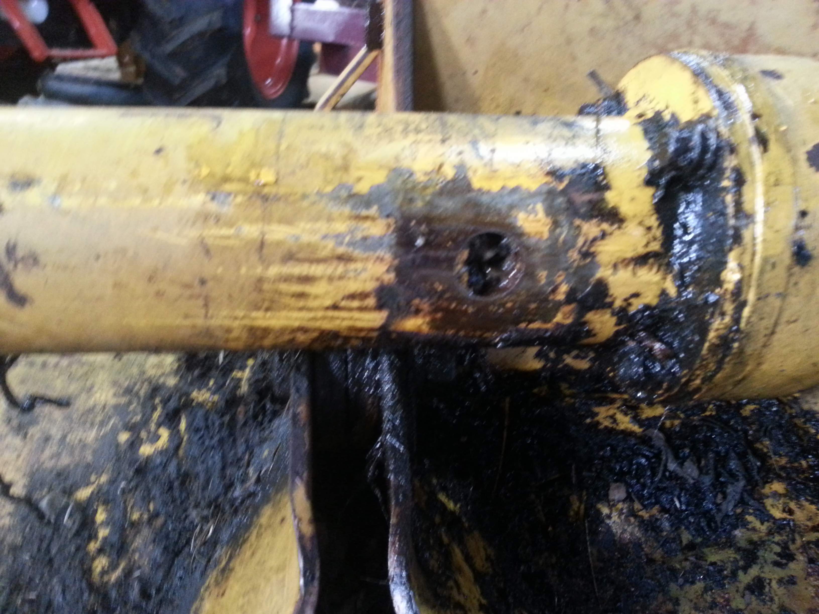

also the shaft that comes out of the gearbox that goes to the belt pulleys has a hole in it that seems like it is for grease but im not sure i dont see a grease valve there
I posted some picture previously and got some good suggestions. Flailmaster and memebers here were helpful in identifying the unit which I wasnt sure about also
once I can get the flail to spin or identify the issue I can then order all the parts to get her running smooth (Hopefully!)
Thank You! 20131201_150558.jpg20131201_150555.jpg20131201_145729.jpg20131201_145716.jpg20131201_145708.jpg20131201_145638.jpg20131201_145626.jpg20131201_145622.jpg20131201_150558.jpg20131201_150555.jpg20131201_145729.jpg20131201_145716.jpg20131201_145708.jpg20131201_145638.jpg20131201_145626.jpg20131201_145622.jpg

OK hold up there!!
1.Drain the old oil and water out of the gear box and if posssible flush
the gearbox with a little kerosene or gasoline.
2. Please put the rear access plat eback on, BUT not before you put a
new gasket on it or the liqiud form a gasket.
3. The cross shaft will have a grease fitting in it to permit you to grease it
as it is greases a spline stub shaft.
4. you need a new PTO shaft to be able to spin the gears.
5. also buy a new kevlar(green) drive belt for it as well.

Looks like my Mott 72, I believe there also was a 74 depending on type of cutter shaft. (72 was fine cut) Yes the shaft should turn freely at the pulley, as suggested flush gear box and see if it will free up.
   / mott/alamo flail mower repair question #5
Trying to turn the drive pulley by hand with the belt on is difficult at best. Take the belt off and try again. Those gear boxes are pretty tough and unless it was run without oil for a protracted period of time it should still be serviceable.
No skid plates = Mott.
   / mott/alamo flail mower repair question #6
Hole in shaft is for grease zerk when you turn the drive shaft to the right spot. Wait to buy the belt until you find the gearbox isn't damaged. If the gearbox had much water in it frozen be prepared for some trouble. They're a sturdy unit but not made to freeze up.
