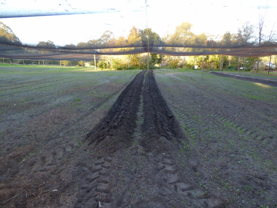

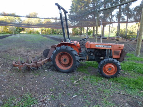

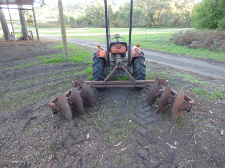

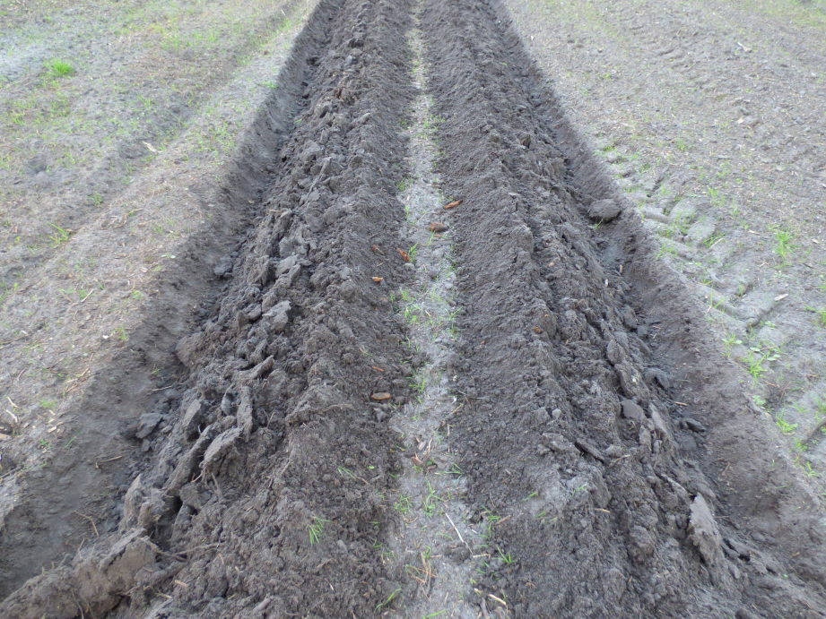

I am trying to make raised beds to grow blue berries some at 3m (10') and others at 2.4m (8') centres.
I have got the use of a merbein plough and set it at 2.4m which is as wide as it will go but at this width it does not move the soil to the centre. I was thinking if I made some sort of shaper to drag the soil into a mound shape it should work from here but I have never seen such a thing. Does anyone have a photo or link to a moulder? Or any other ideas.

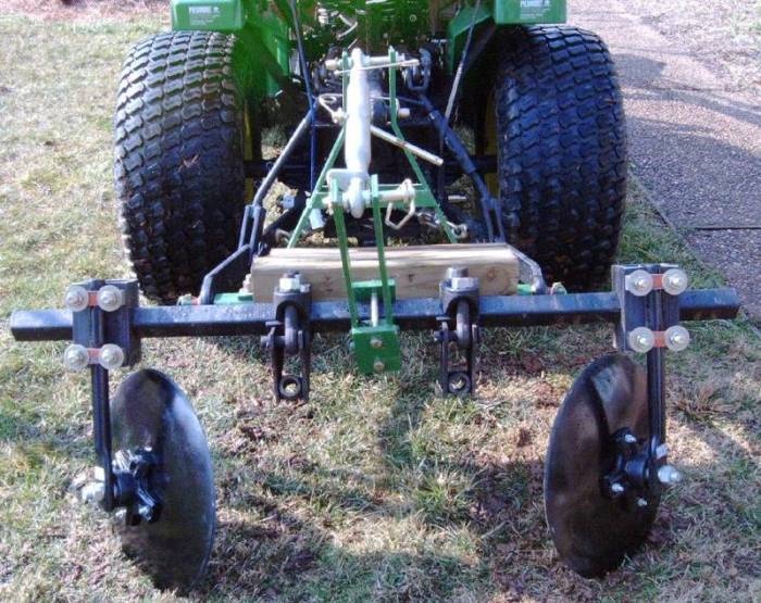

612690-Disc Hillers Rear small.jpg607737-Disc Hillers Left small.jpgYour discs (only need 2) are too far apart. I made raised rows with each disc right behind the rear wheels, which are right at 4' at their outer edge.

Glenn, I think you need to make a pass or two like you have, laying out the rows. Then adjust the disk to a narrow setting and make another pass or two to complete the hills.
/ mound soil, how do I? #5
I agree you will want everything disked well before making the rows. Even if a second pas works you will have your plant routs trying to grow through undisturbed compacted soil. For the hill making pass, can you move the disks closer together?
/ mound soil, how do I? #6
I got 20 raised rows within a 75' garden length. Each raised row is short of 4' from the next one by about the width of a rear tire, with the discs as shown behind the wheels. I could just spin a 180 using my brakes and do the next row with the tractor tires running in the track made by the disc.

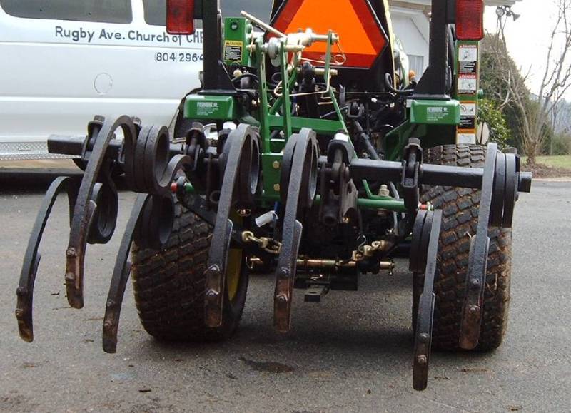

I cut up the entire garden using 9 cultivator tines mounted on the same bar the discs are mounted on. It's an old JD M tool bar. The cultivator tines are called "soil rippers". Then I removed the tines and mounted the 2 big 20" discs.
Ralph

I first used a chisel plough then a rotary hoe and the soil is sand so I just need the rows formed. I will try a second run in a couple of days.

Your close up of the row shows that you still have clods of dirt that the disc is pulling up. I use a tiller set to full depth to till the area I want to make rows in. A two disc hiller then does a great job because the soil is loose enough to move. I think you will achieve good results if you move the discs toward the center a bit. Experiment. Till the soil until you don't have clods, move the disc in a bit and leave space between rows to achieve the desired number of rows for the area.
