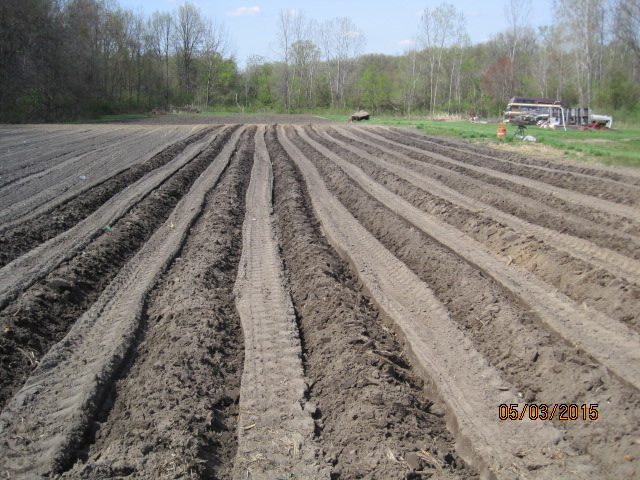

Your close up of the row shows that you still have clods of dirt that the disc is pulling up. I use a tiller set to full depth to till the area I want to make rows in. A two disc hiller then does a great job because the soil is loose enough to move. I think you will achieve good results if you move the discs toward the center a bit. Experiment. Till the soil until you don't have clods, move the disc in a bit and leave space between rows to achieve the desired number of rows for the area.

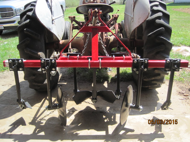

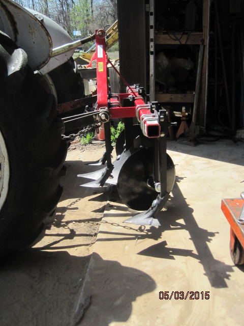

IMG_0071 - Copy.JPGGlenK:
Here are some photos of a hiller I bought last year. I am sure you can put one together by your self. You don't need that large shoe (sweep) in the middle. It just makes a center groove on the hill for like planting potato's.
