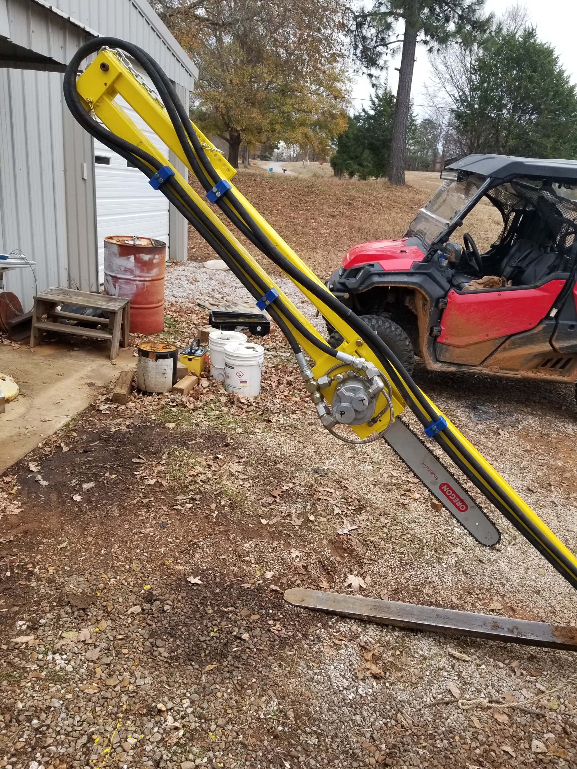

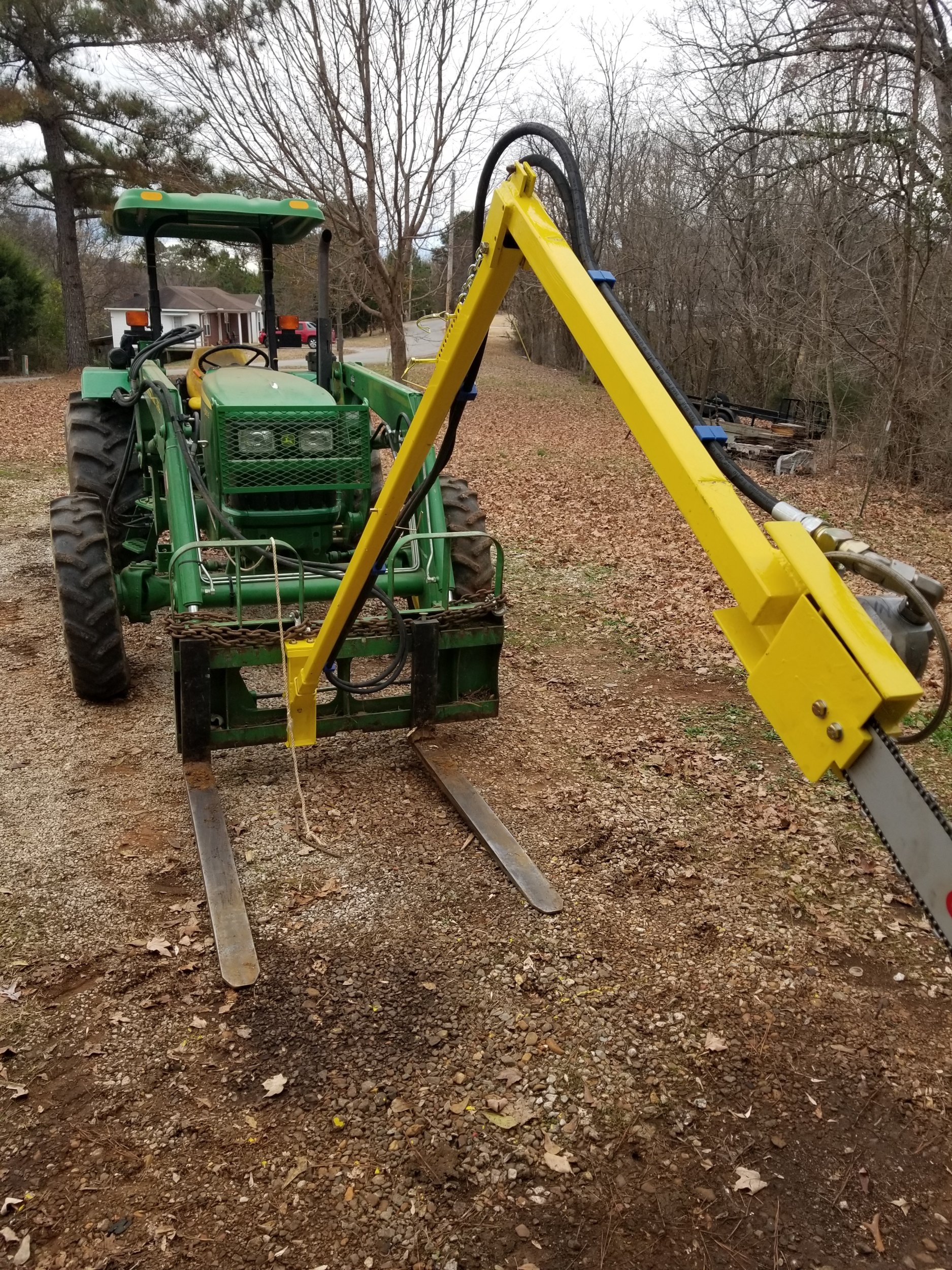

   / Mount chain saw on loader for limb trimming #29
I made one a few years ago. Used a hydraulic motor as a power source and the same bar and chain as my Stihl chainsaw. Works great.
