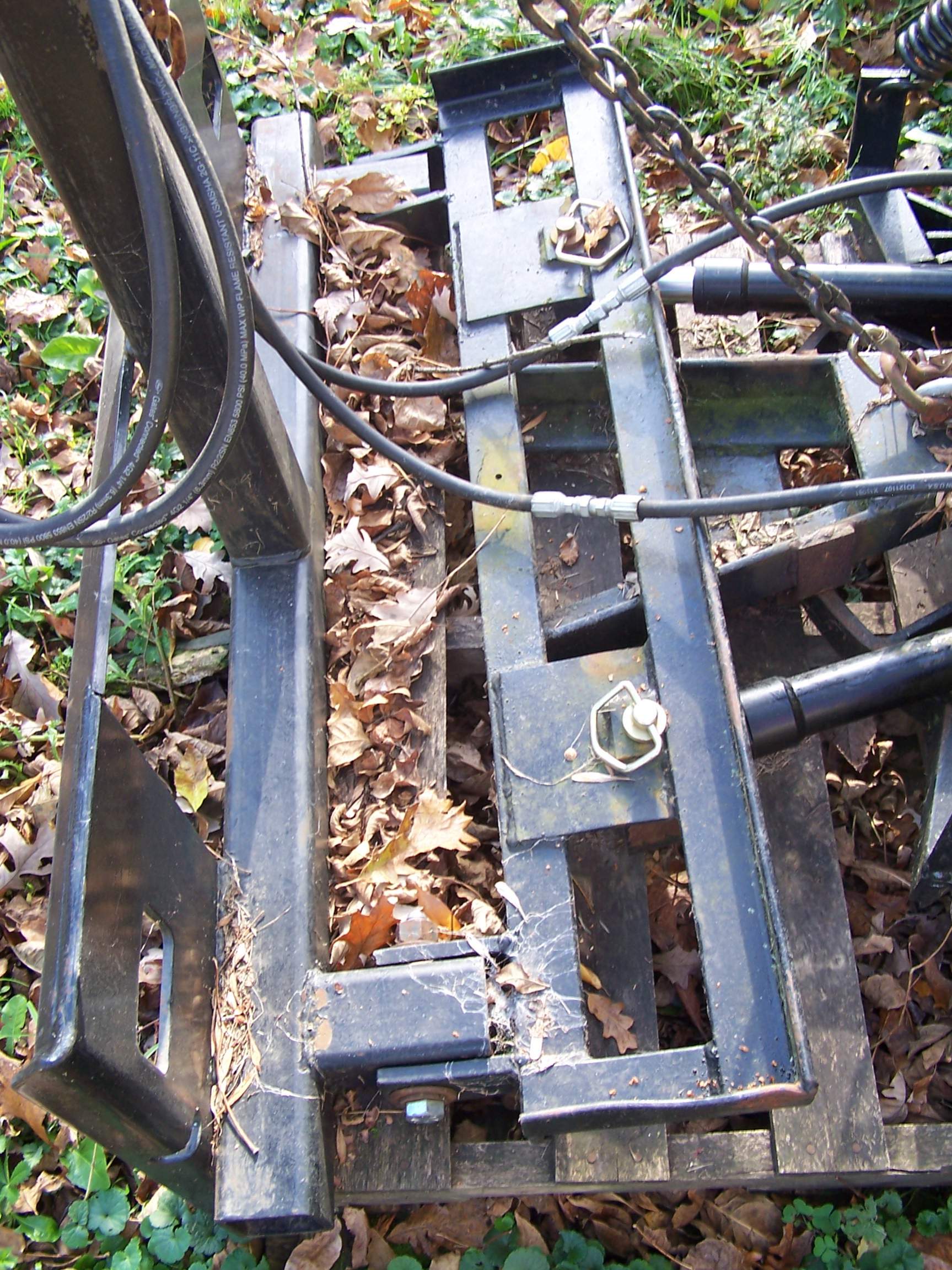

I welded a 3pt quick hitch to a SSQA plate for mine. Plow frame has a cross brace that fits in the lower hooks & can pivot. Chain goes to the toplink hook, so I can float or lift the plow with curl.
You will hate it if you hard mount things. It needs to float & floating the loader arms in float dumps WAY to much weight on the plow.

As stated,you want to float the plow not the FEL.The pivot points on mine are 1in.bolts.

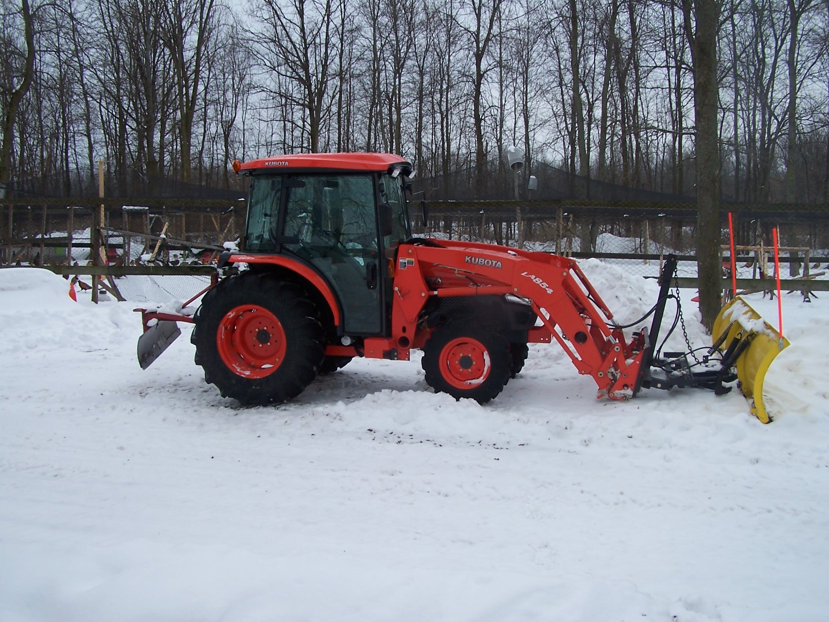

I use a seven ft.rear blade in combination with my 8ft.front.Rear blade works well for pulling snow from door ways ect.
