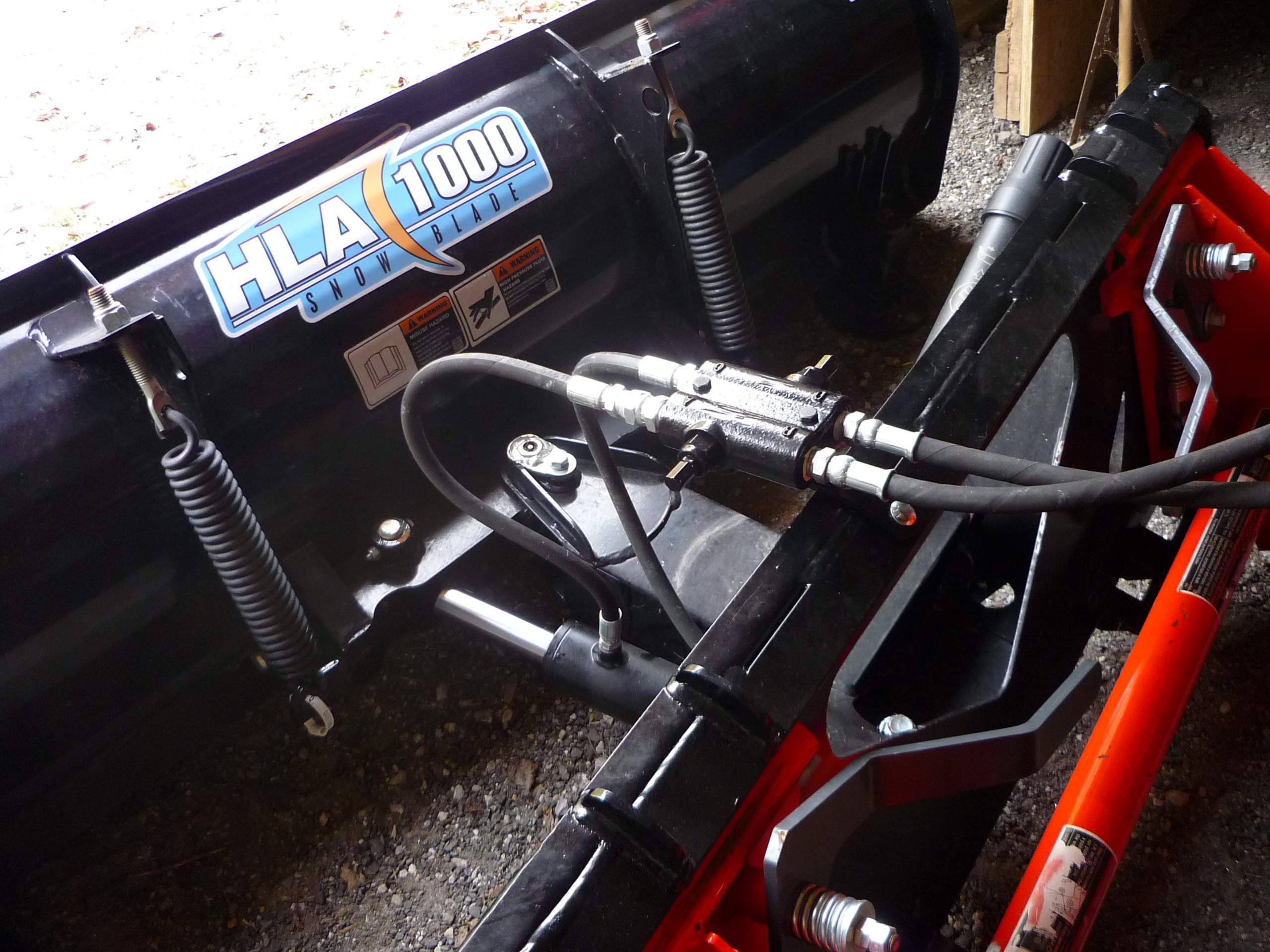

Ok. Got the plow, SSQA and the prince valve in the garage.
I have the blade pinned to the QA and now on to the hydraulic end,,,,,
The cushion valve has 4 pots and 2 "adjustment" screws
I assume the tractor side hoses go in one end and the plow side hoses into the other?
   / Mounting a 8.5' snow plow on a SSQA plate #32
Cushion valve should be factory pre set and not need adjustment.
Attached is the plumbing drawing. A&C to the hyd. hoses. B&D to the cylinders.
  • dr9-4019-50-h.pdf
   / Mounting a 8.5' snow plow on a SSQA plate #33
When I installed the same cushion valve, I spoke with a hydraulic tech at Surplus Center. He told me to adjust the relief pressure as needed. Screwing in = more pressure needed for relief, out is less. Trial and error, if you will, helps. Both sides should move in or out the same amount. I think he said they are factory set at 1500 psi? Easy to do. If the blade changes its angle when pushing snow, and you don't want it to, you want a little higher relief pressure setting.

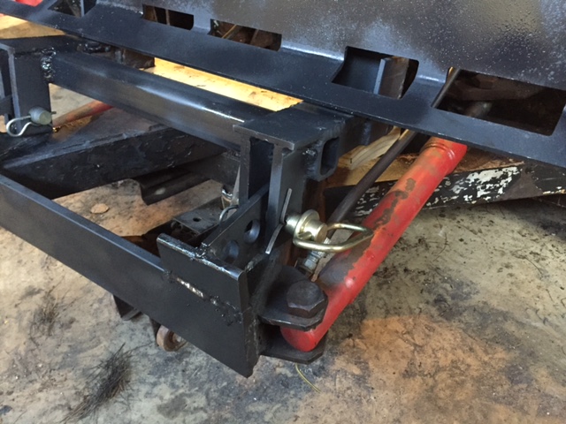

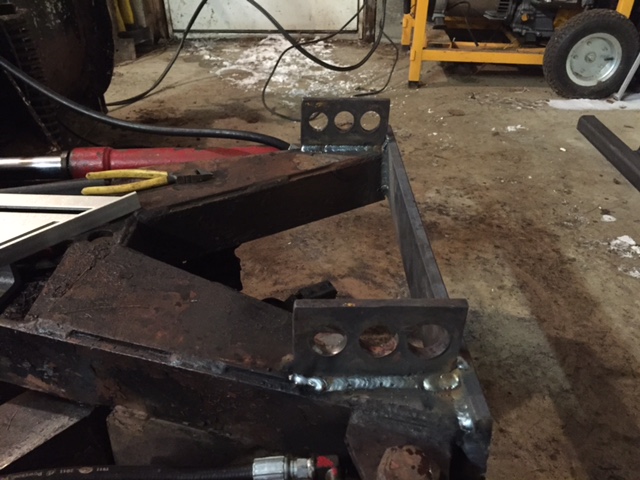

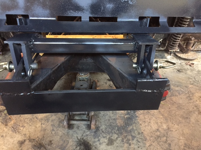

Got it all mounted and working except for the ability to apply down pressure. I have some stuff on order for that.
I ended up adding another crossmember just behind where the plow pivots and added some new pin points. This got the plow 14" closer to the tractor. I used 2x3x1/4 tubing as the crossmember. I capped the ends. Then used 2x3/4" flat stock as new pin points to match the originals.
Overall I am very pleased with the set up. I just need to get my 3rd valve setup on the loader. Currently I have hoses run from the rear remotes for power angle. Ford is just dump and has the valve under the seat

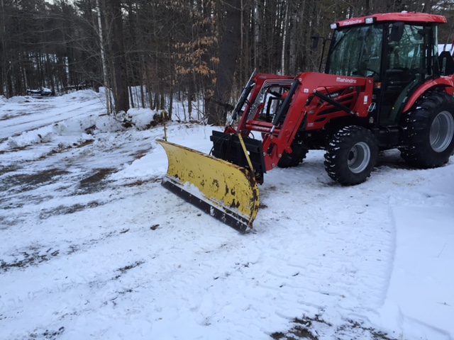

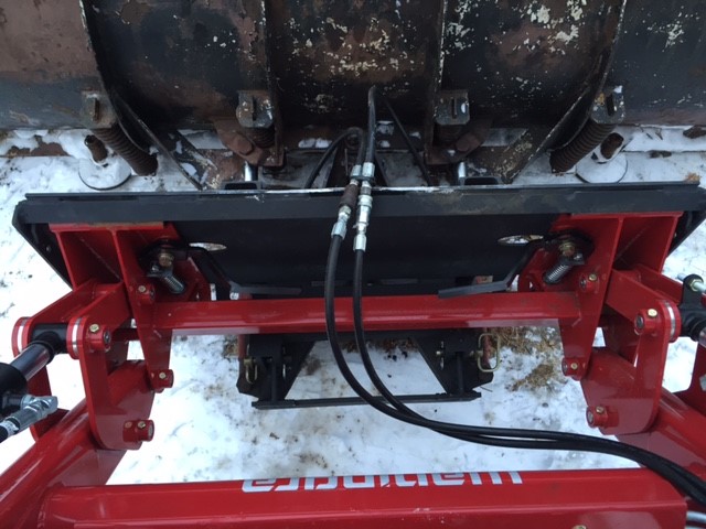

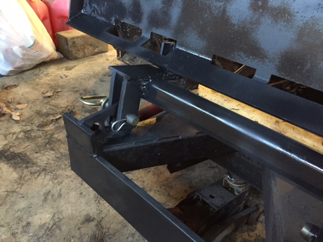

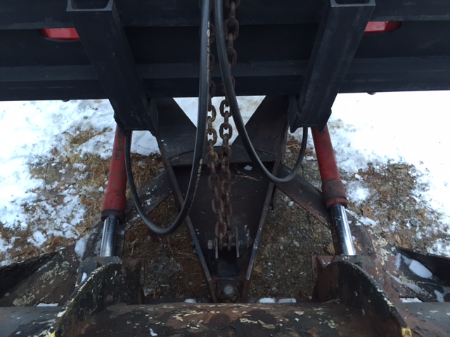

   / Mounting a 8.5' snow plow on a SSQA plate #39
I used Wild Bill's design and this is how mine came out:
IMG_0520.JPG IMG_0526.JPG IMG_0527.JPG IMG_0528.JPG IMG_0530.JPG IMG_0531.JPG IMG_0532.JPG IMG_0533.JPG
I did add some rear shoes to the back of the A frame and it works great.
I still need to find a better way to mount my hoses and then when the weather is better, its going to get a fresh coat of paint.
