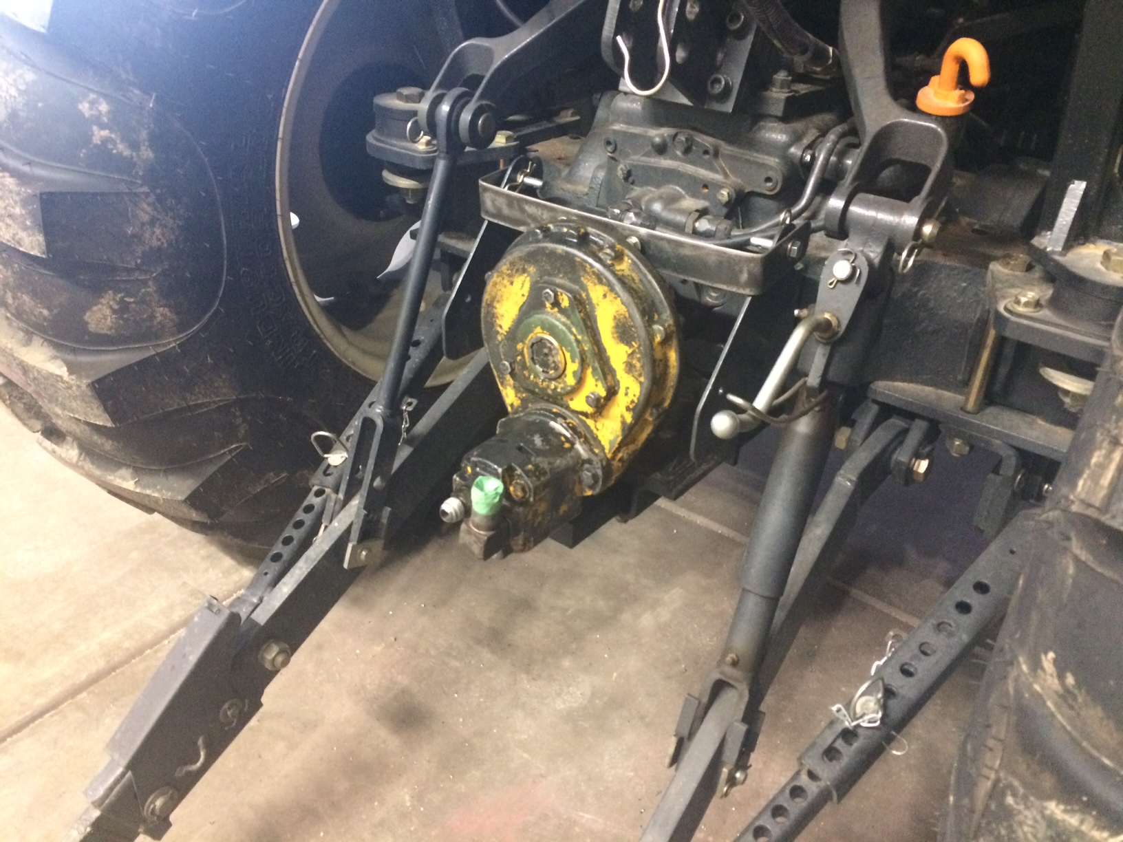

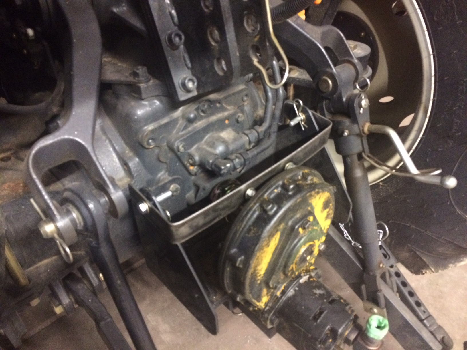

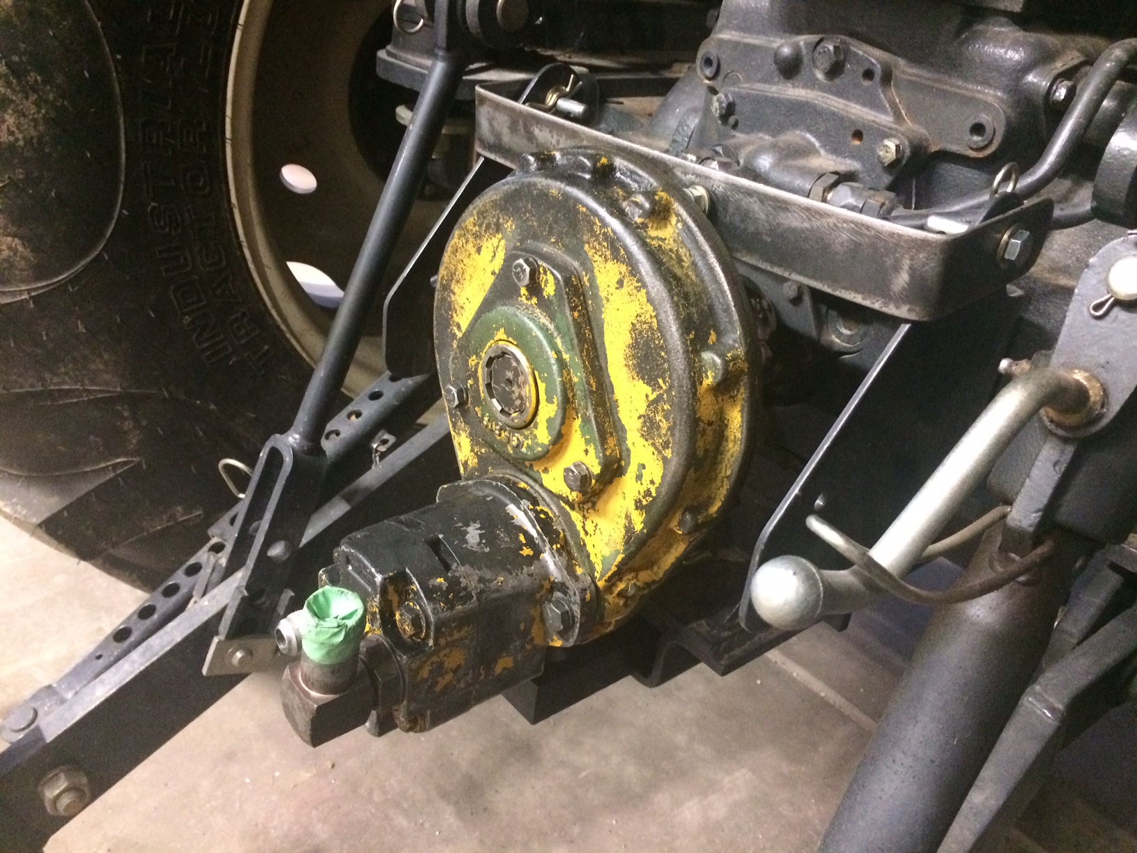

This is the setup I use.....takes the place of the torsion bar and chain....very easy on and off, two pins holds everything in place. I use this pump for my backhoe attachment. I built in some "play" so the pump floats around with no axial/ radial restrictions.
Seems to work really good.....I need to paint it!!
