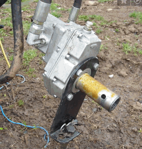

With a little of the stabilizer in the picture in post #4 in mind...... A number of years ago I saw where someone had built a bracket onto a piece of rectangle tube that slid over the draw bar and pinned in the draw bar hole.. The bracket bolted to the pto driven hydraulic pump.
This stabilized the pump, not letting it twist or back off the pto shaft. But had sufficient clearances to let it wobble or move enough to not put undue or unnatural strain on the pto shaft bearings and such..

I made this for mine. Pulling the sleeve back to disengage the shaft and remove the torque chain was a pain in the butt. There was a mount for something directly below the output shaft that was two plates about an inch apart, all I had to d was drop a bolt down thru it with a hairpin clip to keep it in place...........Mike PTO mount.gif
   / Mounting a PTO hydraulic pump #44
My pto pump has a chain to keep it from spinning, I put a "quality" stretchy strap over the back of it to the tractor, to keep the pump from working out/off.
It works perfectly, and I didn't need to fab up anything fancy, to fix what really isn't broken...
