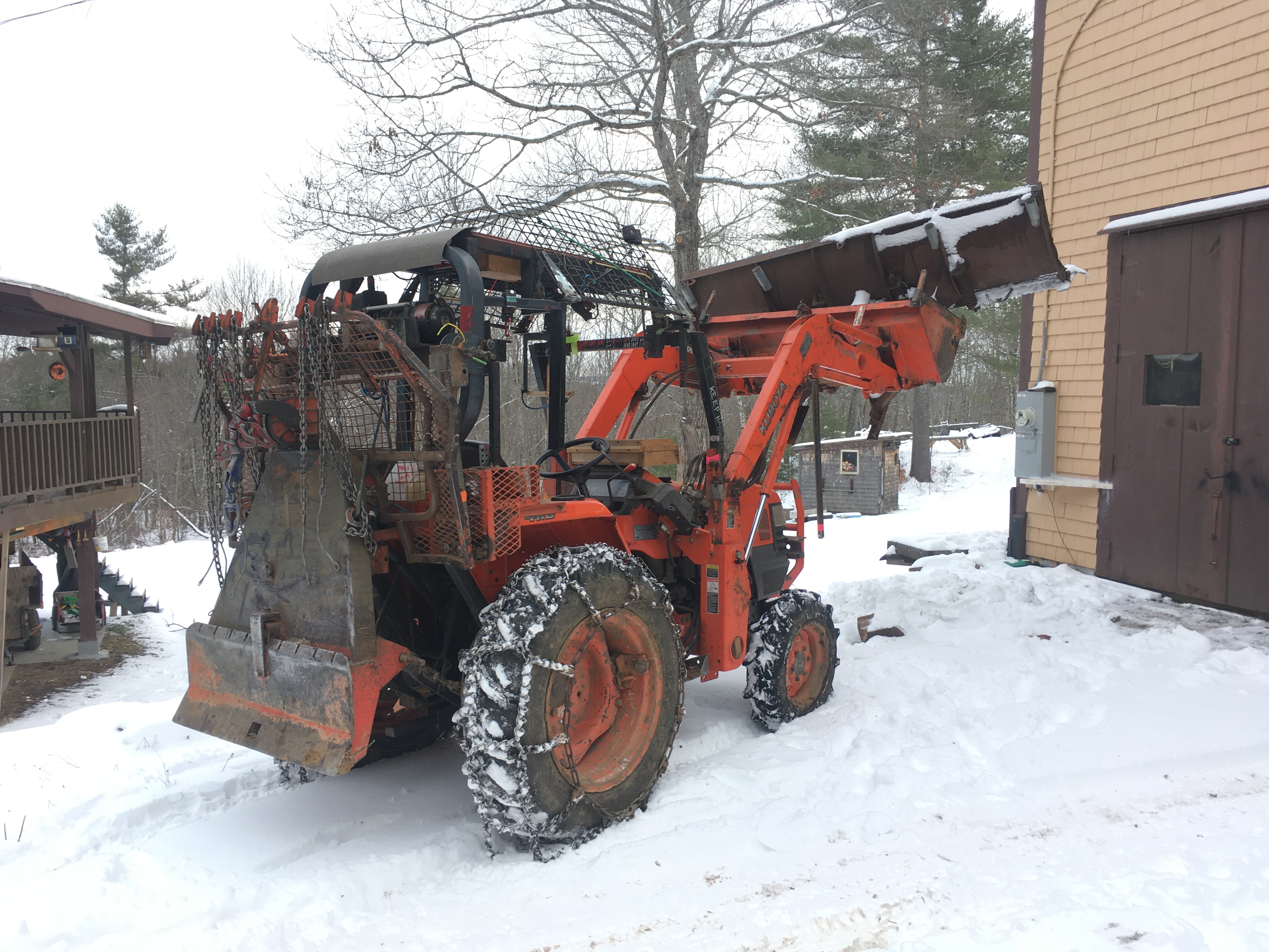

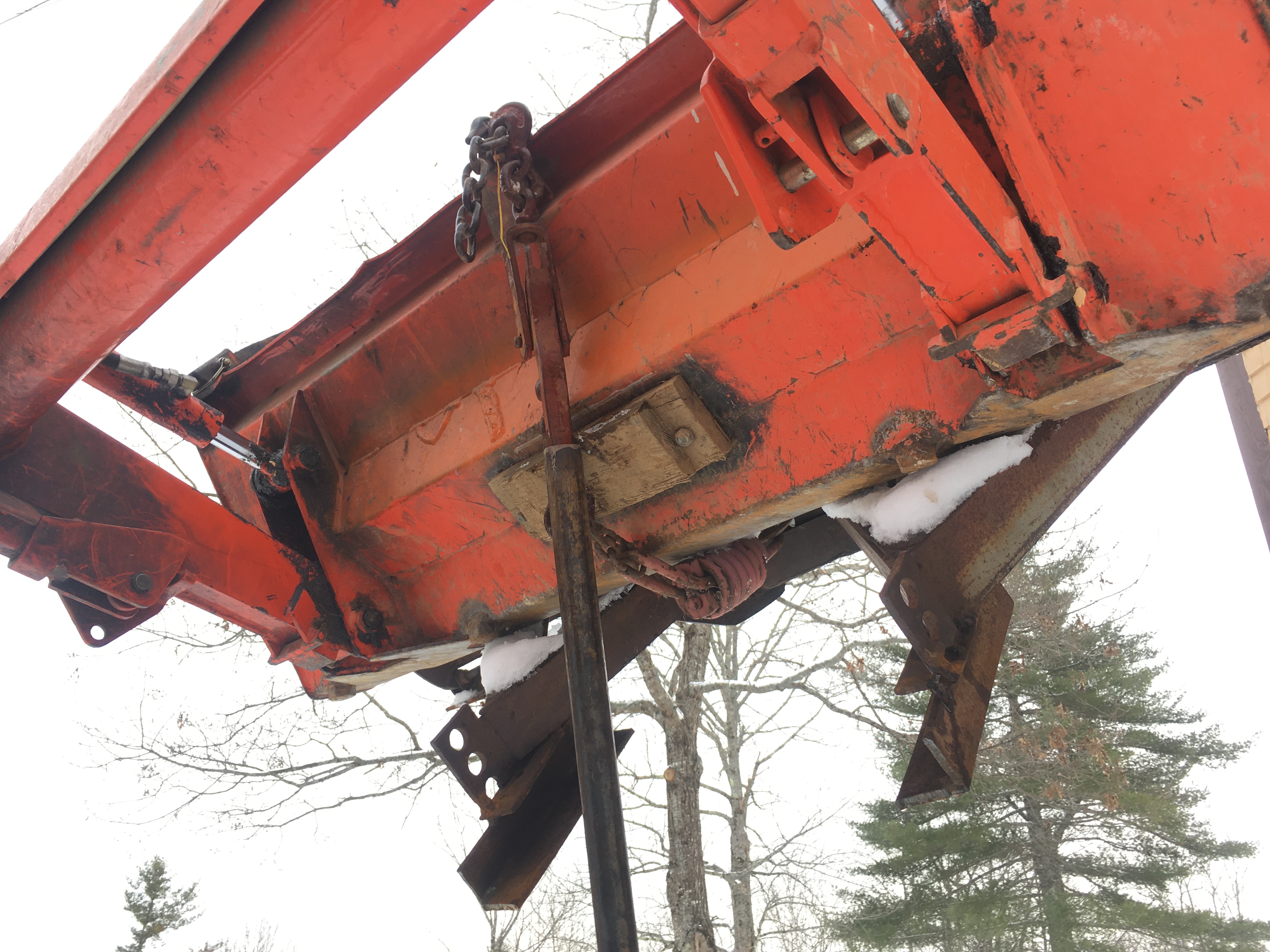

There is, yeh. I was catching shade from some tbn people about building my little snow plow, "it's gonna be a pretzel the first time you use it". Yeh well, I'd rather my plow take damage before my loader arms do. And btw, plow works fine.
