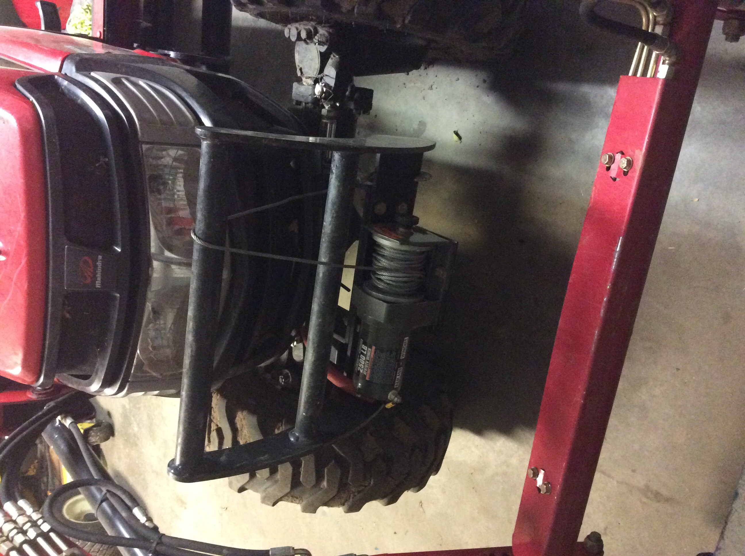

I did exactly as you are thinking on my Mahindra Max28xl. I use this $50 harbor freight winch with a brush grabber choker chain for pulling out bundles of scrub. It's cheap. It's slow. But when you have limited space to move the tractor, this is the best option to drag the stuff closer to the bucket. I would not want to use this to pull out true logs though. It's duty cycle is only a few minutes on and then 15 min off. It does have thermal overload which takes forever to cool off and reset.View attachment 408452
Zombie thread! :D
Reviving to say thanks for your photo. You never know when something you post might have proven useful to someone else, even years down the line to I thought I'd let you know about this instance. My wife just gave me a winch for my tractor and I was searching to see if mounting it on my tractor was even feasible. I have an RK24 which looks very much like your Mahindra (may be a relative) and your setup looks perfect for mine.
Merry Christmas!
Tom
