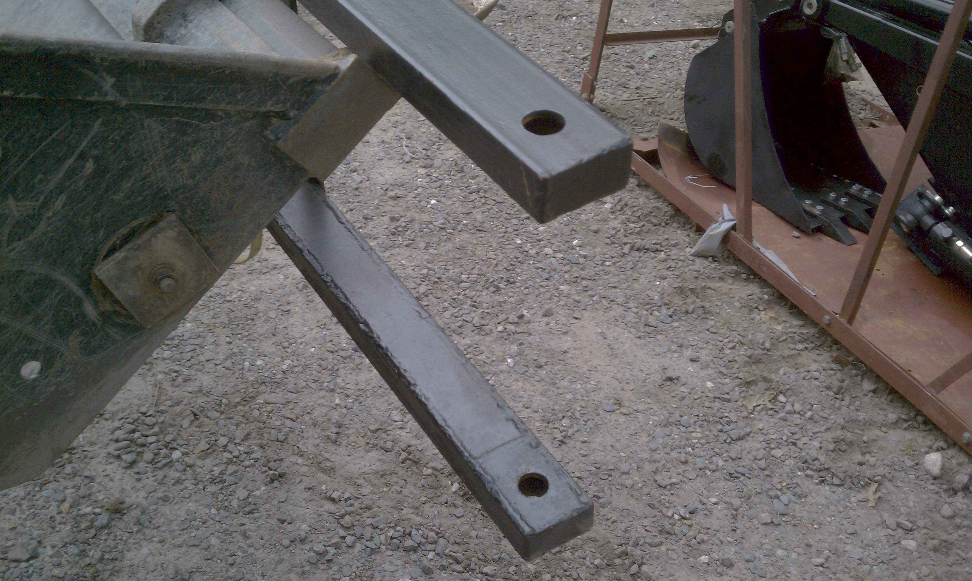

I ordered direct from Jinma a frame mounted BH to fit my 284. I expected an HWO3 or JWO3 or something like that but received one that says HWO4X on the nameplate. I'm still not sure if this is a 6' or 7' hoe.

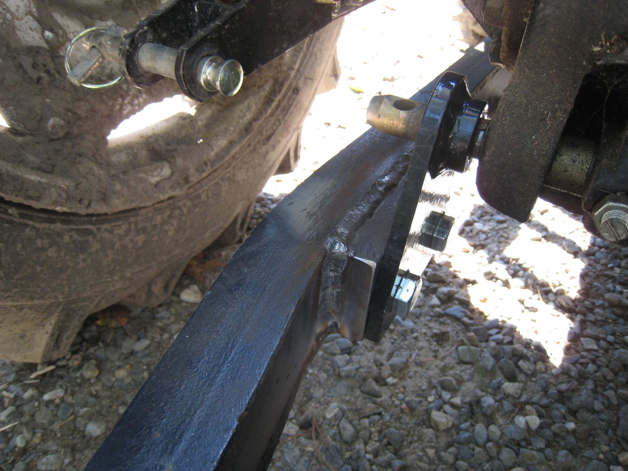

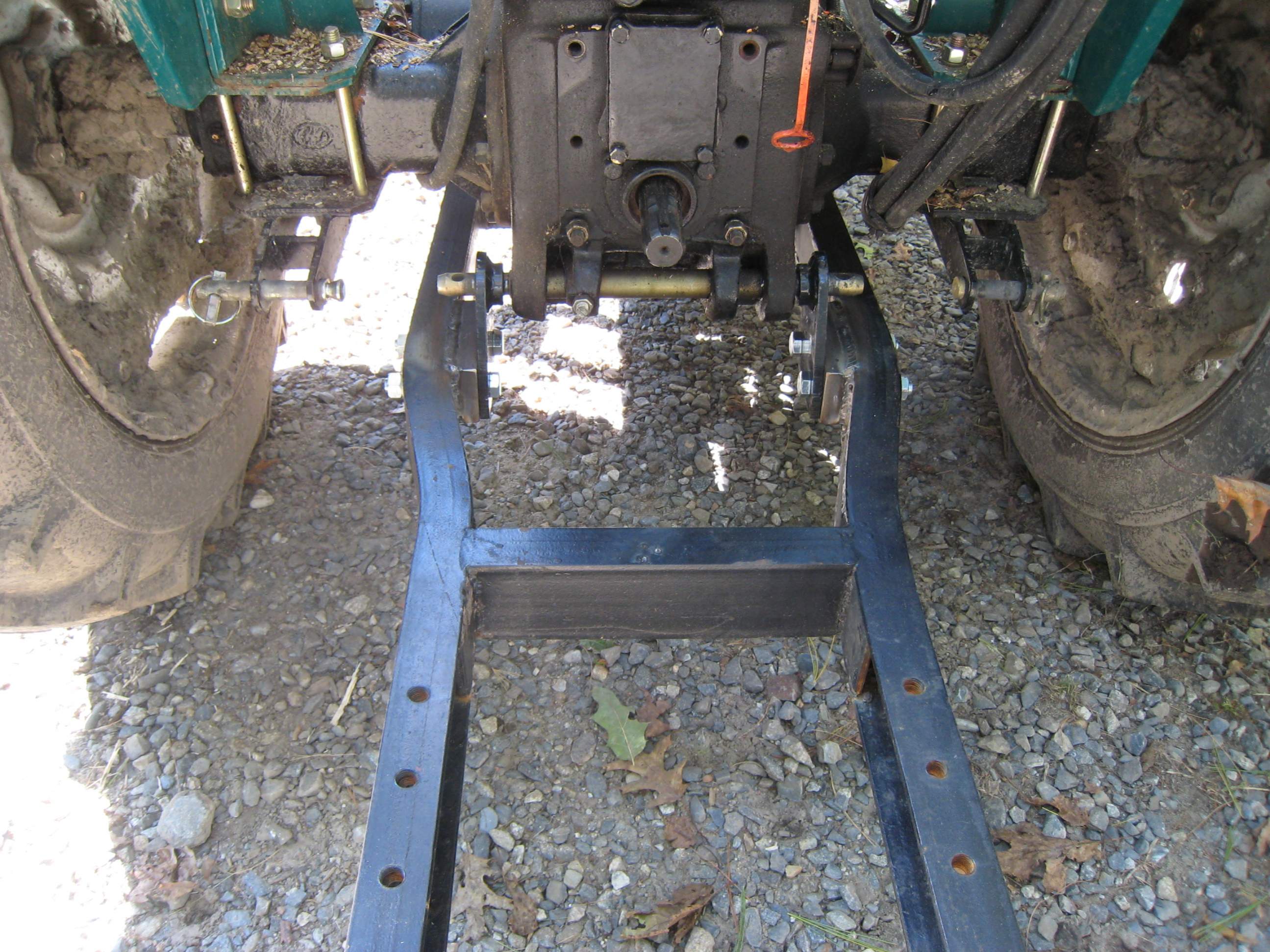

FRAME - The frame is much more robust than others I've seen. The front end of the frame has only one pair of holes so there is no adjustment fore and aft. The span across the rear of the frame is too wide and we had to weld in thick spacers. We bolted everything in place before welding.
At the front end we had to adapt some brackets from Tommy at Affordable. They didn't quite give us full overlap under the Koyker towers but they should be adequate.
Finally after getting the frame mounted and then sorting out the pump and hose connection problems, I was able to attach the hoe. I knew in advance there may be problems in reaching the controls and RonMar has been helping me with details of his own excellent solution.
Remember, there was no forward and rearward adjustment of the frame. The oil tank is 9-3/4" away from the face of the pump. This makes it impossible to use the swivel seat turntable that came with it.
The next step is figure out how and where to locate the seat as well as possibly flipping the controls around like Ron did. Another TBN member, Kyle, went through this with his Jinma 454 and he's been kind enough to send me some photos. I'd welcome any solutions to this seat location problem. I'm even toying with the idea of connecting a new base to the 3 point arms and use them for height adjustment.
Lastly, how do I confirm if this is a 6' or 7' hoe?

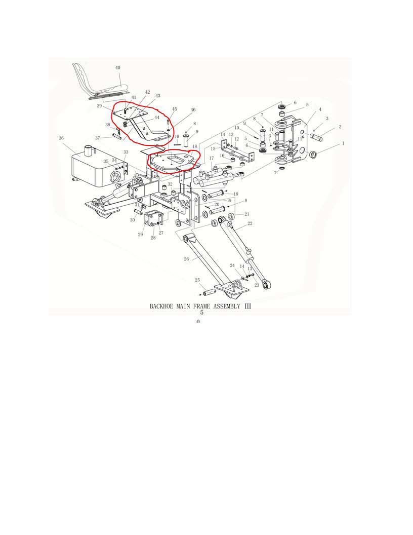

"I still have no seat and Jinma recognized the problem (they sent me an HWO4X instead of HWO3X). They are shipping me a complete 3 point seat BH seat pedestal and I'll modify it"
I received the seat pedestal and new baseplate - see attached. The problem is that the 3 point has no oil tank and the seat pedestal in the current form is right over the tank filler. Will solve this over the winter. Lately I've just been sitting on top the backrest of the tractor seat.

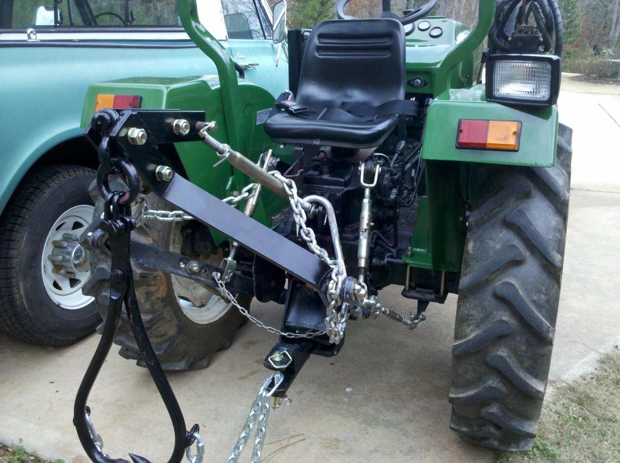

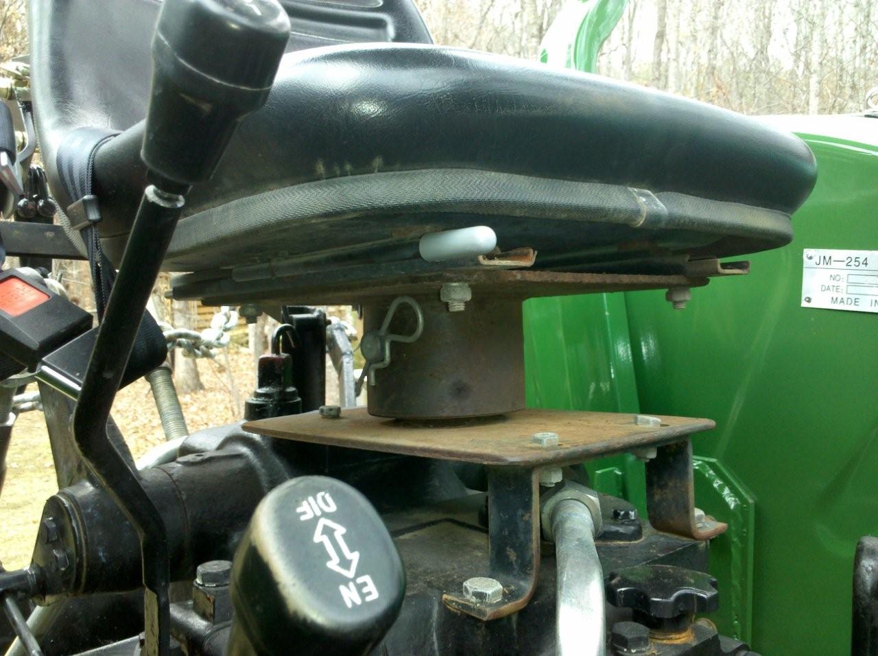

This may or may not help you, but I thought I would offer some pictures of my Jinma 254 seat setup. The prior owner had a frame-mounted backhoe but sold it separately. The seat has a simple swivel post (easily fabricated post within a post) with a retaining pin for 2 possible fixed seat positions. It then slides on rails front to back so that when spun to the back you can shift it closer to the hoe.

I've got that swivel seat already because I ordered it with the BH but then they sent me the HW04 seven foot hoe with big subframe. The seat is too high and too far away. Even if I extended the seat rails, it would be too high.
Off topic but I like your log skidding rig. Did you make it or buy it?
Chris
   / Mounting HWO4X Backhoe to Jinma 284 #12

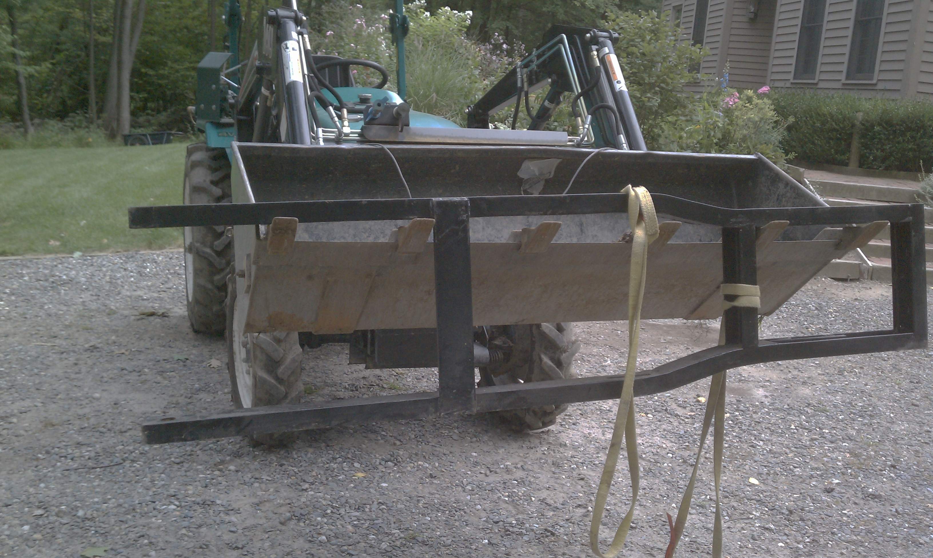

Thanks, I made it out of one of these "A" Frame Brackets which I cut at 45 degrees, drilled and re-welded along with a set of skidding tongs from Northern and some chain to keep the pulling point on the draw bar. There's another utility hook chain stowed around the rig in the seat photo that I use separately for pulling brush bundles and isn't part of the skidder.
I shamelessly copied a design I saw here, because I couldn't stomach the $650 cost for what I knew was less than $100 in materials. It was simple enough to make and works better than I could hope for.
Here's some more pix taken before I did the Oliver Green paint job on the tractor.
