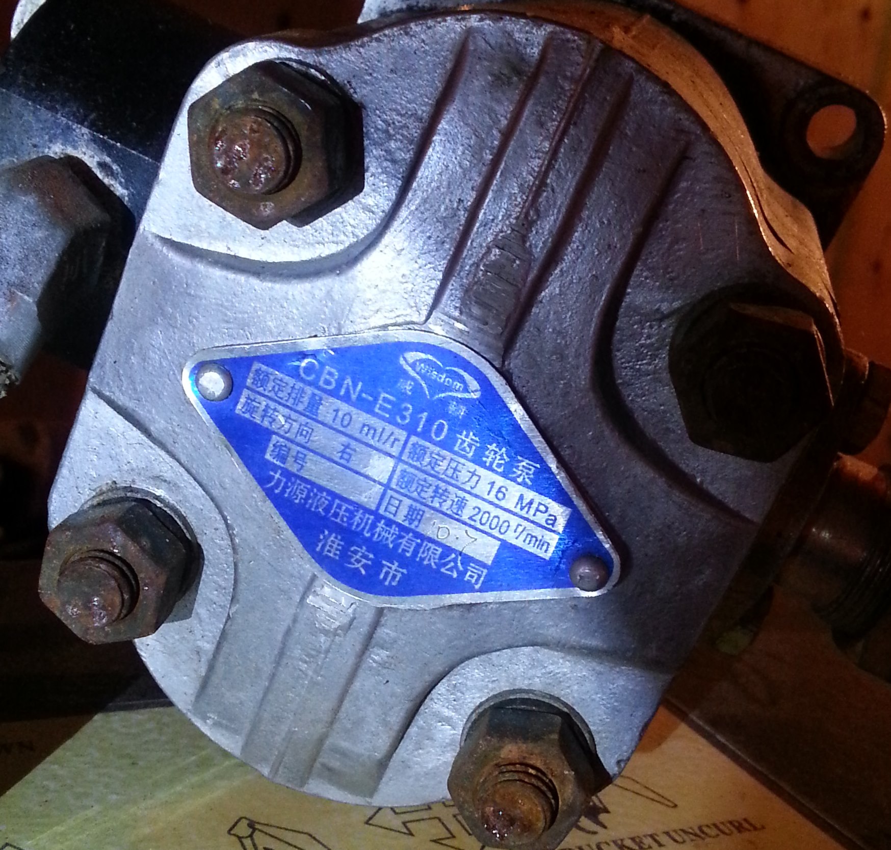

I have a valve in mind and it's a 10 GPM. Just checking the math here. The factory pump that mounts on the tractor above the PTO shaft is a CBN -E310 and it says 10ml/r which I think (and hope) is ten milliliters per rpm. It also says 2000 r/min which I assume is maximum speed?
So, if I run the tractor at 1200 RPM the pump is putting out 1200 X 10 = 12,000 ml/min. That equals 2.64 gal/min. If I run the tractor at 2,000 RPM the pump is putting out 4.4 GPM.
Unless I'm missing something, a 10 GPM valve is more than adequate to supply the huge cylinders on the HW04.

Steve, the rating on the pump is 10 ml/r = ten milliliters per revolution. RPM is stated as r/m or r/min. I think you'll find the pump is rated somewhere around 7-1/2 gpm, which will be plenty for you.

Thanks. Here's the pump:

My calculations come out like this:
10 ml/r @ 2,000 r/m = 20,000 ml/min = 5.28 gpm. That is a lot of volume going through a 1/2" ID hose with a 2,000 psig potential behind it. That's almost comparable to my dual pump excavator. :)

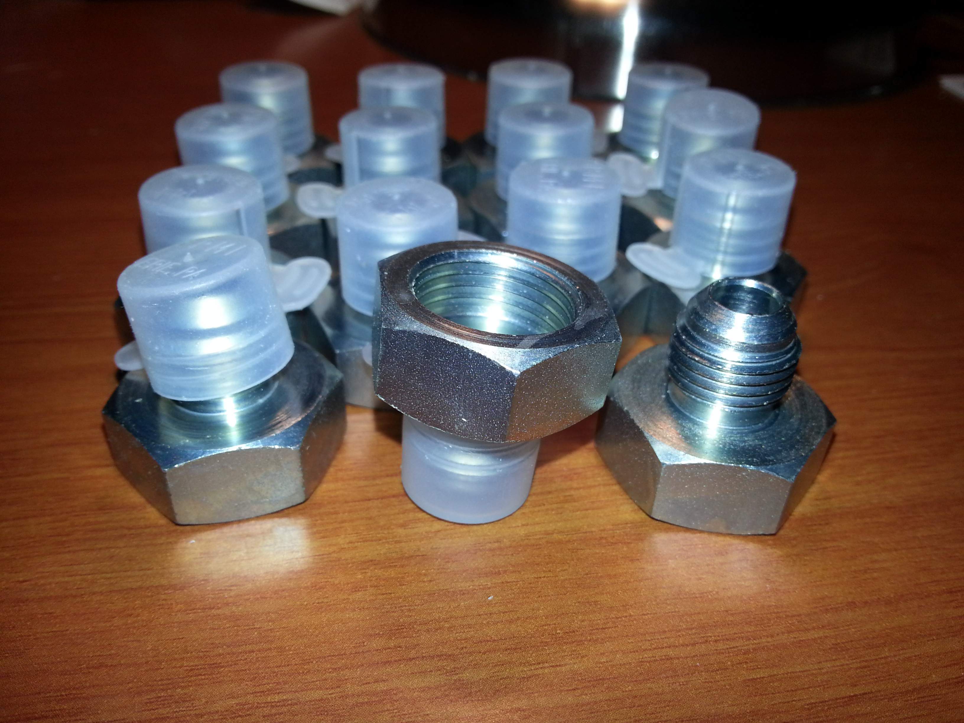

I already received the adaptors from Ranch Hand to convert every cylinder connection to JIC. Today I received the new control valve assembly as well as all JIC hoses and hydraulic fittings to make it all work.

Here are the neat fittings from Ranch Hand that allow conversion of male Chinese O-ring connection to a male JIC. You can convert the cylinder connections as well as outlets on the Chinese BH control valve. I've used these before and now I have enough for this project.

I think Ronald has the market cornered on those fittings. I bought mine from a different source years ago and they no longer have them. Good catch. Glad they are still available.

These fittings are not always available and I found that out last year when replacing a cylinder hose. Fortunately, Ronald just received a shipment and immediately ordered what I needed for this project.
