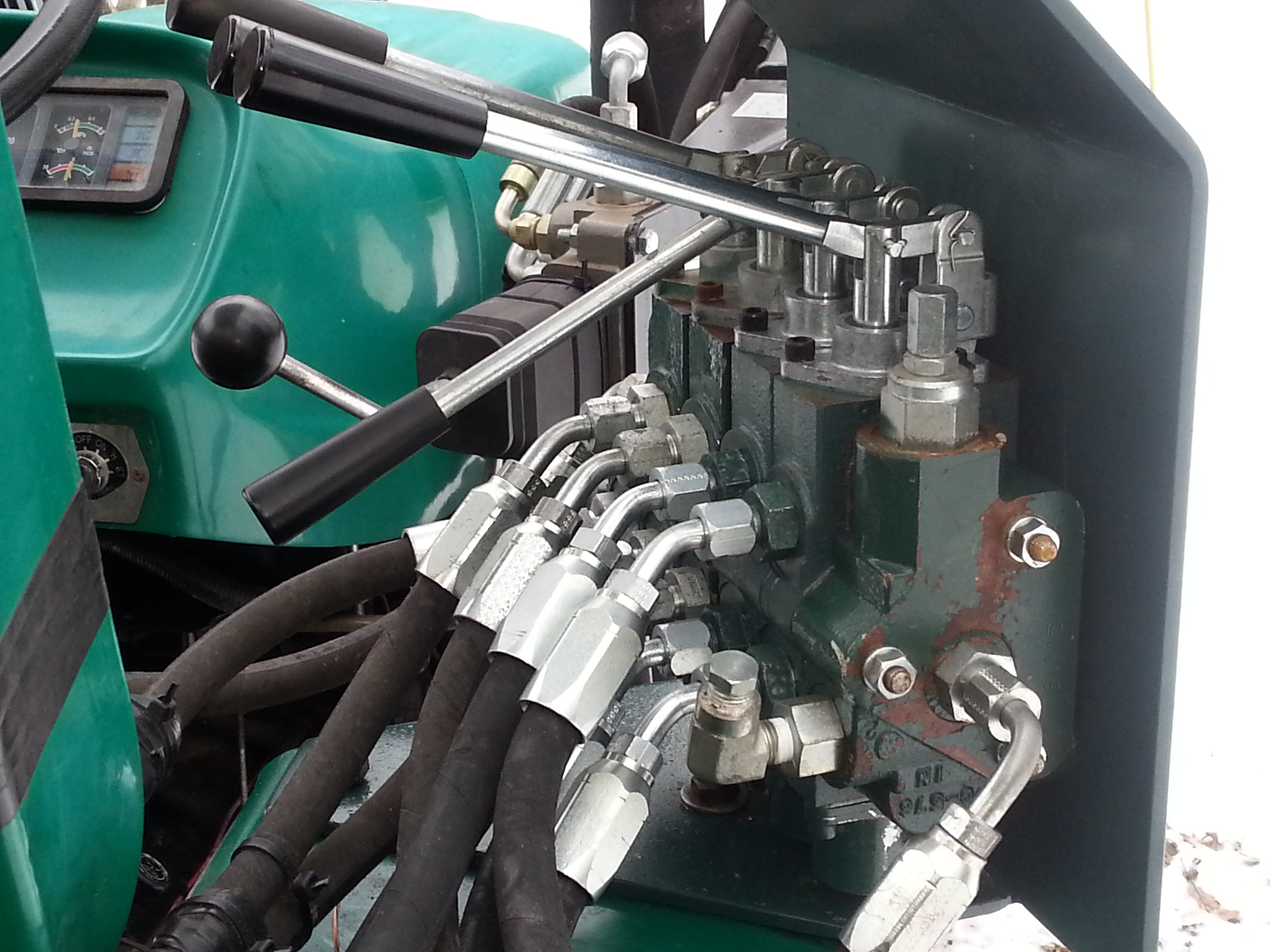

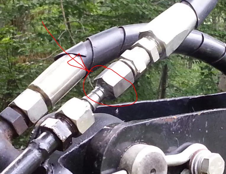

Hose Conversion - I know how to make my own hoses. I also made a new hose and connected it from the valve and ran it all the way to the cylinder. See picture below and you will see how we welded an adaptor so that I could attach my own hose with reusable ends to the Chinese cylinder.
If I replace the valve, I'll have to decide if I want to replace all the hoses and deal with the conversion at every cylinder or else leave the hoses alone and convert them at the valve. Has anyone done this before at the control valve? Ranch Hand used to offer adaptors and I bought one a few years ago, but I think they don't offer them anymore.
It'll be my luck to add the new valve and then have to weld extensions on the levers :laughing:
PS: All the credit for adding the valves and hoses goes to 3RRL who taught me how do it and where to buy all the parts.

Took the first step today with Ronald and ordered enough convertor connectors to change all cylinder connections to JIS. Will convert every remaining hose to connect to new valve when the time is right. My plan is to run new hoses directly from all cylinders to the control valve and skip all the BH "fixed tubes" along the way. It's more costly but I'll end up with one continuous hose from valve to cylinder, all non-Chinese connections. I already did this with one hose that refused to seal with one of the fixed tubes.
